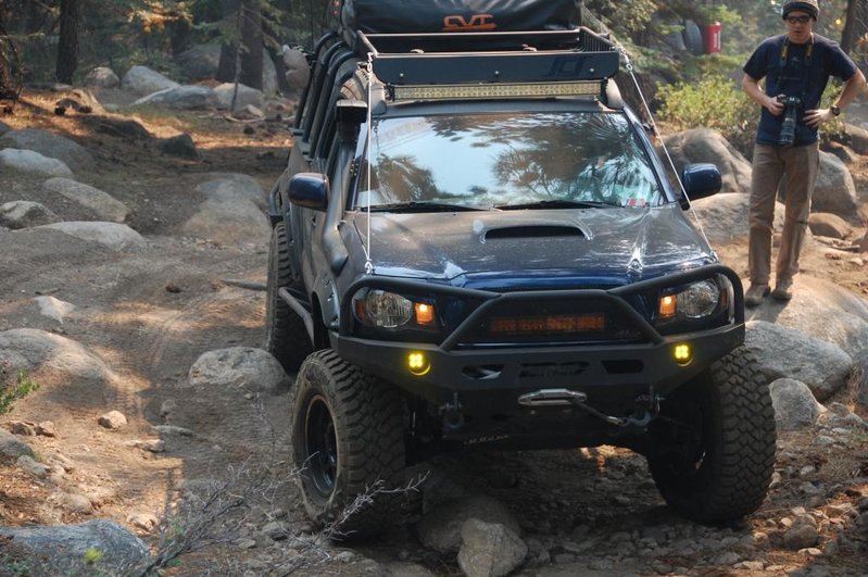

    This is straight sexy, make yours like this :drool::drool::drool:

    Sweet setup man. Your suspension setup is kinda what I've been thinking of when I get to that point. :cheers:

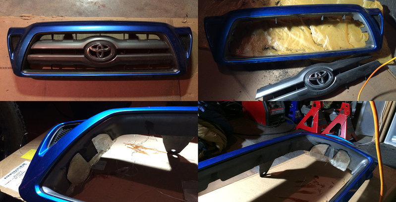

    Since upgrading to the honeycomb grille this one had been collecting dust. Had a few hours to spare so I set off on satoshi project. First layer of glass was messy, need to do another pass in the morning.

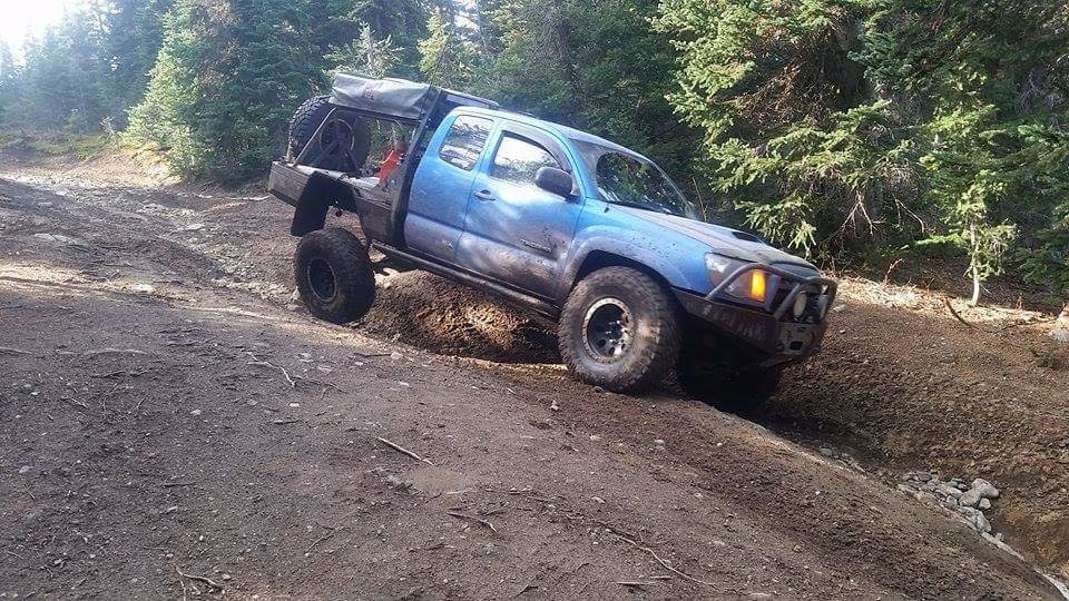

    35s and speedway blue best combo ever

    Hell yeah, looks great!
