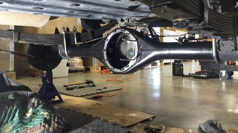

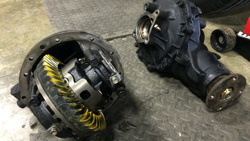

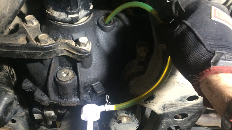

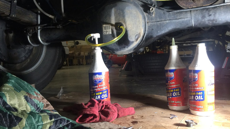

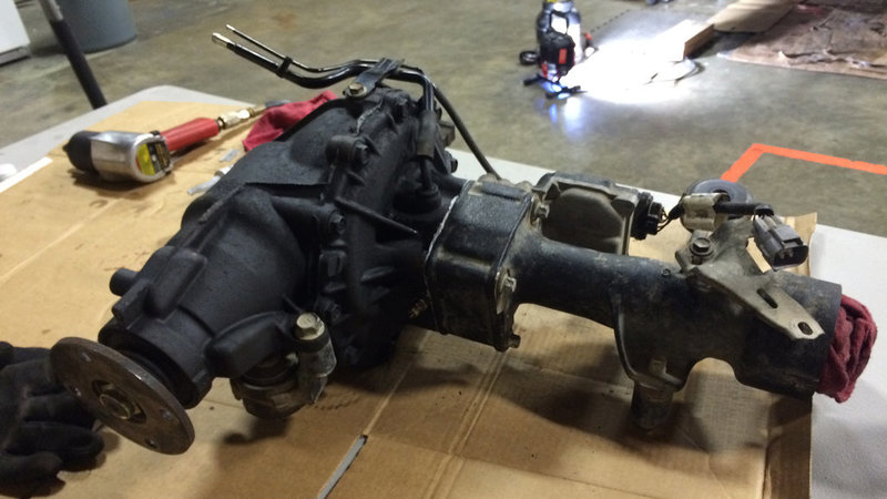

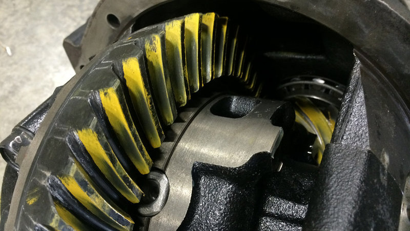

    Build update: Gears went in over the weekend.
    Overall things went smooth, especially given the fact I had just went under the knife and had a back full of stitches. The only slowdowns were scraping the 3rd gasket off, dealing with the darn breathers on the clamshell, and underestimating how long it takes to pump 85w-140 oil. Many thanks to @Greddy for tag teaming the front end and to @JDAM for the extra hand getting the new clamshell in place.

    Thanks man! Got most of everything done on Saturday but dipped into sunday to finish things up. Lost count of hours but glad to have put in the time. I have a much better idea of how everything works, especially the elocker which is way simpler than I had imagined.
    Hell yeah bro, was a kickass weekend. 420 more miles till they're broken in and then back to pumpin :jerkoff:

    Nice! That front diff was a pain in the ass. It was nice having an extra set of hands available.

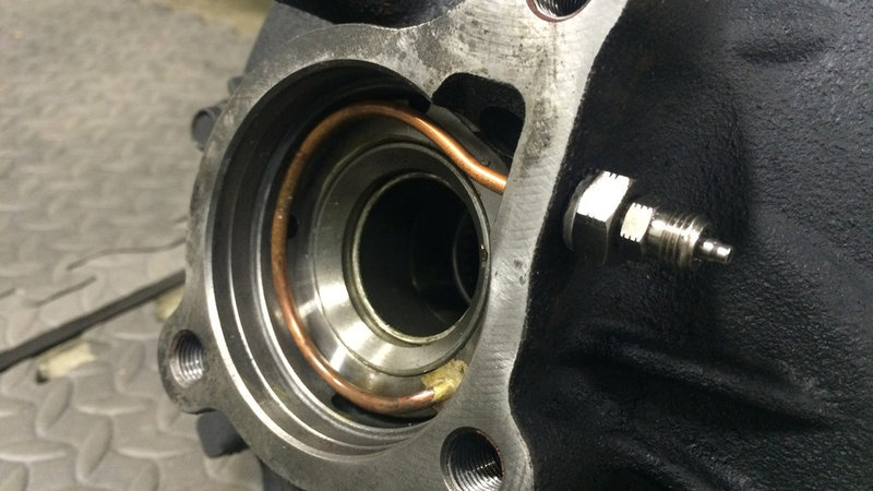

    Thanks Nick, I wouldnt have thought of using one of those, that's a great idea! After 110k miles the paper gasket was literally petrified to the housing, if only it came off attached to the 3rd it would have been an easy scrape with the razer. Working between all the studs was a tedious process and I may have been a tad too ocd getting it perfect, but leaks suck so it was time well spent.
