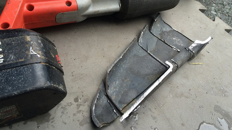

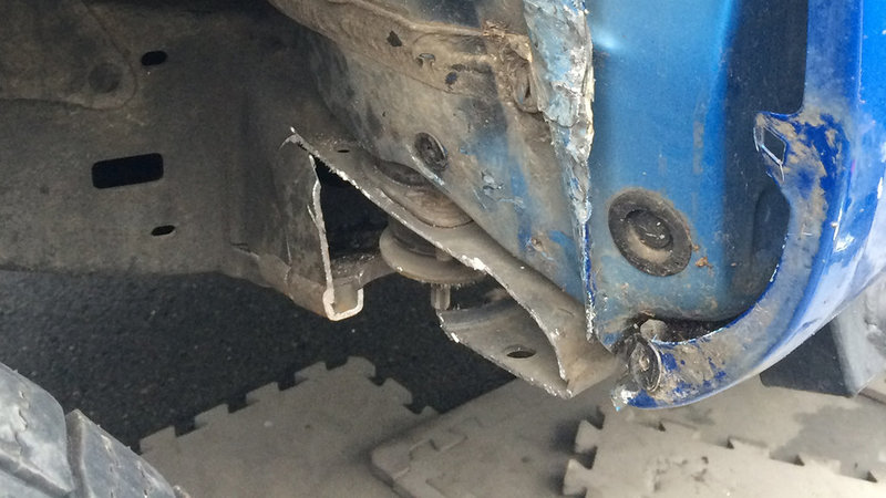

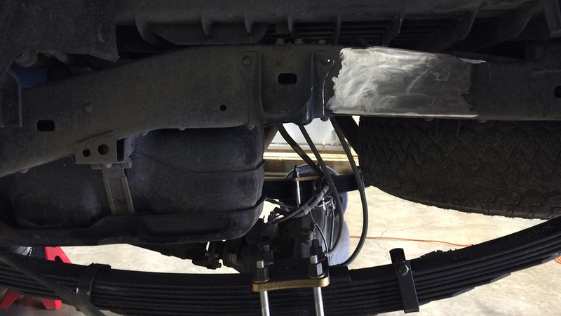

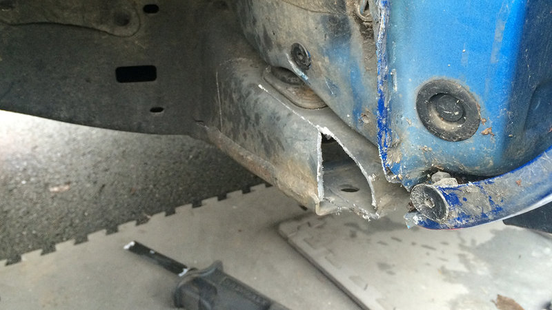

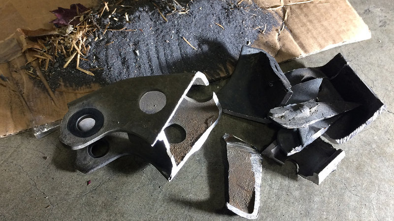

    Belated build update:
    Chassis prep for the bamf shock towers/mounts.
    Tip: use a sawzall to cut as much as you can on the first pass, then finish it off with the angle grinder.

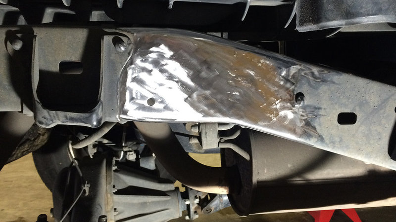

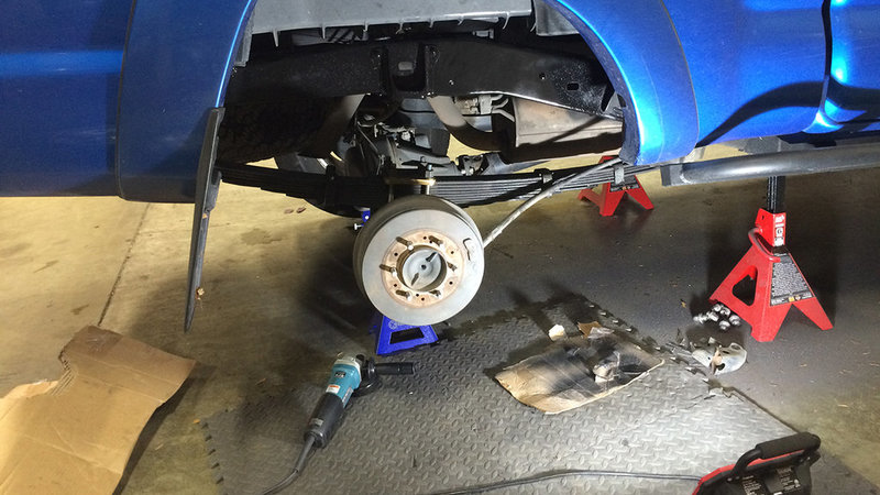

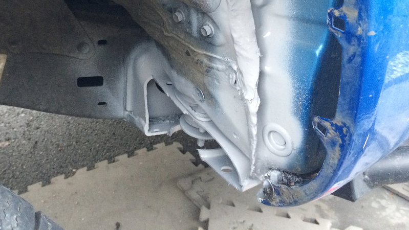

    Thankfully it stopped raining today so I got a little more prep work done on the CMC and pinch weld.
    It's not as clean as the passenger side but I'll fancy it up with the grinder on version 2.
    I also changed routes with the pinch weld and folded it outside vs inside like I did on the pass. Still have a ways to go but it's a start.
