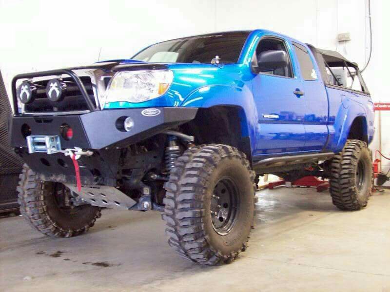

    DB lift and all poo bumper :puke: I was wondering how he got so much front lift

    I'd only go that high for a SAS. Crazy rig, I'm sure it does great in the mud.
