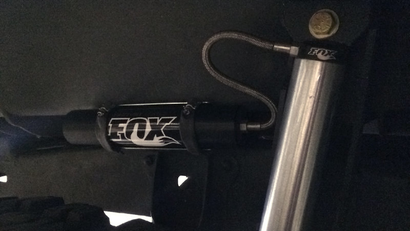

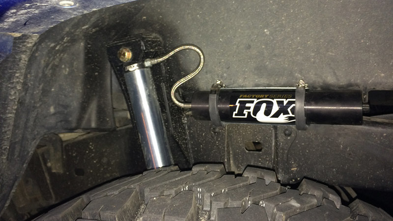

    Belated photos of the BAMF shock towers and 12" fox's. Used some shrink wrap over the hose clamps to clean up the look.

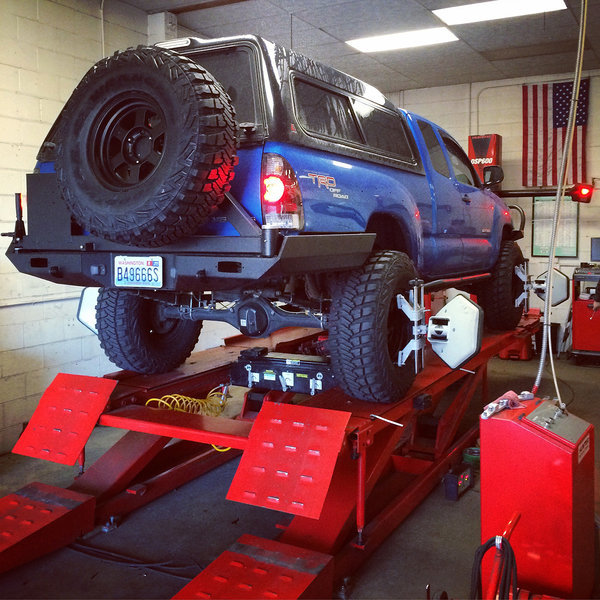

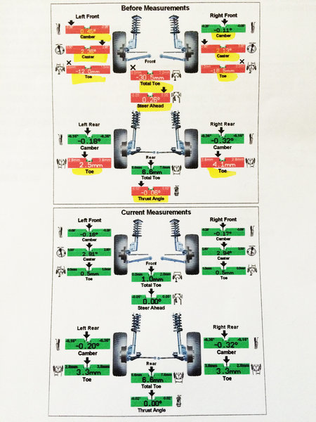

    I still have to crank up the front CO's but given my free time and the bad tire wear I decided to take her in for an alignment to hold me over.
    It's news to me that the rear toe could be changed... :notsure:

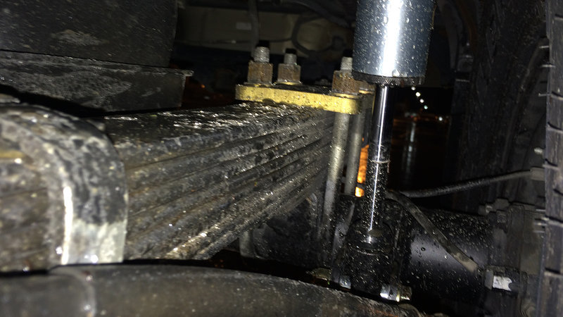

    I didnt think my Deavers were going to let that happen either until
    If I had dirty5s, id have no fenders left. That shackle flip is becoming one of my favorite low $ mods that had the most impact on performance.
    Still, before you get out on the trail and let the suspension find issues for you, I think you need to find a spot where you can flex and take a looksee.

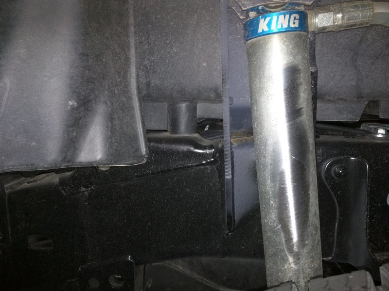

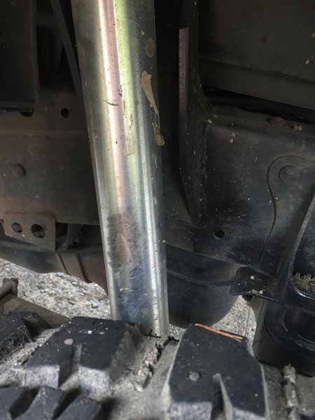

    Huh never heard of tire and high clearance problems.. Also get larger spacers on your rear ASAP so you don't rub the shock.. Mine do currently and hate it

    Its only a tiny polish at full stuff though
    Yours is more than you think.. That's a tall area that it's rubbing off, tire is at an angle at full stuff so the taller the area the more it's rubbing
