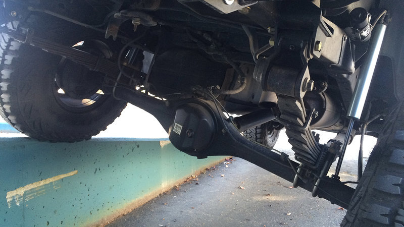

    It's a test in patience for sure, but soooooo worth it. How much longer do you have?
    My suspension is far away from being dialed so I can't say much. The front is a bit underweight to be running 700's so the ride is rough. Once the winch, skids, and rack go on it should smooth out quite a bit. The rear follows suit, the AP Expos are stout as hell. Weight wise I have the canopy, pelfrey hc rear, swingout, and a full size spare. Still, she bucks around back there, but unloaded that's to be expected. With camping gear I should fall within the proper weight range, if that's not enough a few extra water jugs would do the trick. Regarding rake, I'm a full on blue stink beetle. Decided to deal with it until all the extra weight is figured. Then it's time to fuss with preload, get another alignment, and finally tune the DSC's.

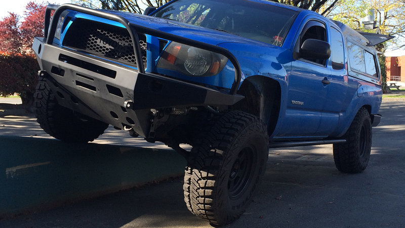

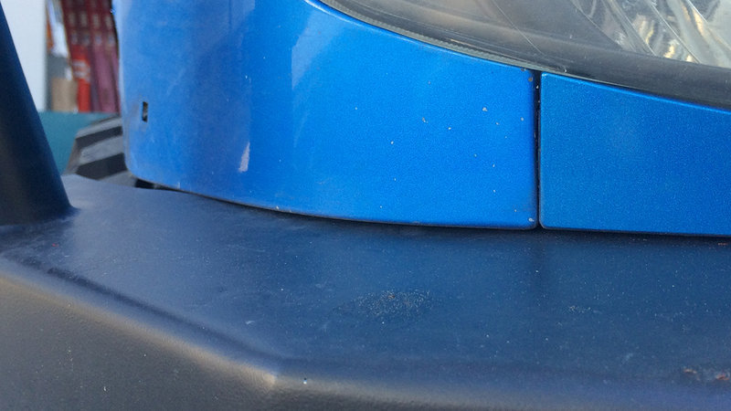

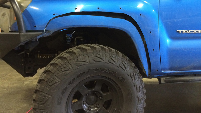

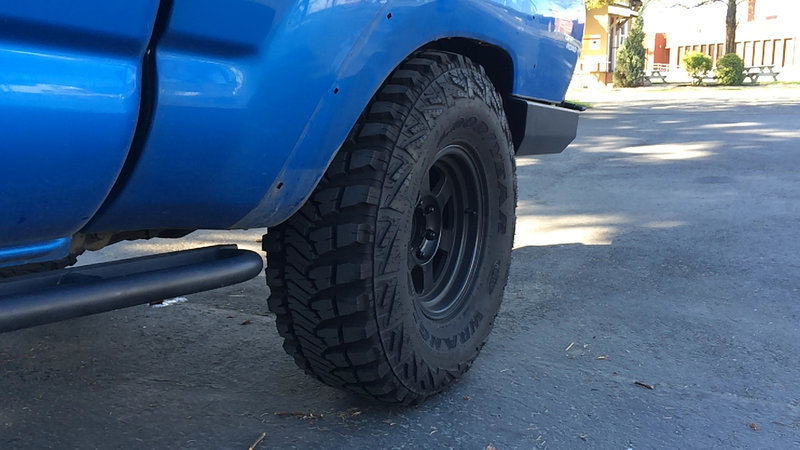

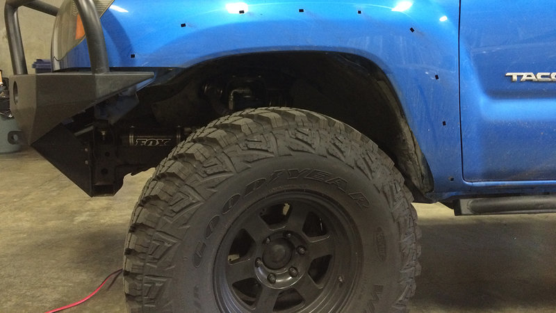

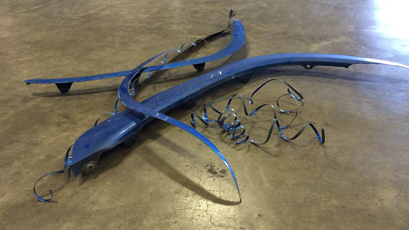

    Last weekend I finally decided to tackle the fenders.

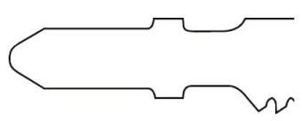

    With the advice of many folks a jigsaw was the right tool for the job. Figured I should probably own one so after a bit of research I opt for this Bosch 6.5amp with a pack of various blades.
    Then... I learned the hard way there's two styles of blades.:facepalm:
    I was already at the shop, a few beers into work mode, and a tad peeved that I had the wrong blades so I tossed my hands in the air and grabbed the nibbler.
    Then decided to freehand my troubles away...
    The line sucks but that's what I get for being impatient, it'll be hidden away under the 'carefully' cut flares anyway.

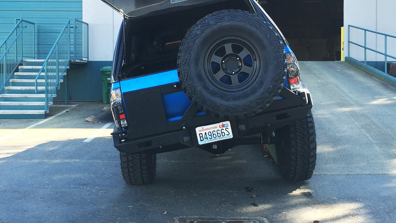

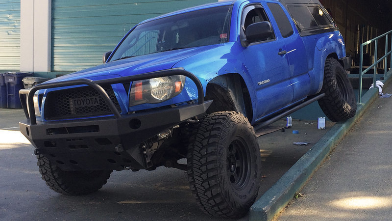

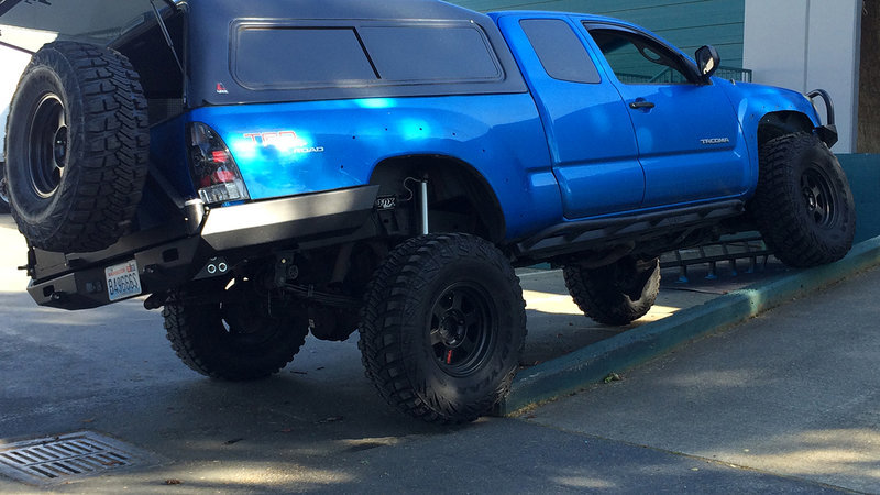

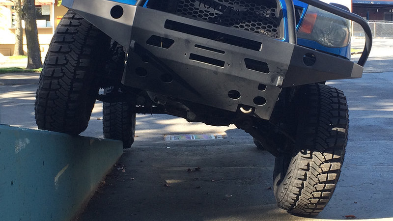

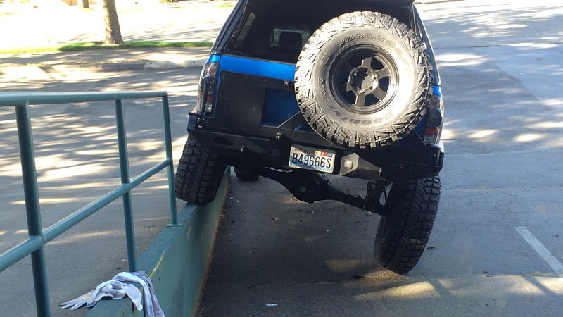

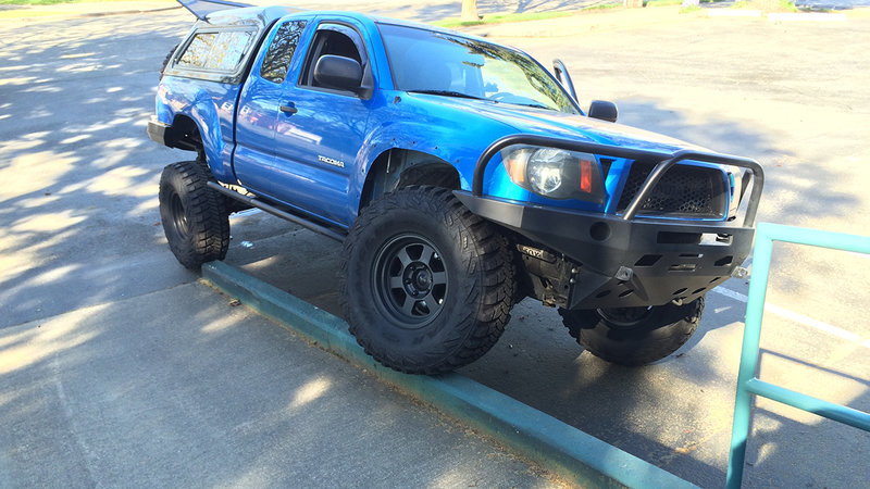

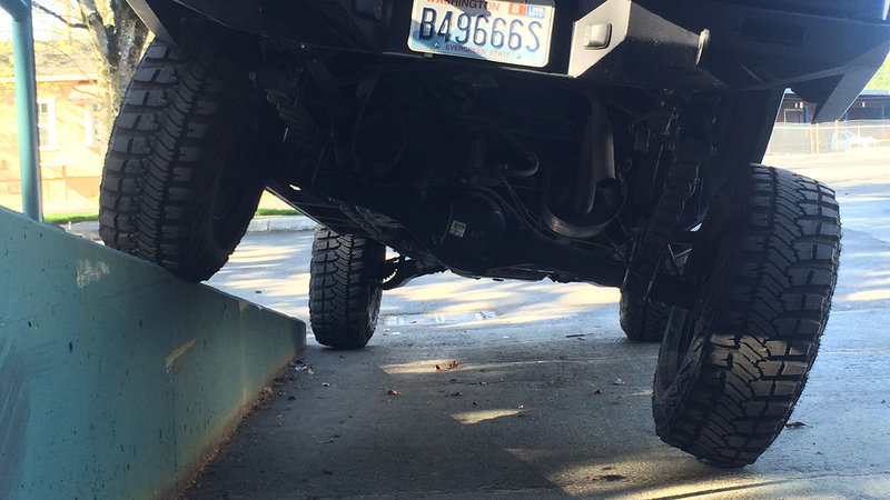

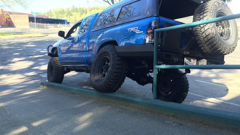

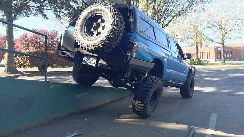

    With fenders cut it was time to graduate from mall crawling to loading dock crawling.
    This was a dry run without any weight in the bed. Need to pack it with gear and test again to get the bumps sorted.
    :turtleride:

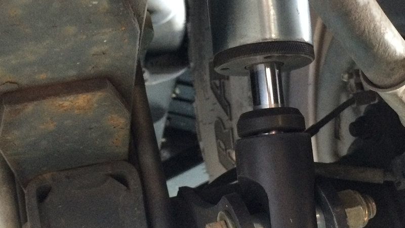

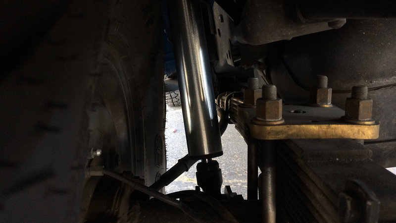

    How bad did it scrub the shock body at stuff? Or do you have spacers?
  16. Apr 12, 2016 at 9:03 AM
    #636
    TacoSTIG
    TacoSTIG [OP] Untamed Member
    Jun 22, 2014
    #132473
    1,140
    Jeremy
    WA, Issaquah
    2005 AC, TRD OR
    No scrubbing on 3/4" spacers and had about just that much clearance at stuff. Aired down ill be close, should probably test that too. Also need to pound another 1/2" or so outta the firewall to get closer to full lock at stuff.
