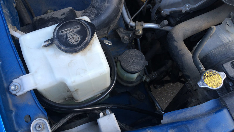

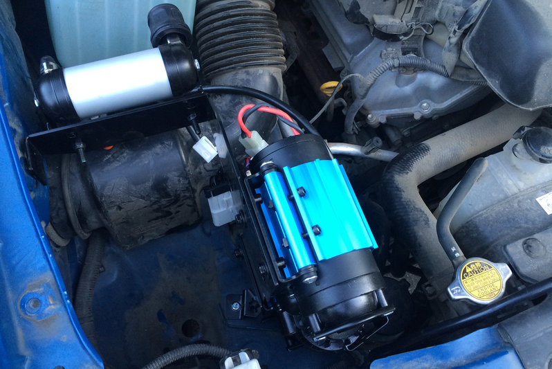

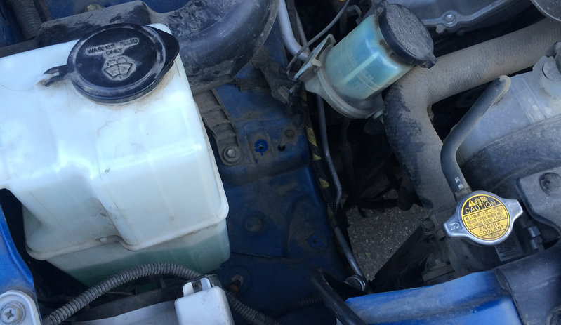

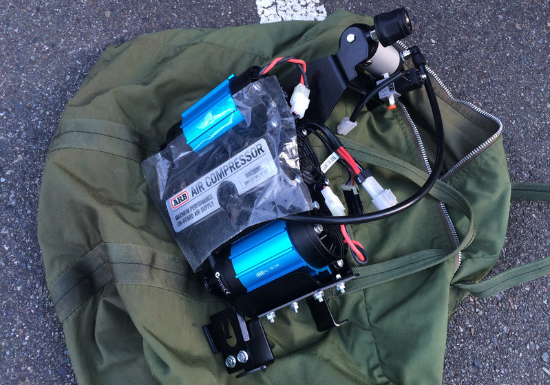

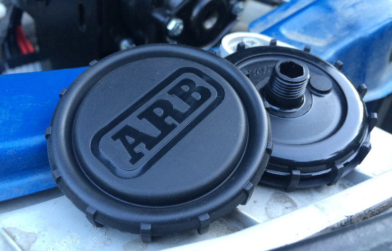

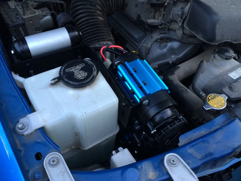

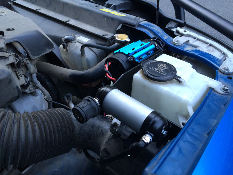

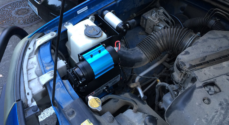

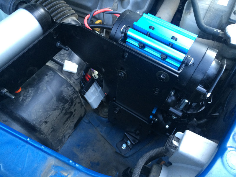

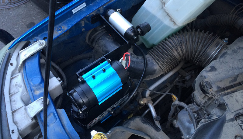

    I need front ballast and I need it bad. So, to kill a few birds with one stone it was time to mount up this fancy lookin contraption.
    Time to make better use of this space.
    GTFO power steering reservoir.
    Twenty minutes later... cramped hands and crushed fingers finally inched the two hidden bolts down.
    As pointed out by @Nate87 these compressors put off some intense heat so the plastic line between the locker manifold may not cut it for the long run. I'll be upgrading to braided once I put it through it's paces and make sure I'm happy with the location etc. This is only the beginning of a very weird, overly complicated, and rather goofy oba project.
    Next up, wiring.

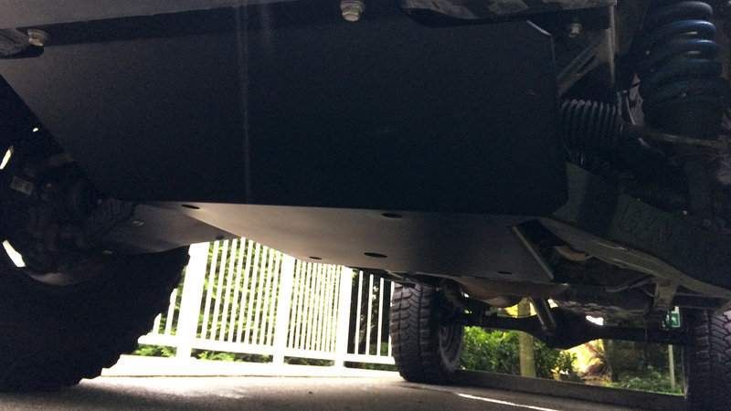

    Was planning on getting the ifs skid on tonight but I'm seriously getting peeved at trying to get work done in the rain. So, been working on the CB a bit.

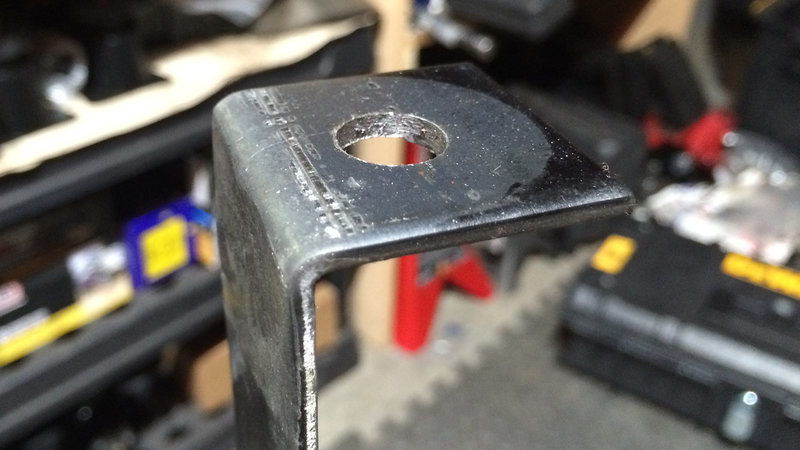

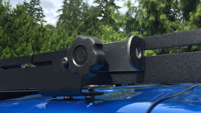

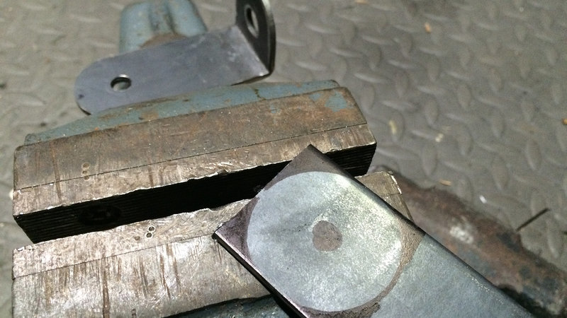

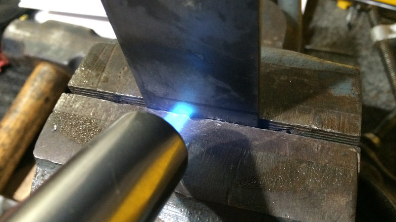

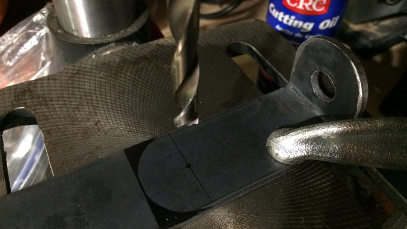

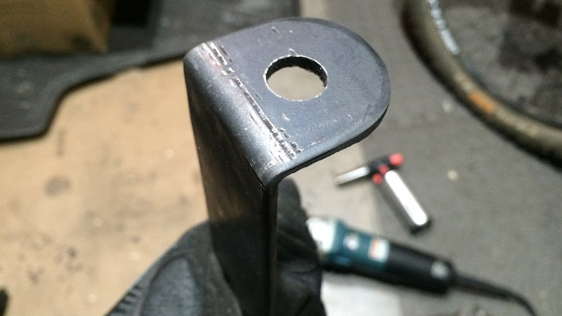

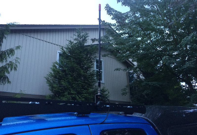

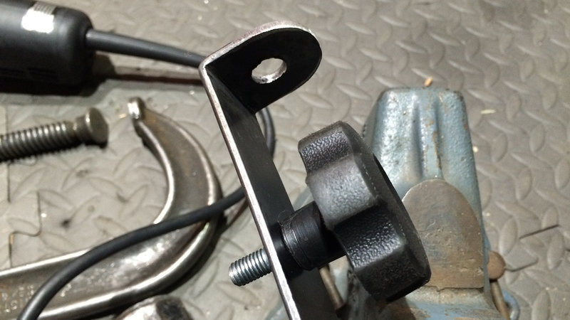

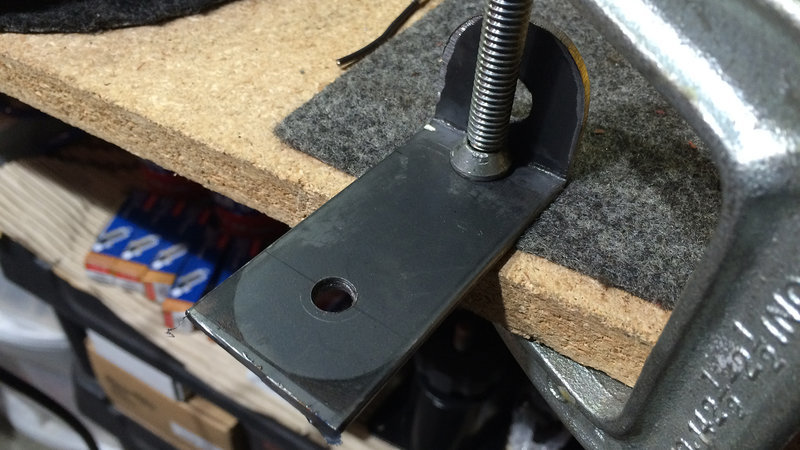

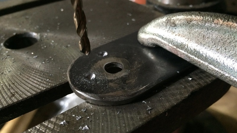

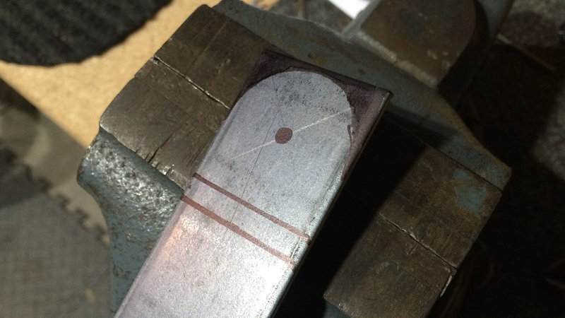

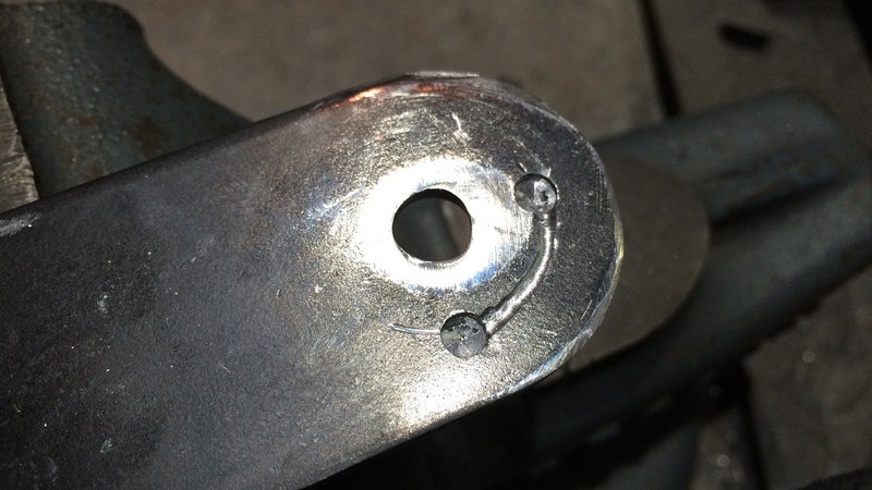

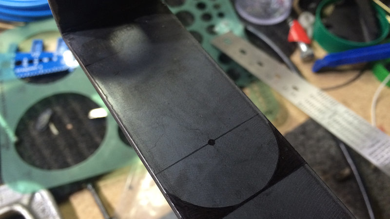

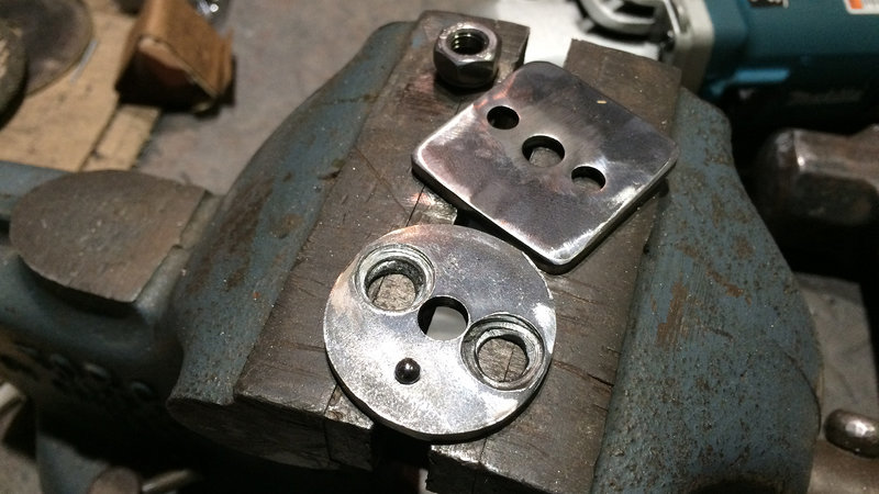

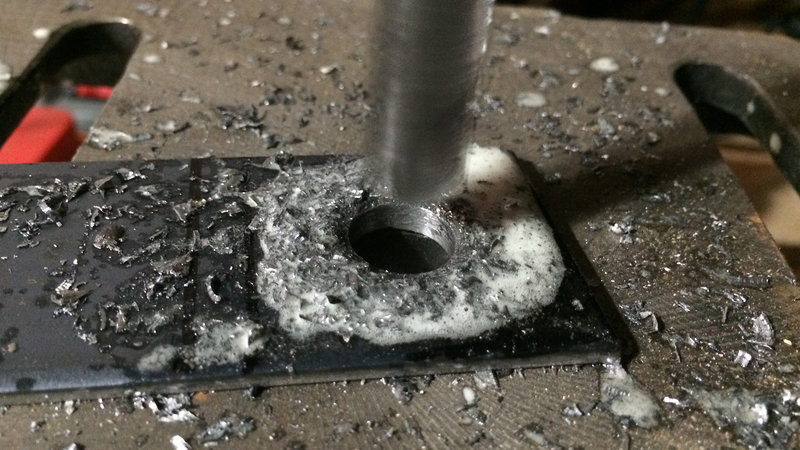

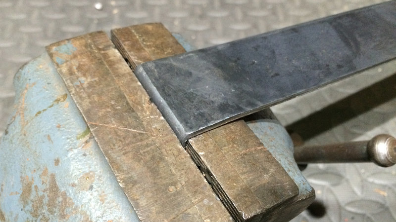

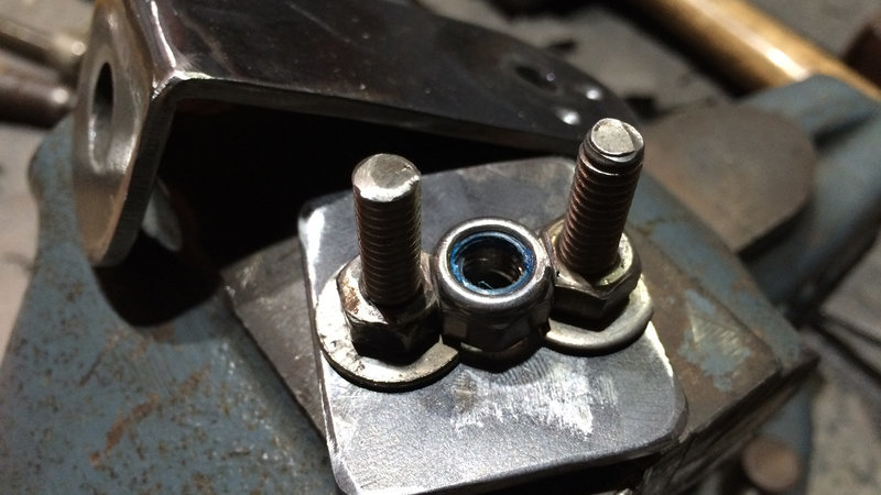

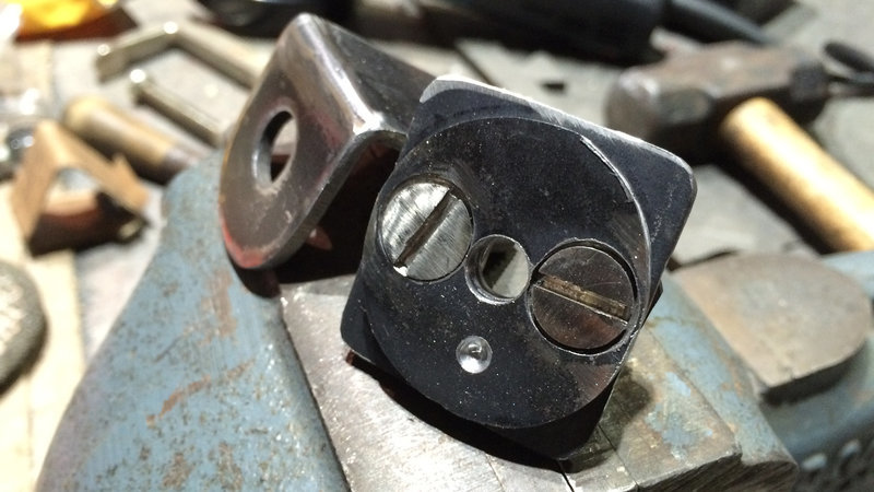

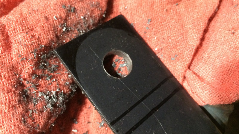

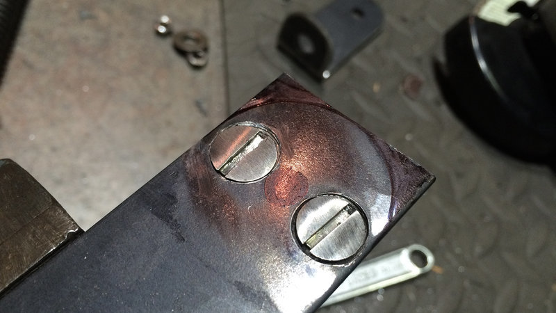

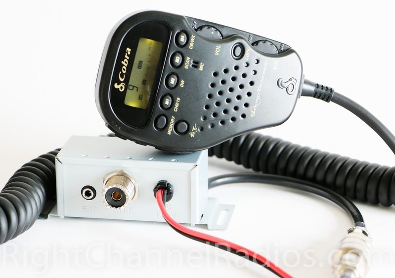

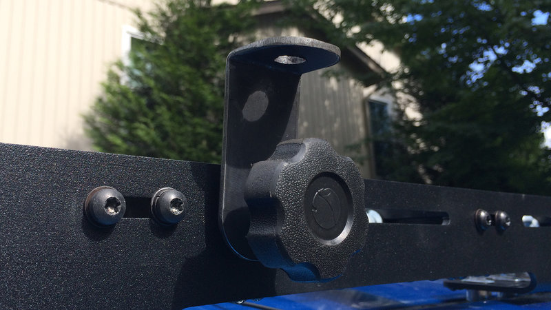

    I needed a CB mount and nothing on the market sparked my interest. So, I spent $6 on some steel bar, robbed my office chair of a foot rest adjustment knob, and got to work.

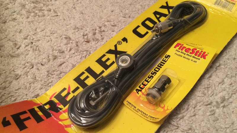

    To keep the antenna from bouncing around in the down position I purchased a few of these, still waiting for them to come in for testing.
    Next up:
    -Final touches to the mount, paint/polish.
    -Finalize Coax cable routing.
    -Grounding... strap from mount to roof? maybe try using a rack mount bolt?
    -And, finally figure out where I want to put this puppy.

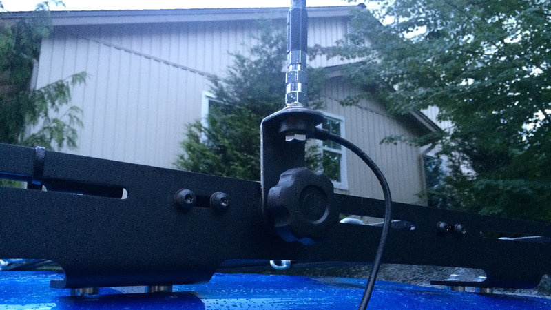

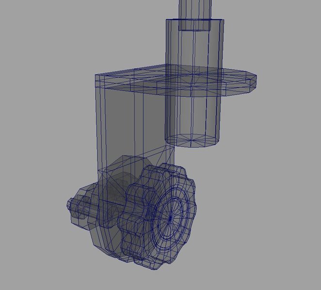

    Thanks Brian, there are actually a few out there that let you swivel the antenna but each one posed a different issue.
    Most of them are built like the comet below, I needed the antenna and the knob to be on the same side to clear the rack.
    Even if I flipped the bracket on the Comet it wouldn't allow a 90 degree rotation.
    So, I took the comet idea into Maya, simplified the design, then ran with it.
