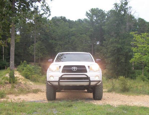

    Whatd you use to paint your badging? and whered you get your color matched grille?

    Krylon Fusion Plastic Bonding paint on the badges. You should be able to find it at Home Depot, Lowes, or Walmart.
    And check this thread for the grille. http://www.tacomaworld.com/forum/bu...ed-oem-grilles-175-shipped-brand-new-box.html
    I think they cost like $185 now, but still the cheapest grille + shipping.

    I was actually looking for a build with 295s and a 3" lift and your truck is similar to mine.
    I have the same wheels and a 3" lift but with aftermarket control arms
    Im not afraid to do any chopping but im just nervous about rubbing in general
    Do you happen to have the center of wheel hub to bottom of fender measurement?
    Thanks for any info!

    Also do you have any straight on pics? Im interested to see how far the tires stick out

    Well you'll definitely have the typical plastic rubbing. The thing about the aftermarket control arms and the reason I have held off on getting them is because in a way they're going to increase the amount of travel that your wheels can turn. Mine without that extra turning radius will just barely rub the cab mount when backing up in reverse up/down an incline with the wheels almost completely turned one way or the other. I don't do any extreme off roading in this truck, but I'm sure if I was completely flexed out that I would rub more. So with your aftermarket uca's, you will probably rub a little sooner than I do when doing the same thing. I have no idea how much worse it would be. But I can say that the times I rub compared to the overall amount of time I'm using the truck is probably 5% or less of my driving. It rarely happens, so it doesn't bother me enough to go get my cab mount chopped. I can't really say how much worse yours would be, but I believe that you'd have enough ability to turn to be able to drive home after you get your 295's put on, take the truck somewhere to get the cab mount chopped, whatever trimming you may want to do, etc. With the exception of having to at least cut out some of the inner fender plastic, you could probably do most all of your daily driving. And if you don't wheel this truck, then you may find that it's not an issue and that you don't want/need to chop the cab mount.
    I don't have any measurements on hand, but I'll try to remember to do that tomorrow.
    I do have that. I like the 295's, and the Hankooks have been great tires all around. I'd recommend them to anybody looking for an MT that also behaves well on the road. Plus they have the biggest 295 on the market that I could find: 33.6x11.6. They're almost as tall as some 315's. And they have even been mistaken for 35's a few times, which is cool :cool:. I like them, but I'm kind of thinking about getting 305/70/16 Duratracs next time because they're a little wider, look good, last a while, and are a little cheaper. It will depend on how this set plays out.
