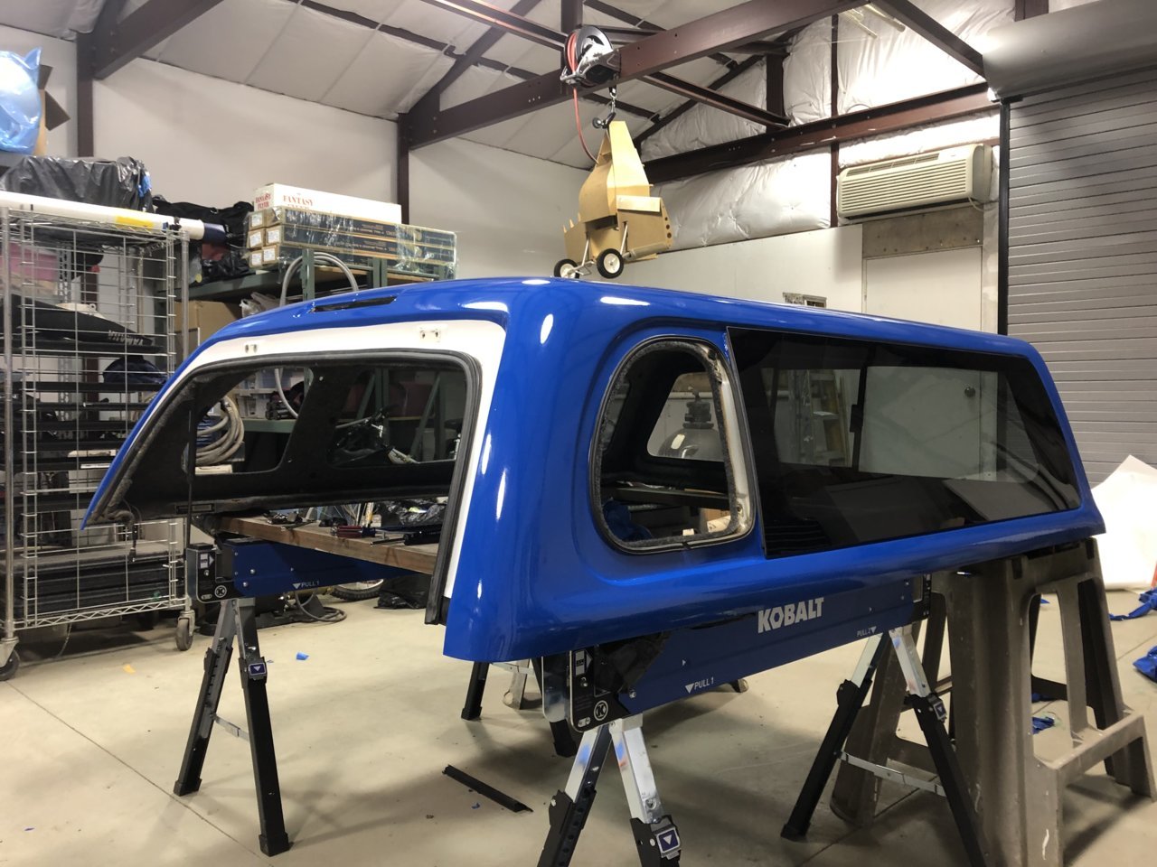

    By far, the hardest piece of this whole shit show. But luckily I messaged a wrap shop on Instagram and they gave a tip how to stretch it around that curve to the back of the camper and sure enough, we knocked it out no problems.
    Just have to do the overlay at the back window area and put it back together and we’re dunzo

    When you get to that curve and you start getting fingers (wrinkles), you’re supposed to lift up the wrap past the point of the fingers, heat gun, and then stretch it as far as you can and smooth it out. When you hit fingers again, lift just slightly past them and heat gun again. And repeat. Also the key is to have like a foot minimum of excess so all of the wrinkles have somewhere to go past where you finish on the piece you’re working.

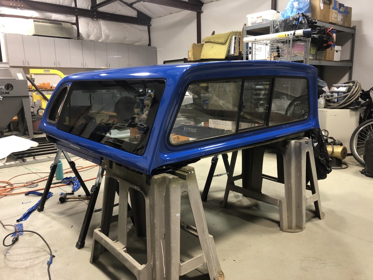

    Now, finally after a week we started on the camper. Hands down, the WORST piece of this entire project right next to the cab.
    Front piece/ window got the inlay, and then both sides would meet in the middle, wrap around the front and overlay the existing piece.
    Almost done! Standby for finished product Before/After.

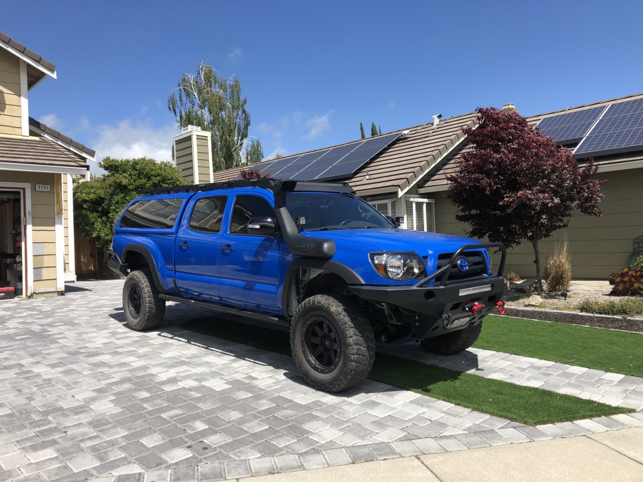

    Camper is on, truck is fully put back together and it’s sunny out :D

    Turned out awesome ! Looks great, kudos for tackling it on your own !

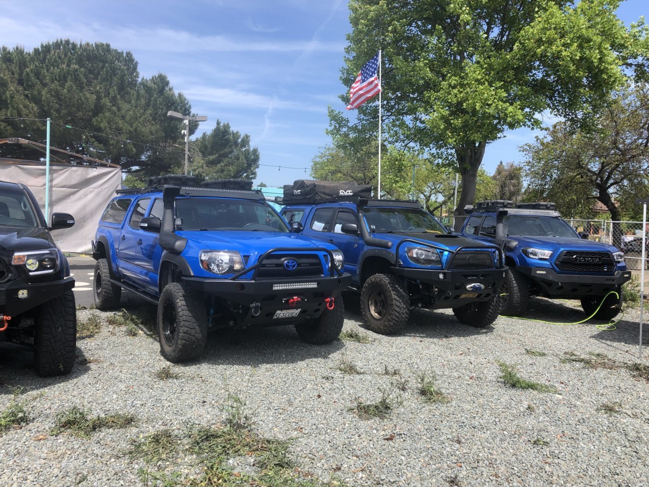

    Posted up at Basecamp!

    The longbed club is only dreamed of by most of these guys, can’t be beat !

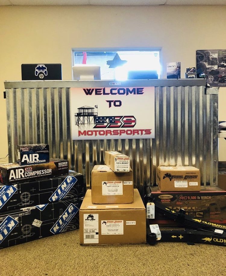

    Well, Total Chaos was on the ball with this order. Just waiting on my set of Kings to come in! Hopefully they’re here by my install window next Monday :annoyed:6B708033-7480-47A5-B11A-3CCEE92A6C96.jpg
