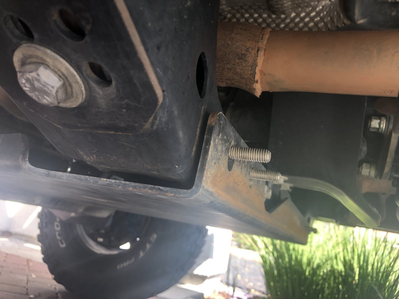

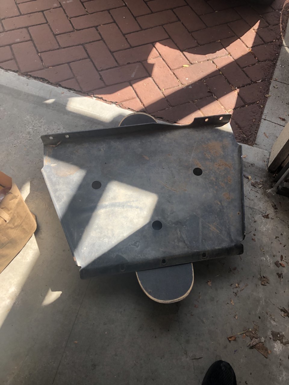

    Not sure the thickness of RCI but BAMF 1/4" is a bone breaker if dropped on faces.

    The 4 cross member bolts I just hammer back to the point where I can rest the skid up against the crossmember and then hammer them back into place so the skid sits on em. Maybe BAMF is different.

    Pretty sure RCI is the same. Thankfully my head was like an inch from it at the time. Still gave me a ringing headache.

    My mid skid and tcase skid bolt up through the stock crossmember. When I pull out the stock bolts to line skids up and put bigger bolts back through my crossmember drops a bit getting the holes out of allignment, atleast it is only one side, the other side stays in place

    Pelfreyshit is 3/16, 1/4” is Hulk strength

    Wow that sounds like a horrible procedure

    I just got to get use to it and figure out the tricks of the trade ... I am going to see if I can run my bolts like yours .. .. mine face the other way ... maybe I'm an idiot and put them in backwards? sure hope so .. if so I could just hammer them like you and wouldn't need to pull them all the way out when removing skids . .. TBD this weekend.

    So I know when I installed my skids, the OEM bolts were facing towards the front and instructions for the skids said to pull one at a time and replace it with the supplied bolts and put them the opposite way if you have both rear skids. Worth a shot my man :thumbsup:

    Yeah I put them back in the way they came out. BAMF has no instructions :bananadead:
    Hopefully that's the case and I can tackle that this weekend with my homey.
