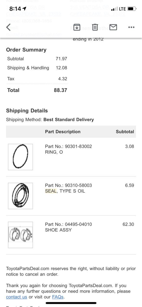

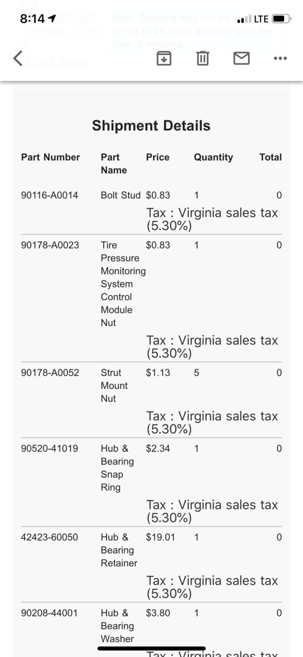

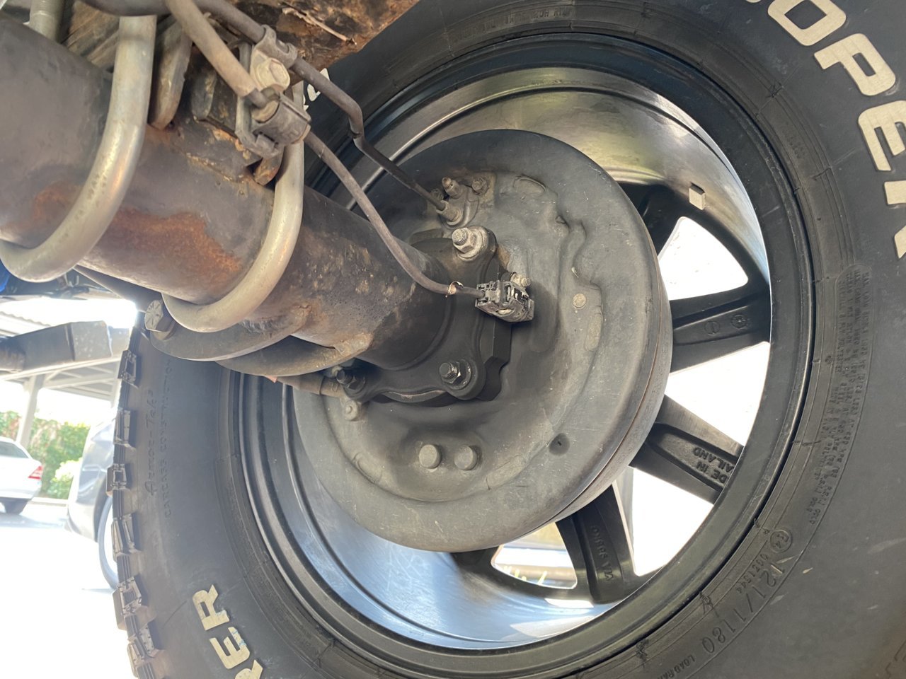

    Fuckin’ BALLS
  6. Sep 3, 2020 at 4:29 PM
    #566
    EatSleepTacos
    Mar 24, 2015
    #151688
    59,841
    Randy
    West Valley, AZ
    2017 4Runner
    I just had this happen to me. One thing I learned was that once the gear oil gets into the wheel bearing, it washes out all the grease. So you’ll need to replace your wheel bearing too. It was about $400 for oem parts from mcgeorge Toyota and I took my axle (off the truck) to a shop to have them press on the new one for like $80. Then new brake shoes. That was only one side.

    $400 for new seal and bearing? I wonder if my drum has oil in it yet since it’s only seeping for now.

    West Valley, AZ
    2017 4Runner
    That was just for the bearing and associated parts, like new studs and nuts and whatnot. It’s silly expensive. The seal was pretty inexpensive at only $7.

    971
    Bay Area, CA
    2008 DCLB
    Faaaaawk. Did you find a parts list needed somewhere? Did you do both sides since one side failed or just sent it?

    #151688
    59,841
    Randy
    West Valley, AZ
    2017 4Runner
    This is everything I bought. I only did one side.
