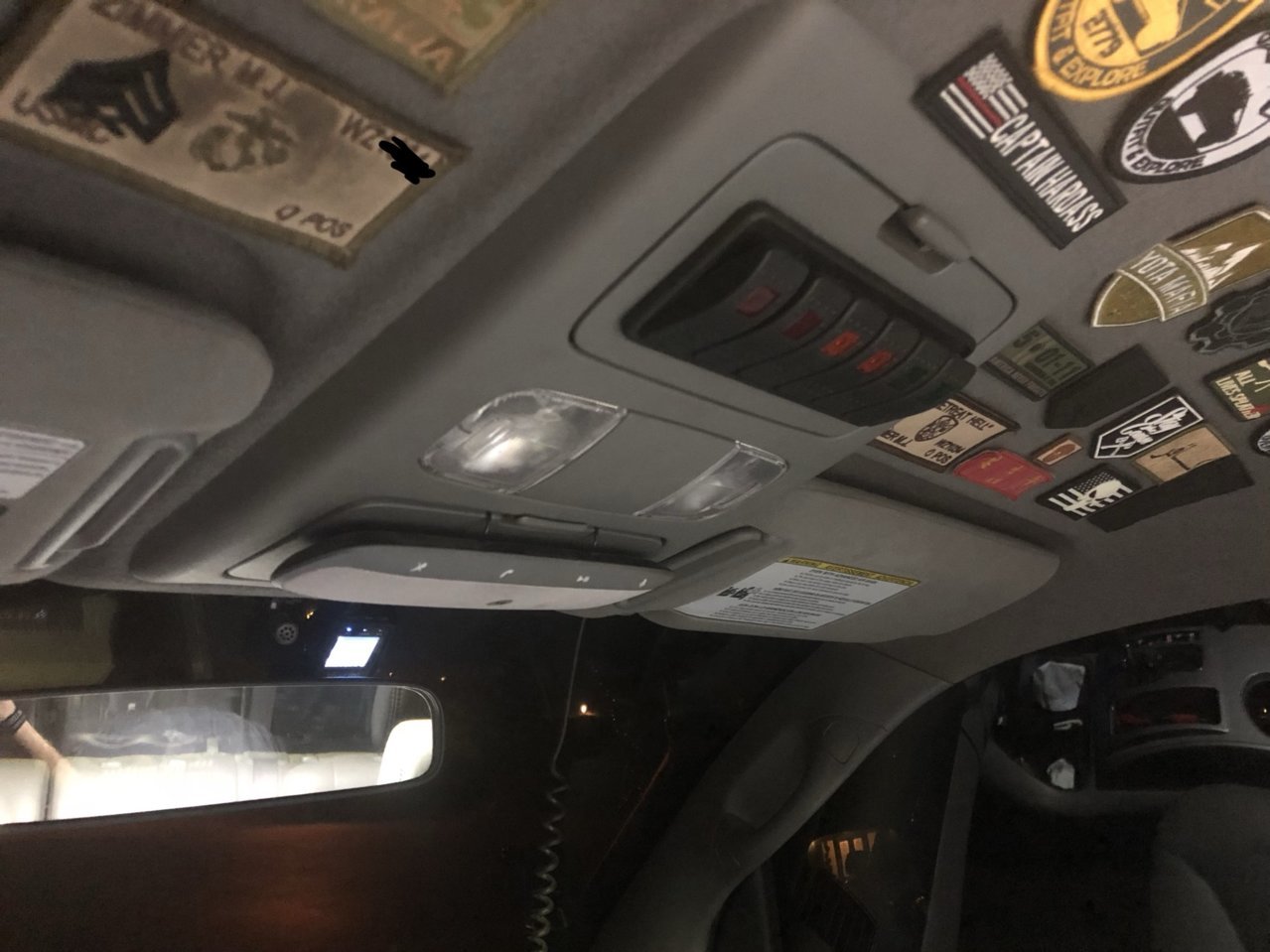

    @Big Brutus Behold, mission control. Gonna be adding in cab winch controls and separate switches for left/right alley lights here soon and then have the rock lights in the alley light switch spot.

    Diggin the Spod in the sun glasses holder, i had planned to do the same thing but its just not enough. Still more planning to do for me to figure out where i want to move stuff. (relocate fog light swith)
    I see you dont have the VSC and "turn off my roll sensing airbag" switch, gives you two more slots on the lower left.
    Moar switches.

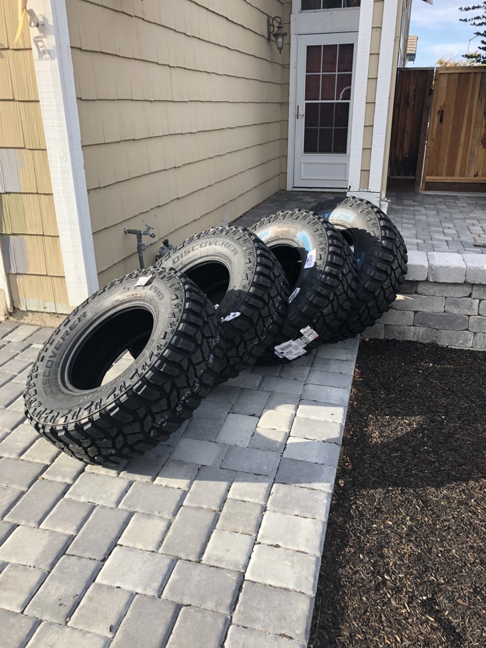

    UPS dropped off some things today. Probably gonna ride out my 33’s for a couple more months til putting these on. What you think? Or should I post em up to sell?

    Normally I'd say swap'em but if your current tires still have life I'd probably ride'em a little longer. :cheers:

    Fuck that, mount those bitches and sell your 33s!

    forsure would want the new new on the truck asap.
    are the old ones worth selling? If they got decent tread left, sell em!
    if theyre almost dead... well sell them for less and slap them three fives on there!

    So I just did a tread check and I think I only checked one of the tires last time that made me think I was coming up for new tires somewhat soon. Didn’t realize that the one I check was the most worn down lol.. so the brand new spare is 19/32. The one I checked was roughly 7.5/32. Two of them are 9/32 and the last one is 9.5/32. So roughly 45% all around besides the brand new spare.

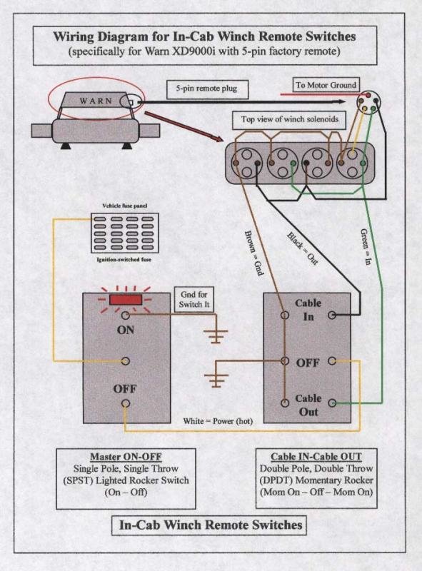

    Has anyone wired a Warn winch to have in-cab switches? Trying to figure out their 5-pin connector and which wires to tap into? I figured out green is IN, but the other 4 wires I have yet to experiment yet. I'm thinking that if I find the pos wire to activate the switch and then the IN/OUT wire, I can route the 3 into the cab to my switches and run the pos wire to the ON/OFF switch and then that outgoing pos wire to the momentary switch to activate the IN?OUT function.

    This looks helpful.

    I think my Zeon is a little different. Black is definitely the ground. Red is attached to Pos pole on the solenoid, yet I've read some layouts where the white or yellow was a controller pos wire or some shit?
    But does my idea of wiring besides not knowing the two other needed colors, make sense and will work? I dont have the switches to test just yet so I can't really check. I'm planning on using three splices on the 3 wires that run in between the solenoid and the hard-wire winch controller plug in and then running those into the cab to the switches. Not sure if thats how this shit works, but gonna give it the old college try
