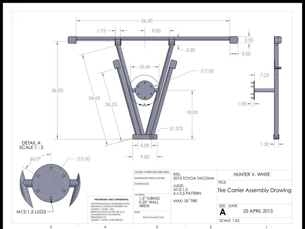

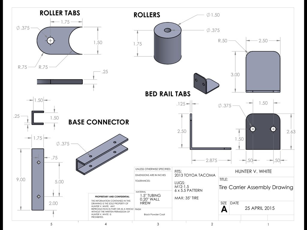

  6. Apr 25, 2015 at 10:42 PM
    #66
    Hunter.V.White
    Hunter.V.White [OP] Well-Known Member
    Jun 1, 2010
    #38199
    583
    Hunter
    Fairbanks, AK
    2013 DC 4WD TRD-Off Road
    Pelfreybilt Steel Armor, Famous Fabrication Sliders, OME 3" Lift, 886x coils, Dakar Leaf Packs, TC UCA's, Fuel D551 Wheels, 285/70/R17 Toyo Tech RTs, Warn Zeon 10s Winch, Rigid Industries 20" E2 Flood, RI 20" SR Spot/flood, RI Duallys, SwitchPro SP8100, Uniden Bearcat 680 CB Radio.
    Just designed this spare tire carrier :)
    Tire Carrier Assembly Drawing.PDF
    ready6delta likes this.

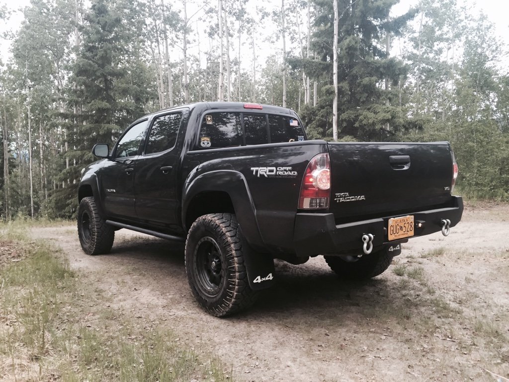

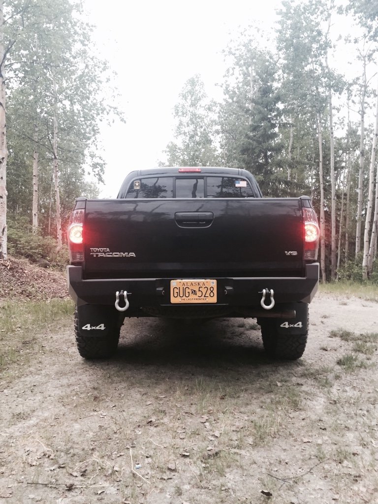

  16. Jun 3, 2015 at 6:43 PM
    #76
    Hunter.V.White
    Jun 1, 2010
    #38199
    583
    Hunter
    Fairbanks, AK
    Pelfreybilt bumper installed!
  17. Jun 3, 2015 at 6:47 PM
    #77
    Acerwin
    Acerwin The unNORM NORM
    Nov 20, 2014
    #142732
    32,623
    Andrew
    South Carolina
    Toyota Tundra
    Looks great buddy! How do you like it?
  18. Jun 3, 2015 at 6:50 PM
    #78
    Hunter.V.White
    Jun 1, 2010
    #38199
    583
    Hunter
    Fairbanks, AK
    I really like it. It is stout as hell and really cleans up the lines underneath. There is a lot more clearance than the OEM bumper. It looks great too.
