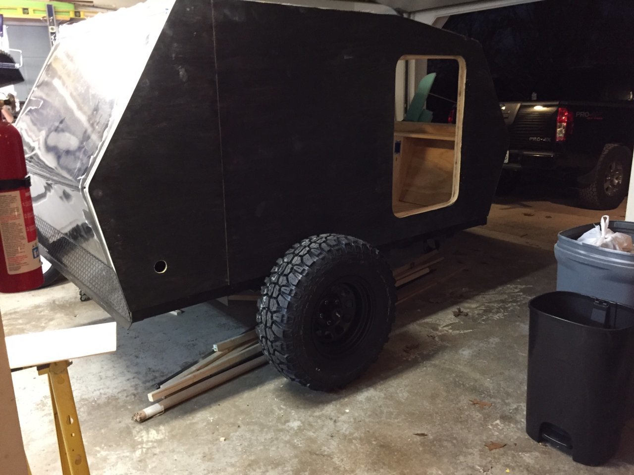

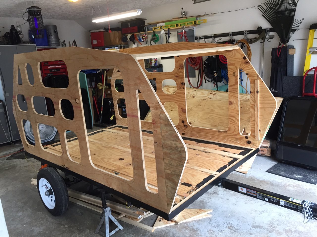

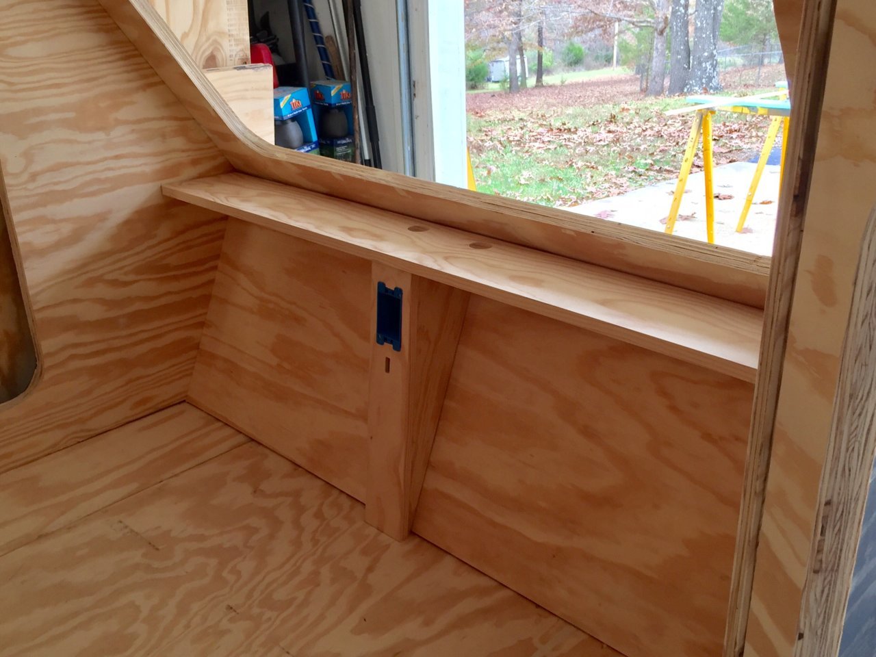

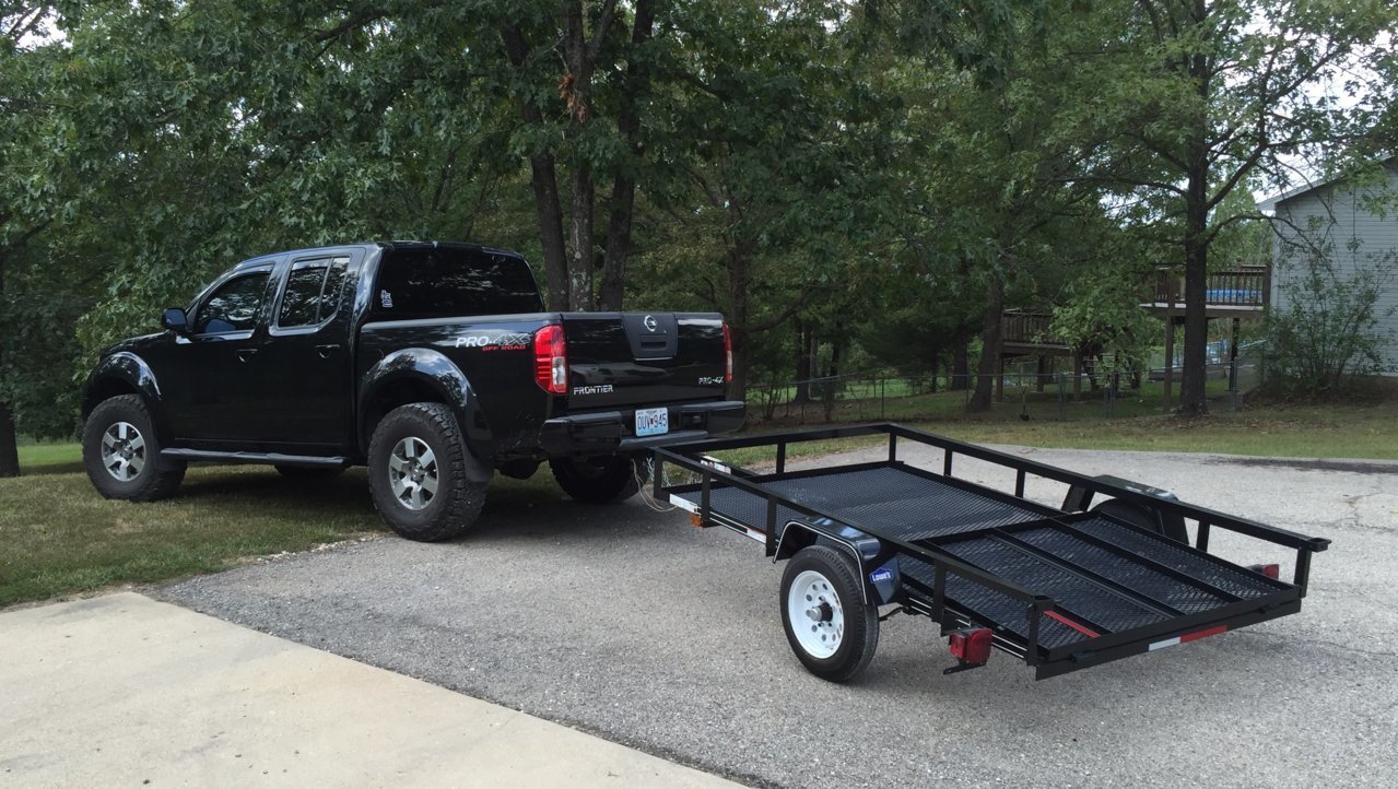

    B5CD1177-3774-412A-A88A-CA616C97DE7B.jpg Hi. So my girlfriend and I go camping a couple times a year and we’re over the whole sleeping on the ground or in a tent so naturally a little camper seemed to fit the bill. We mostly go to state park campgrounds that have shower and bathroom facilities so we didn’t need a camper with that. We also don’t have much room to store it. I’d seen a few “teardrops” around and when I researched them it seemed like most of them were home built. Not being the type to just go buy a factory built model I decided it’d be fun to fab my own.

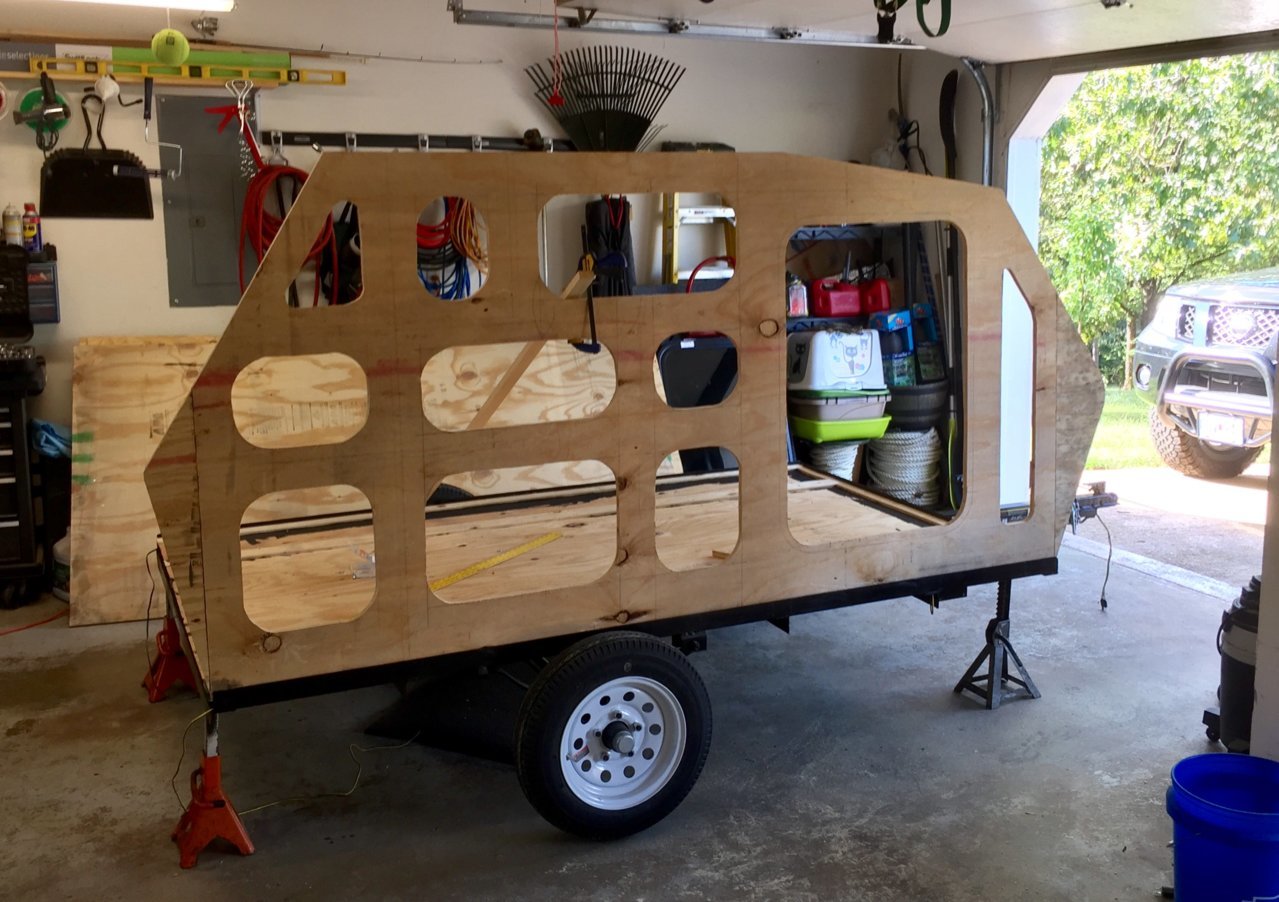

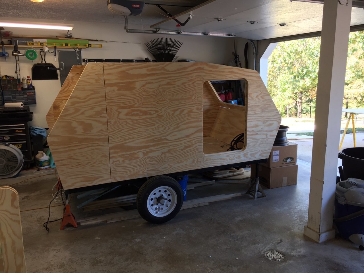

    B403F559-423A-49B2-9012-B40C793C4128.jpg CB1D761A-0733-4FCC-A5D9-18B384154753.jpg

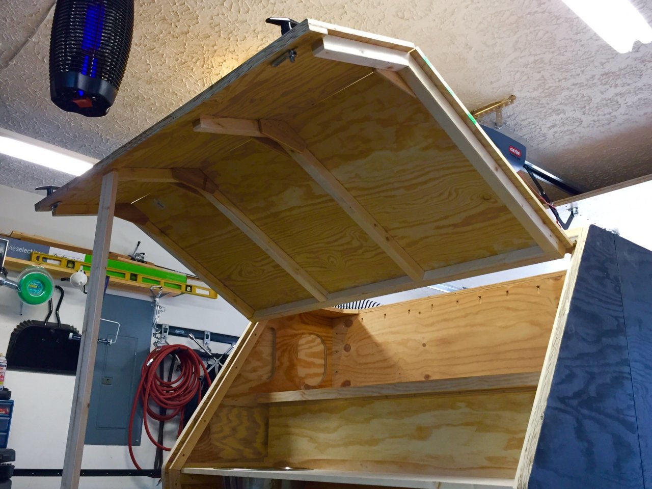

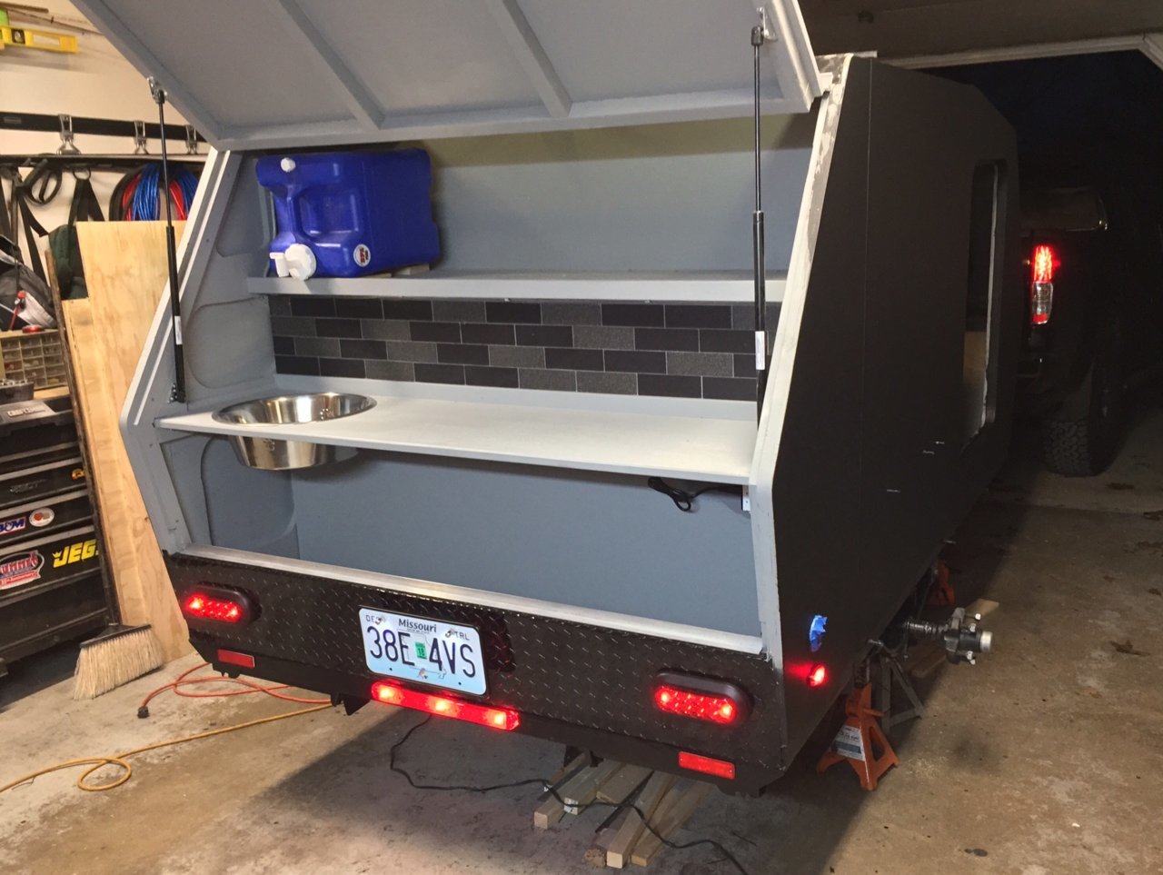

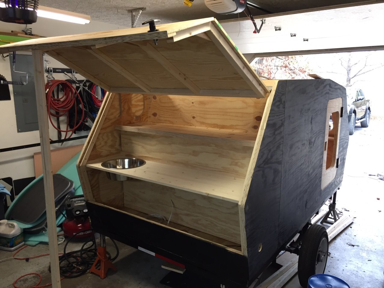

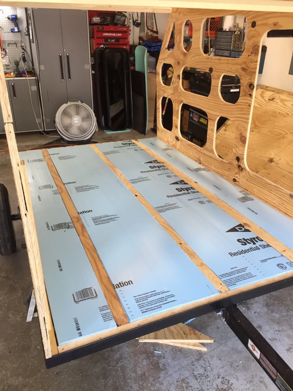

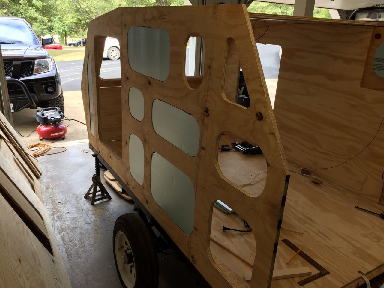

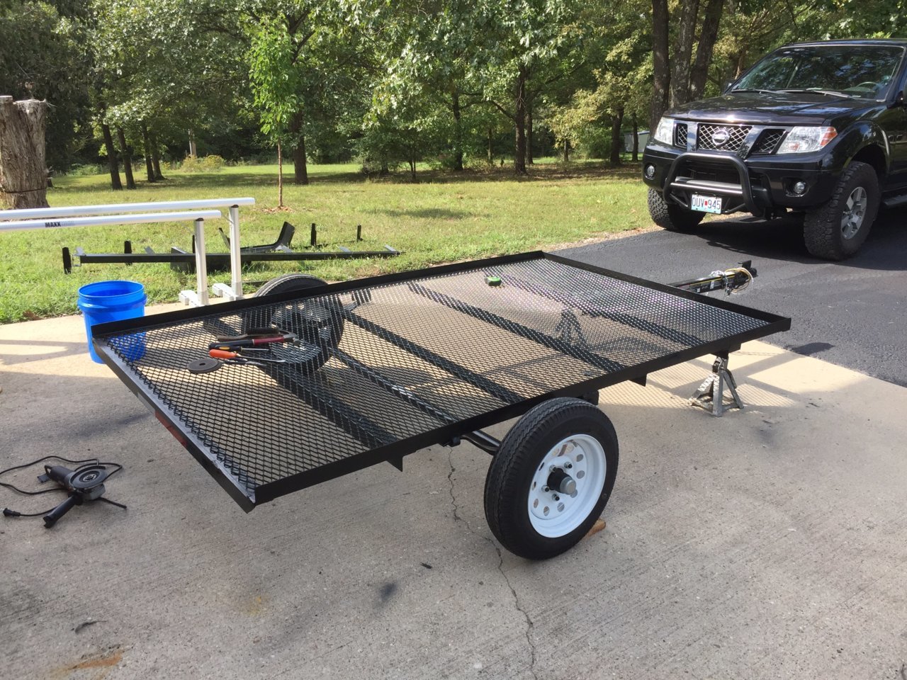

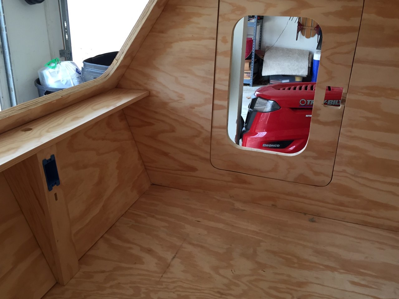

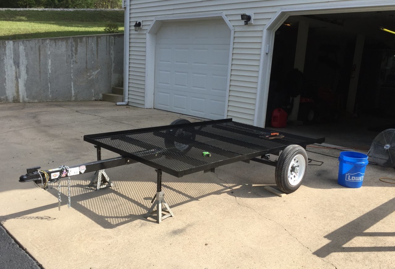

    Started with a 5x8 Carry-On trailer I picked up from Lowe’s. I cut so much metal off it that I probably should have just welded up one of my own. I wanted a title though. Thought it’d be easier to license. But in Missouri I discovered you can license a home built without too much trouble. I scrapped all the lights and wiring too and reinstalled all led lights and rerouted the wires.

    +1 for the Calico Jack.
    -1 for the Frontier hauling the trailer.
    +1 for the DIY. :popcorn: (off to a good start)

    Lol don’t worry the Frontier is gone and replaced with an 18 DCSB OR.

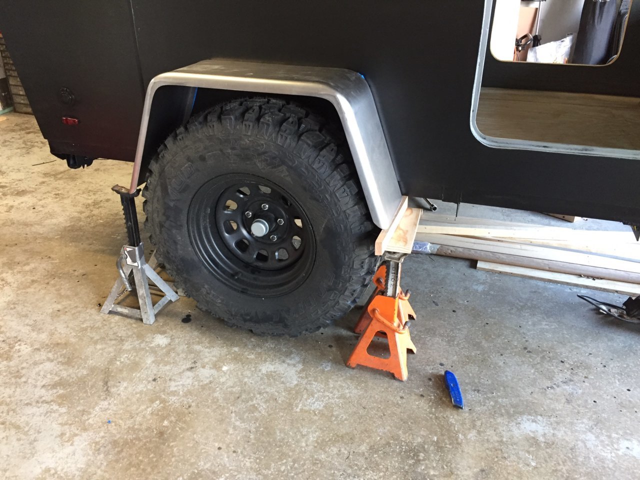

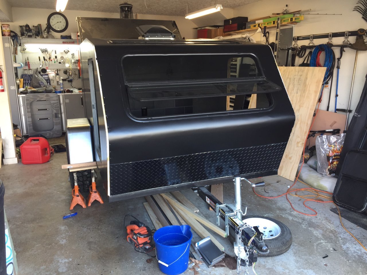

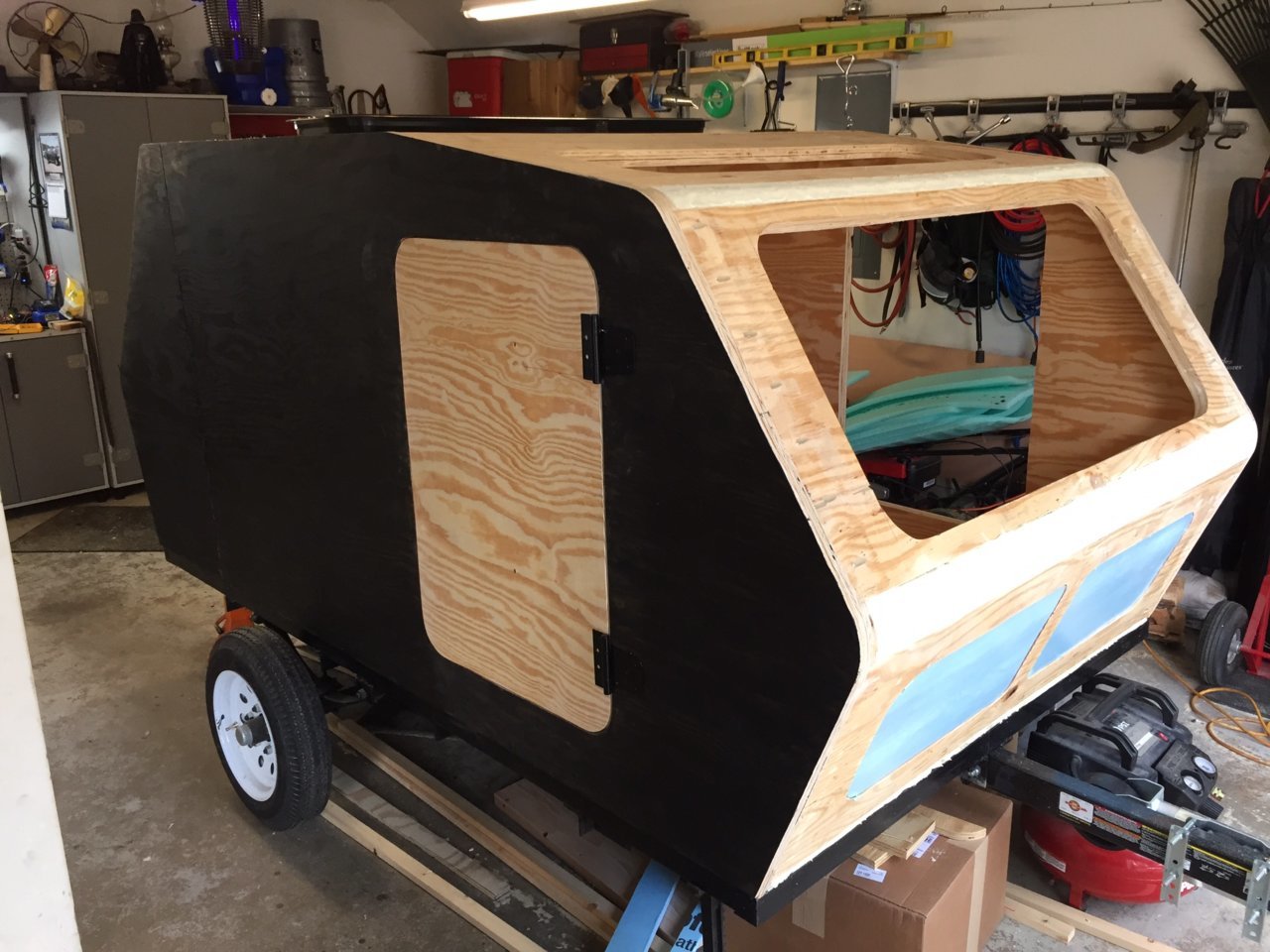

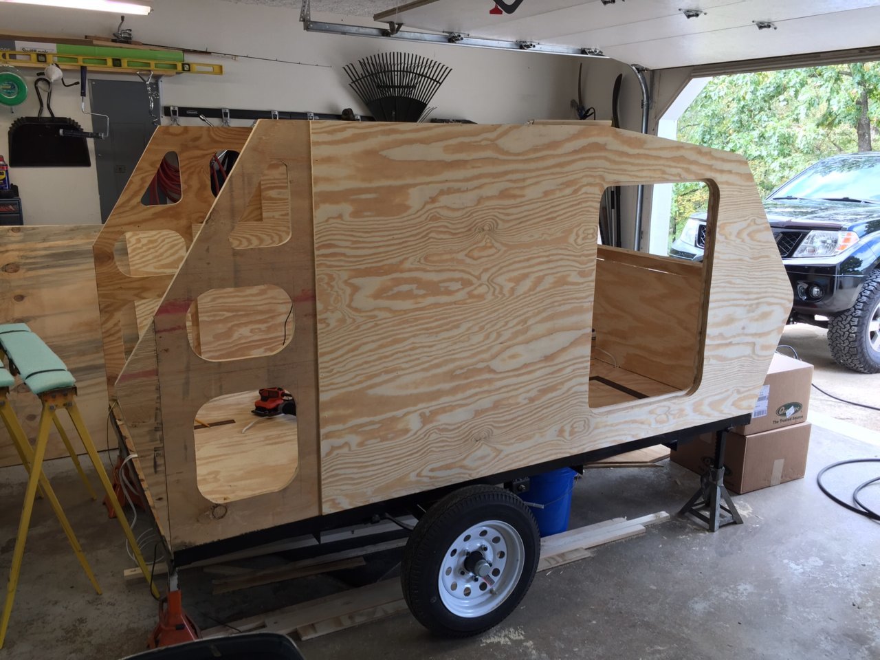

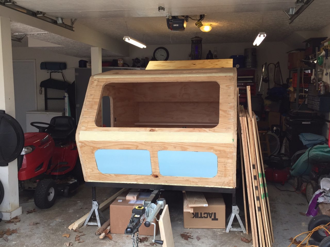

    83CC4AE3-926D-4CE3-B846-0314DA2635FB.jpg 5F50151B-084C-46DD-A95A-45C88D39D171.jpg 325B2E77-1560-4413-A8C0-B217A56D56C4.jpg Finally started to look like a camper. Skinned in pre-painted aluminum. It was harder than heck to get shaped to the curves. Very springy. I used a full spread exterior grade mastic to adhere it and small nails at the edges which would be covered by trim. I bought factory second RV windows off eBay. They worked perfectly. Glued them in with silicone.

    What's your target weight? Looks heavy with double layer of plywood
