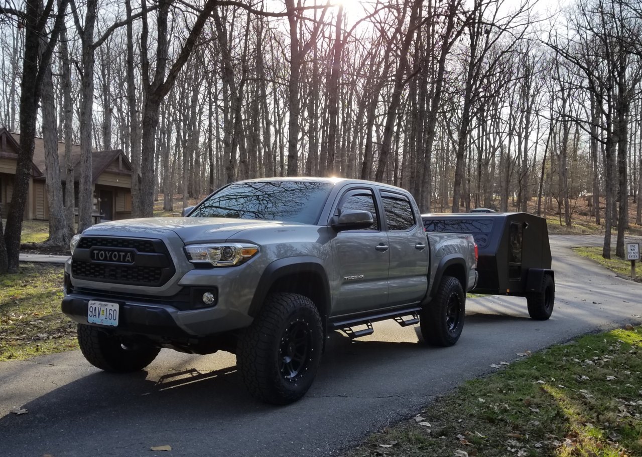

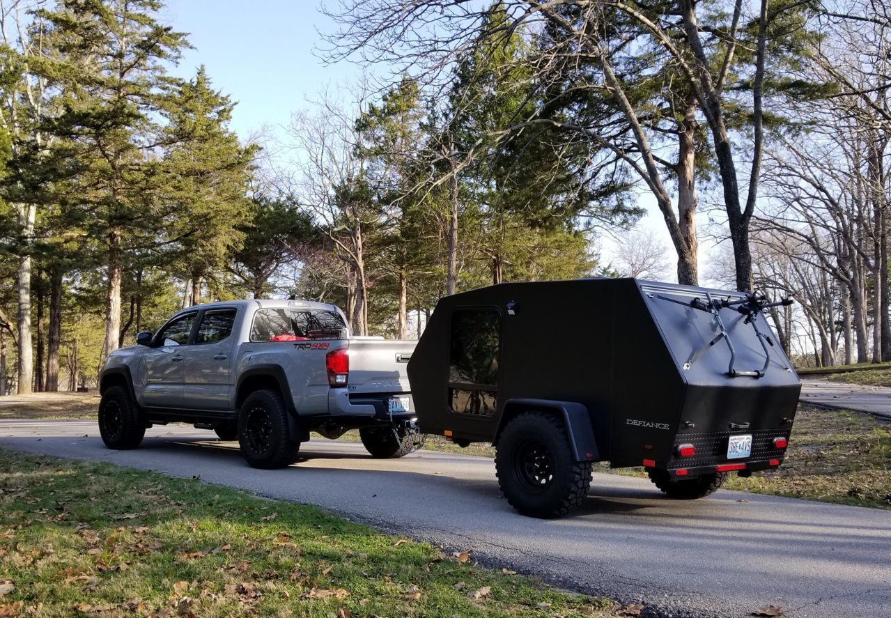

    On our last trip in April.
    224A074E-2235-44DF-BDEF-FFB90337F558.jpg D9455E82-C02E-48F6-8F16-5E4AA8CA04BB.jpg
    I added a 19” lcd tv with built in DVD player on the back wall. That was the best addition since it was pretty windy and chilly on the last trip we could just chill and watch movies.

    Nice work @MachRanger!
    How's it working out with the heat with it painted black?

    At about 1200# it’s close to maxing out the axle. I check the wheel bearings before each trip. If I start having trouble it’d be easy to upgrade to a little heavier duty. My first priority will be to strengthen the tongue since it’s just a single 2x4 steel tube. The tongue weight is really low but I’d feel better having something beefier.

    Gets pretty warm on summer trips. It has a lot of opening windows and a vent fan in the ceiling so we can cool it off quickly. It stayed warm in April during the day but we had to fire up the heater at night.

    No solar, no batteries. Not planning any off grid trips yet. All the task lighting is AA led. The tv, heater, fans and outlets are powered by 120V cord at the campsite. There’s always the option to add solar later if we decide to keep it. I lost track of everything I spent but I’d have to ballpark around $2500-3000. Could have bought one for that but that’s no fun. I liked building it more than using it.
