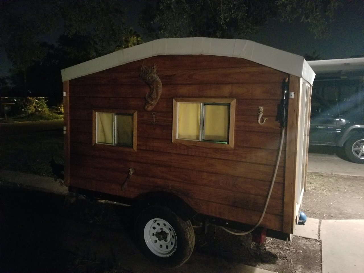

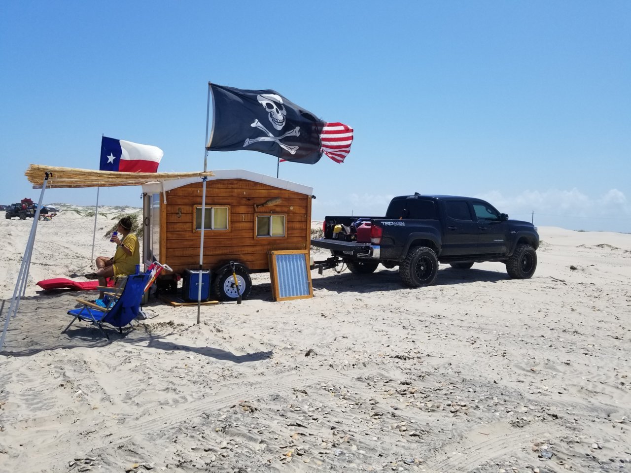

    @MachRanger I to feel your pain. We camp out at SPI every weekend and had it with tents and sleeping on the hard sand, so we built, A'luna our very own tent on steroids, equiped with an outdoor shower and a/c to fight off the blistering morning beach summer heat....take a look......20180710_214325.jpg 20180519_142304.jpg
