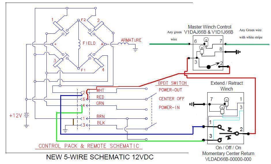

    i would understand that if i was always doing water crossing or some shit but that fucker is basically new & never used, im gonna get ahold of the shop that sold it to me on tue i just thought maybe it would be or i was hoping it would be something simple :( has to be locked up or somthing cause i have power to the control box

    If you don't have it grounded properly, it can cause it to do that. 99% of the time that I've trouble shot a winch, it was a ground issue.

    yup.. thats what happened to mine. cleaned the ground worked fine,

    i checked the ground all seems tight & clean & im still getting clicking noise out of the contractor control box :notsure:

    To completely rule it out, take a set of jumper cables and use the black side and take the winch ground directly to the battery negative.

    I'm talking about the small wire that comes from the solenoid.

    same result :mad: it seems like the solenoid is locked up, when i hit either in/out the box jumps just doesnt engage the motor :notsure: i ended up spooling all the rope off so im not running around with all that shit on the front of the trk:rolleyes:
