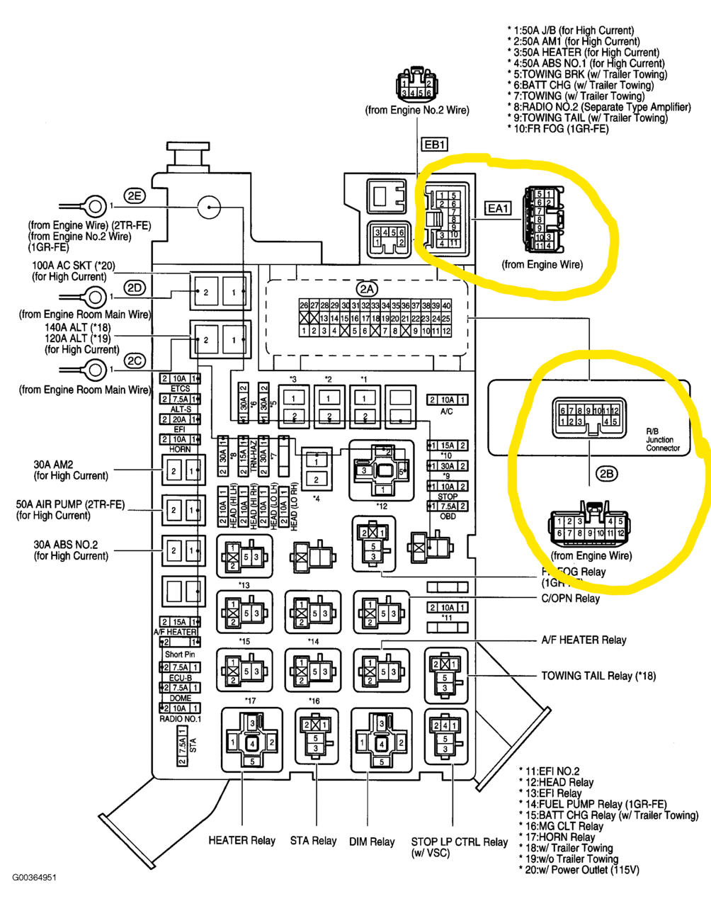

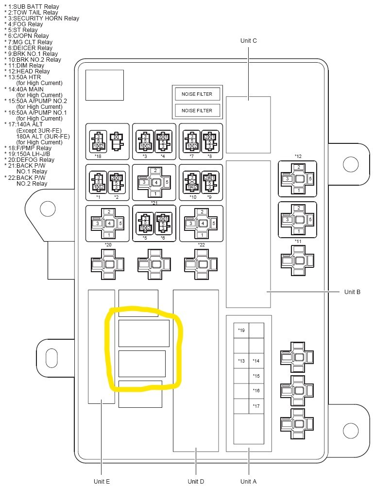

    Does anyone have pinouts for these plugs? I need to convert the Tundra engine side to plug into the Tacoma relay box. For some reason my Mitchell ProDemand software totally ignores these. I figured out a few wires, but not all. Would love to have pinouts to make sure I'm right!
    05 Tacoma 4.0L:
    07 Tundra 5.7L:

    You tried the long tedious process of splitting the harness open and following the wires? You know someone with AllData sometimes their wiring diagrams are better than Mitchells. Ideally someone with the factory repair software on here could look it up for you.

    Yes, I actually have opened up the Tundra relay box and split the harness to follow the wires! LOL I'm not planning to do that to the Tacoma harness though. I do think I have most of them figured out, but I would love to see the pinouts to make sure. ProDemand has a help line - I have never used it before, so they are way overdue for a phone call from me!

    Yeah that shit of splitting open the harness and following wires will make you go cross-eyed for sure.
