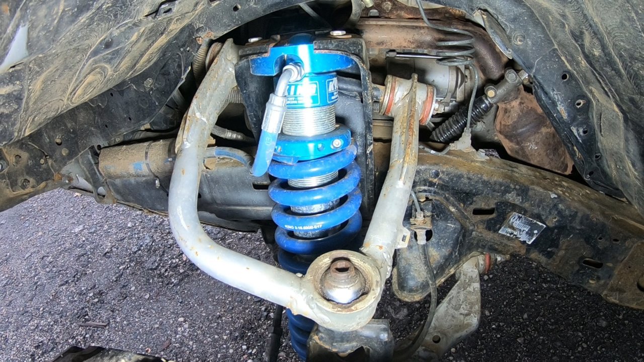

    that LT.... extended stock arms..... wow.
    What do the UCA's look like!?!?!

    05 Tacoma: 37" Tires, Method bead-locks, Long Travel, King shocks, Custom fabrication, currently swapping in a 5.7L 3URFE Tundra V8 ! 96 Tacoma: Budget Build Lots of DIY !
    I haven't had any problems with them yet. I made a jig and lengthened them 3.5". Unfortunately that was before I started filming the build. I should have some pics from the process though. Oh and I ended up angling the uniball up a little to get an extra 1.5" of droop ( and 1.5" less up travel) cause I wanted it to sit high. With a little preload, it stands at the same height that the 6" fabtech lift was at.
