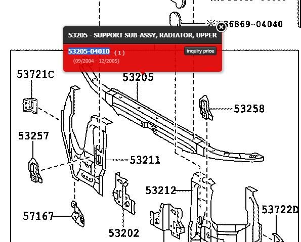

    I met some TacomaWorld friends at the Carlisle Truck Nationals. Great turn out btw! Filmed this newest video before the show, but didn't have time to edit it til now. And I already have more footage to edit too. Stay tuned. https://youtu.be/YUp3ObYw7EE

    Dang, I’m pretty sure that whole front bracket is held on by 4 bolts and easily removable
    edit:
    Here's the part number

    Easy fix for the front core support. Riv-nuts, and a small bracket for each side. Done. If you hadn't thought of that already.
    Since you'll be welding on plates to fix the rusted frame sections, don't forget about the stock Tacoma motor mount areas that used to crack on your frame year. You'll be modifying those mounts anyway, so while you're in there, beef up the frame there too.
    Keep the vids and progress a comin'!
