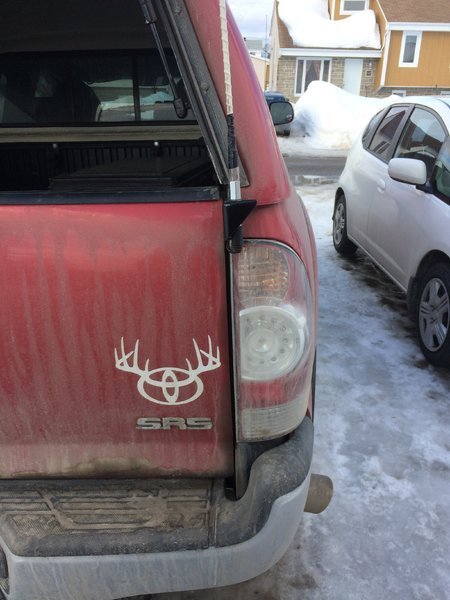

    My gaps are not that bad... and I think my shmellfab antenna holder won't work if I close the gap...

    I was thinking the same, as I am facing the same issue. The bracket has slotted holes on the base. With those, you can bolt down the bracket and still leave a small gap for the antenna mount without resetting the bedsides at 90 degrees to the floor. This will prevent further splaying of the bedsides.

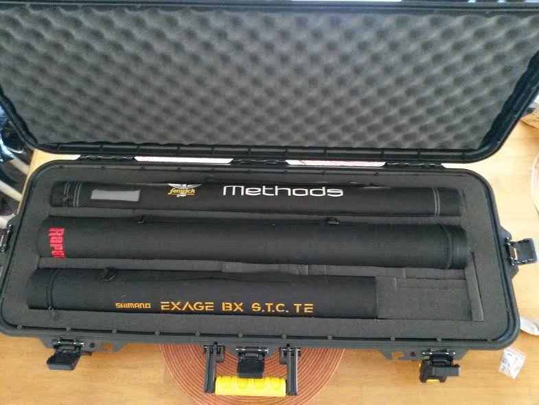

    Scooped a Plano Gun Guard off of kijiji yesterday. It was missing some foam blocks, so I moved the rest to use it for taking my travel rods to Cuba. I'll repurpose it again later.
