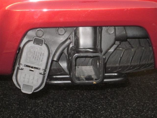

    I wasn't 100% accurate, it's a bolt on piece to the rear part of the frame. I just remember it wasn't a something you'd get from a 3rd party. Here's a pic of one, I recall mine looking nearly identical to this once except the connection was to the left tucked behind the bumper valance.

    That's the same receiver for sure.
    My connection isn't so obvious, I'll check for it one day. So it was a 7 pin harness from factory, right?

    Mine had both the 4 pin and 7 pin.

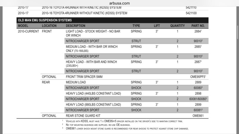

    So, I'm not sure why Icon recommends a rear track bar for the 4Runner with KDSS and King has coilovers with different part numbers for 4Runners with and without KDSS and ARB doesn't mention anything except needing a trim spacer to maintain front level. Icon recommends replacing the rear pan hard bar but king doesn't mention it. Icon uses the same front coilovers for with and without but king doesn't. I haven't delved too deeply into this however, I'm a little curious though.

    Found this on T4R.org. I know what a trac bar/panhard bar is for but it doesn't seem to be an issue with the lifts these guys are running.

    Whatever you read may be mixing up KDSS with X-REAS. The latter was offered on 2003-2009 4Runners (I think) and had hydraulic hoses going to the shocks to transfer fluid among them. [​IMG]
    KDSS basically just replaces one of the sway bar frame mounts with a shock. By closing or opening a valve to the shock, the sway bar is made stiff or soft. Imagine if one of the frame mounts on the Tacoma sway bar becomes loose - the sway bar will float and become ineffective. KDSS does this in a controlled manner. Since KDSS acts only on the sway bar, you can install coilovers with no problems.
