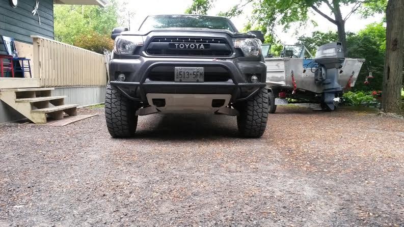

    I took you up on your invite and trolled your build thread. I love the Speedway Blue colour. It feels good when we do it ourselves.
    Your truck looks great with the new lift!

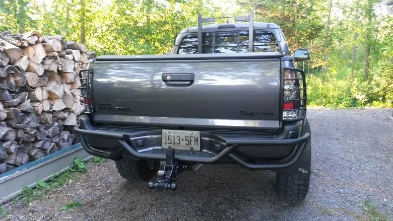

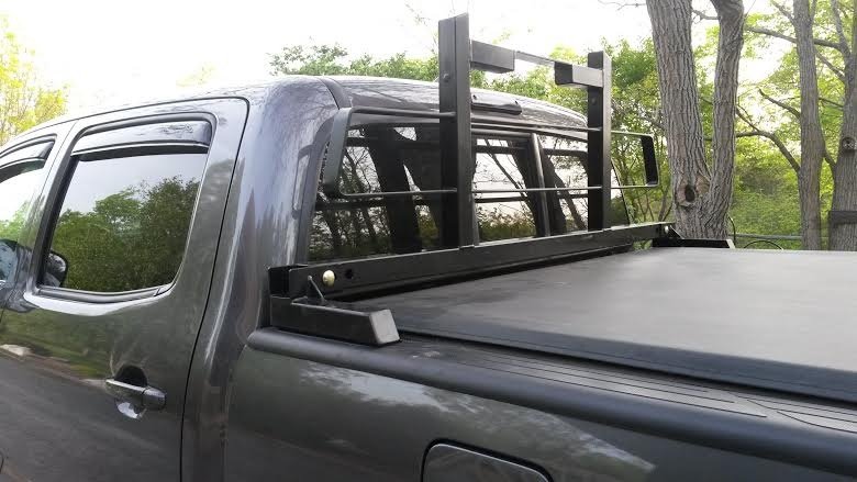

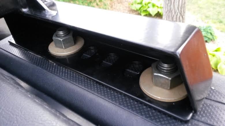

    Installed a BackRack (ladder or headache rack for you Yanks)
    I needed to do a little fudging to make it fit with the tonneau cover. I drilled holes with a 2" offset (outwards) in the base bar of the rack so that the adapter brackets spanned the box properly. You can see the original factory holes in the pic that are for a bed rail mount. I'll spray Rust Check inside then cap them with body plugs. Then I drilled holes in my bed sides to mount it. I used a cobalt 1/2" bit for the bar mod and a step bit for the holes in the bed sides, then 5/8" x 2" bolts to fasten it down. There is a touch of Loctite Red under the nuts.
    Not to worry about the holes in the bed sides, there is so much anti rust goop inside the box sides, that my arms were all greased up when done.
    I'm good to go!

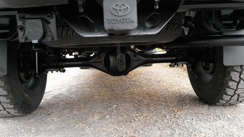

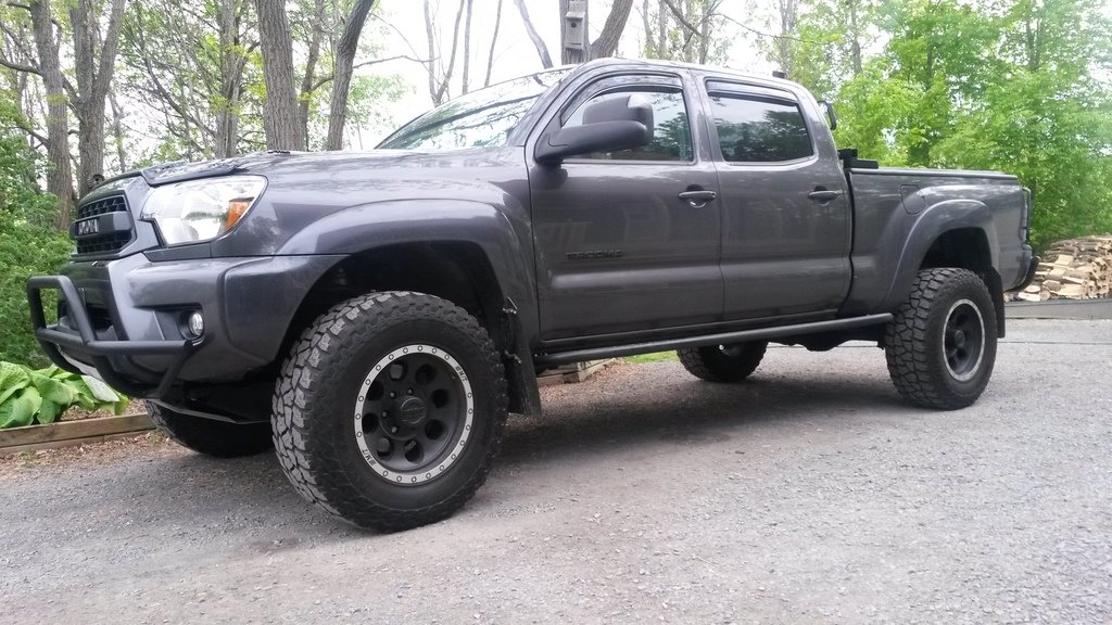

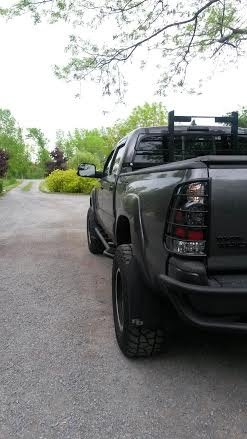

    Painted the undercarriage. Much cleaner.
    And a shot down the side:
    I'm running out of shite to do with it!

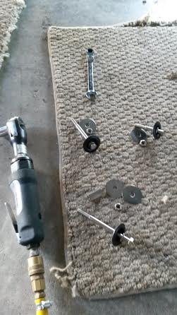

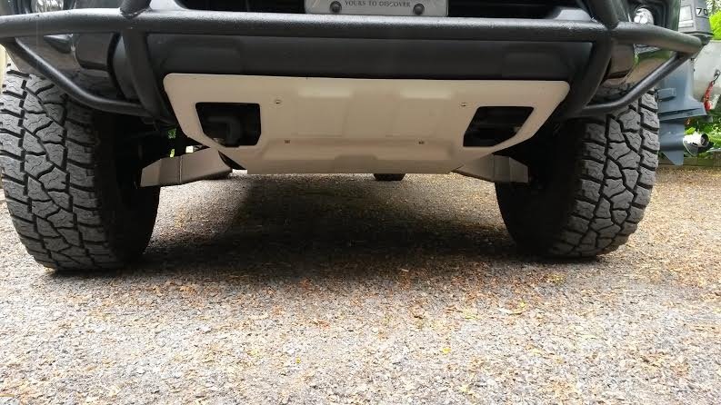

    I recently installed Ricochet Offroad LCA skids (aluminum):
    I bought all new SS hardware to replace the crap they came with.

  12. Aug 8, 2015 at 4:57 AM
    #52
    cabo wabo
    cabo wabo Well-Known Member
    Jul 25, 2012
    #83370
    2,620
    billy
    virginia
    2019 dbc short bed trd sport
    Truck looks good, the side mirrors are awesome

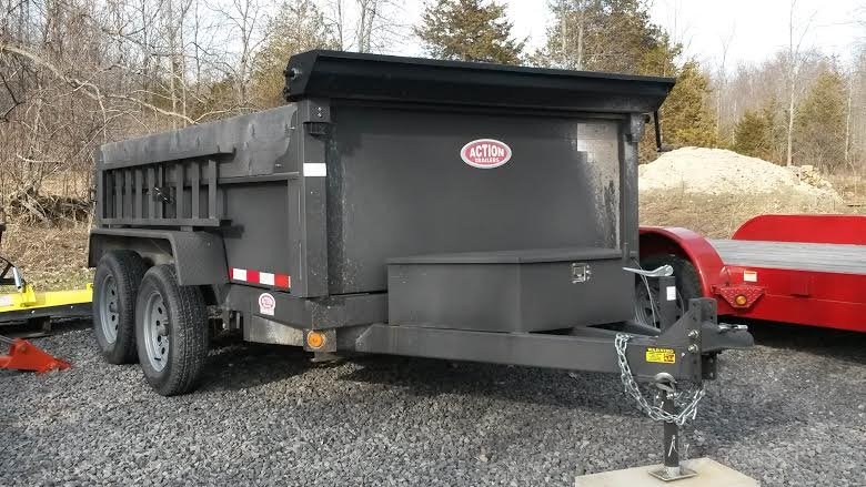

    Could you post some pictures of your trailer?. I saw it on another thread, looks awesome.
  19. Sep 6, 2015 at 2:43 PM
    #59
    taczilla
    taczilla [OP] I intend to live forever; so far.... so good!
    Jul 18, 2012
    #82874
    8,484
    Marc
    PEC, Ontario, Canada
    2016 RAM Rebel
    2012 TRD Sport - STOLEN! / 2016 RAM Rebel

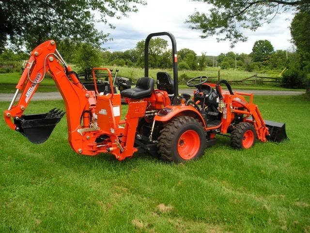

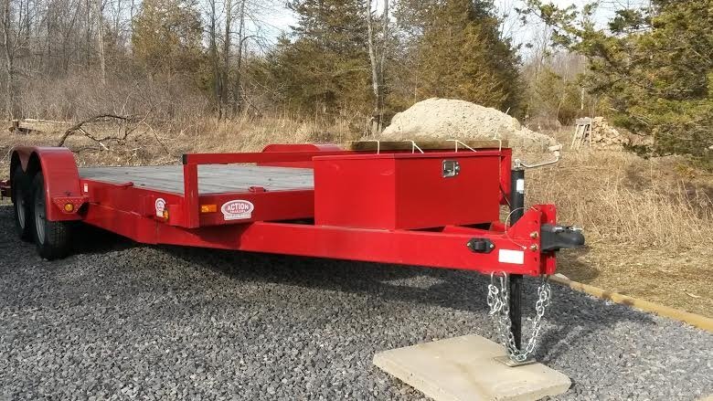

    Dump:
    Float:
    Tractor:
    ... & operator:
