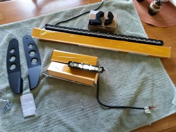

    A slim 6" to 9" flood LED is next to install in the upper middle space of the Back Rack. Since I raised the rack with the tonneau adapters, it won't hide the 3rd brake light. I want to route the wires through the tubes in the rack.

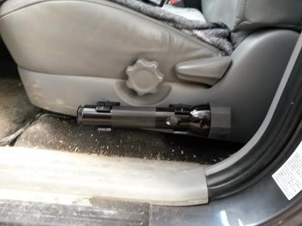

    Maglite LED mod $35 CAD
    Muddy boot mod was free.

    I mocked up an RTMR box and switch panel over the past few days... I used VHT Wrinkle Plus paint. Whatever you do, don't primer the metal beforehand, as the darn paint won't wrinkle. I had to strip the plates with lacquer thinner and do them again.
    ... and test fit...
    Putting on:
    - rear bumper flush mount pods
    - 32" LED stealth behind lower grill
    - 50" radius on roof
    The LED's below have been either sold or up for sale.
    Now saving up nickels (no pennies in Canada) to get my switches, 32" LED bar for the lower grille, and 50" radius light bar mounted on Relentless Fab roof rail mounts.
    Rome wasn't built in a day!

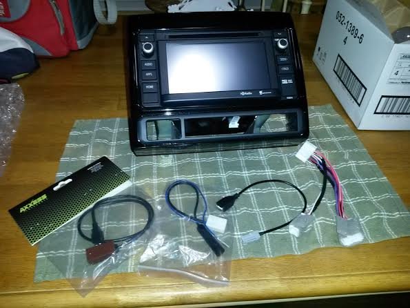

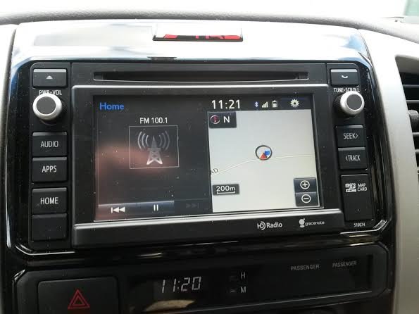

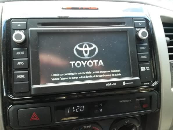

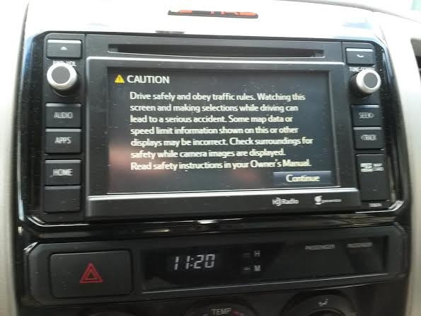

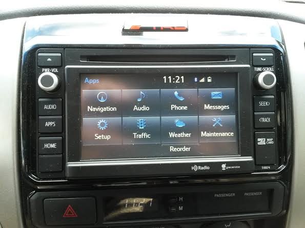

    ... and finally installed my FLTrucks nav unit after it sitting in my office a year... :oops:
    Boot up sequence:
    1) Advertising
    2) WARNING - YOU ARE STUPID!!!
    3) Radio & NAV set on split screen
    ... and pushing the APPS button
    I still need to figure out the USB issue, and buy a real expensive adapter to get the XM antenna (shark fin) plugged in, but all-in-all I'm happy with it.

    I found this thread a while back:
    https://www.tacomaworld.com/threads/2014-radio-into-2012-usb-issue.318661/
    ... and this post:
    ... and fixed my USB problem. I'm a visual learner.
    Thanks, TW! :bowdown:

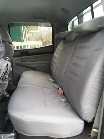

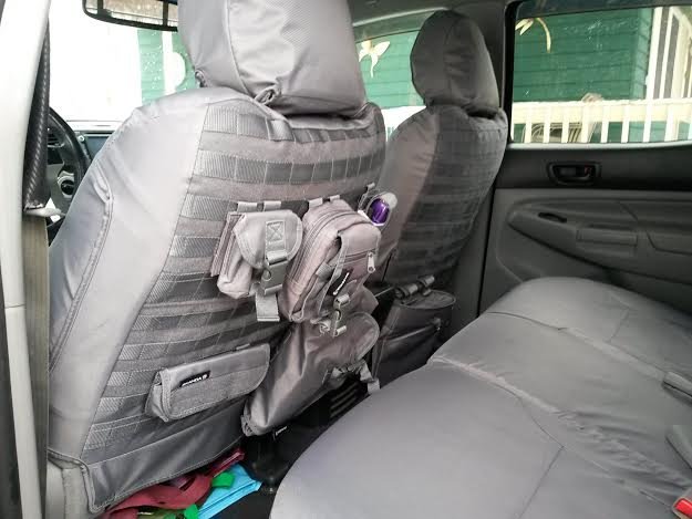

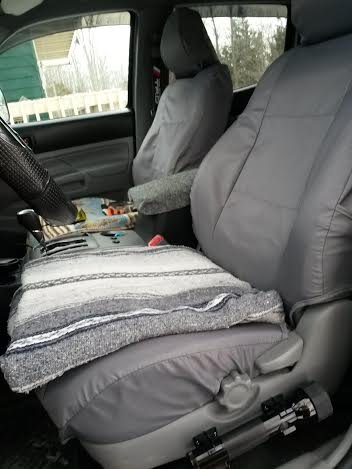

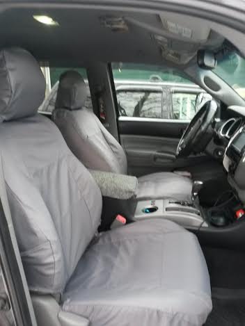

    Installed my Christmas present.
    CoverKing Ballistic Tactical 1E4
    Here ya go...
    Fronts:
    The console cover is made from marine carpet cut/folded/stapled. That's where my little Westie sits shotgun.
    Rears:
    MOLLE packs:

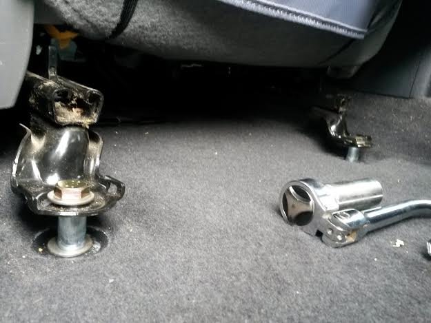

    And I did a seat lift on the drivers side:
    2 - M10 x 1.25 x 50mm bolts (8.8 grade)
    2- 1/2" x 5/8" x 1" steel spacers
    4 - washers from my washer bin
    Total - $5
    And to keep our butts comfy warm in the winter, although I do have heated seats:
    The rear headrest covers do not fit at all. They do not cover the headrest, nor do they have slots to accommodate the fold down levers. The center headrest cover looks like a shower cap. I'm phoning them tomorrow.
