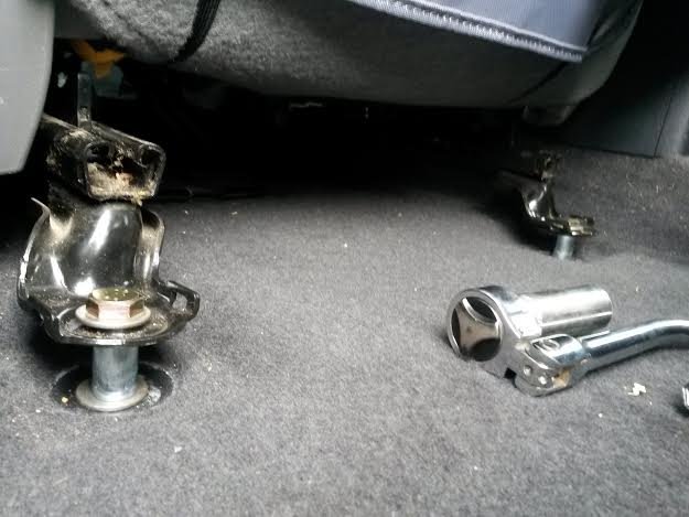

    I know that I mentioned this mod in the seat cover post a little earlier, but I thought that it should be revisited and stand alone.
    If you're a short ass like me (5'8"), this greatly improves your line of site with the low TRD Sport seats.
    Simply go to the hardware store and get yourself:
    2 of M10 x 1.25 x 50mm bolts (17mm heads) note: shoulder bolts would be preferred, but they didn't have any.
    2 of 1/2 x 5/8" x 1" steel spacers
    4 washers
    I removed the rear seat bolts (14mm socket), lifted the seat by hand, placed washers on the floor over the bolt holes, then the steel spacers, lowered the seat onto the spacers, and inserted the bolts/washers.
    That and the ImMrYo mirror relocation bracket really improves lines of sight as it raises your butt up. And no, you don't slide forward off the seat. The new seating position has more of a truck feel. My wife didn't want her side done, as she likes sitting back and enjoying the ride.
    Replace the pop off plastic trim and one can barely tell that the seat has been raised.
