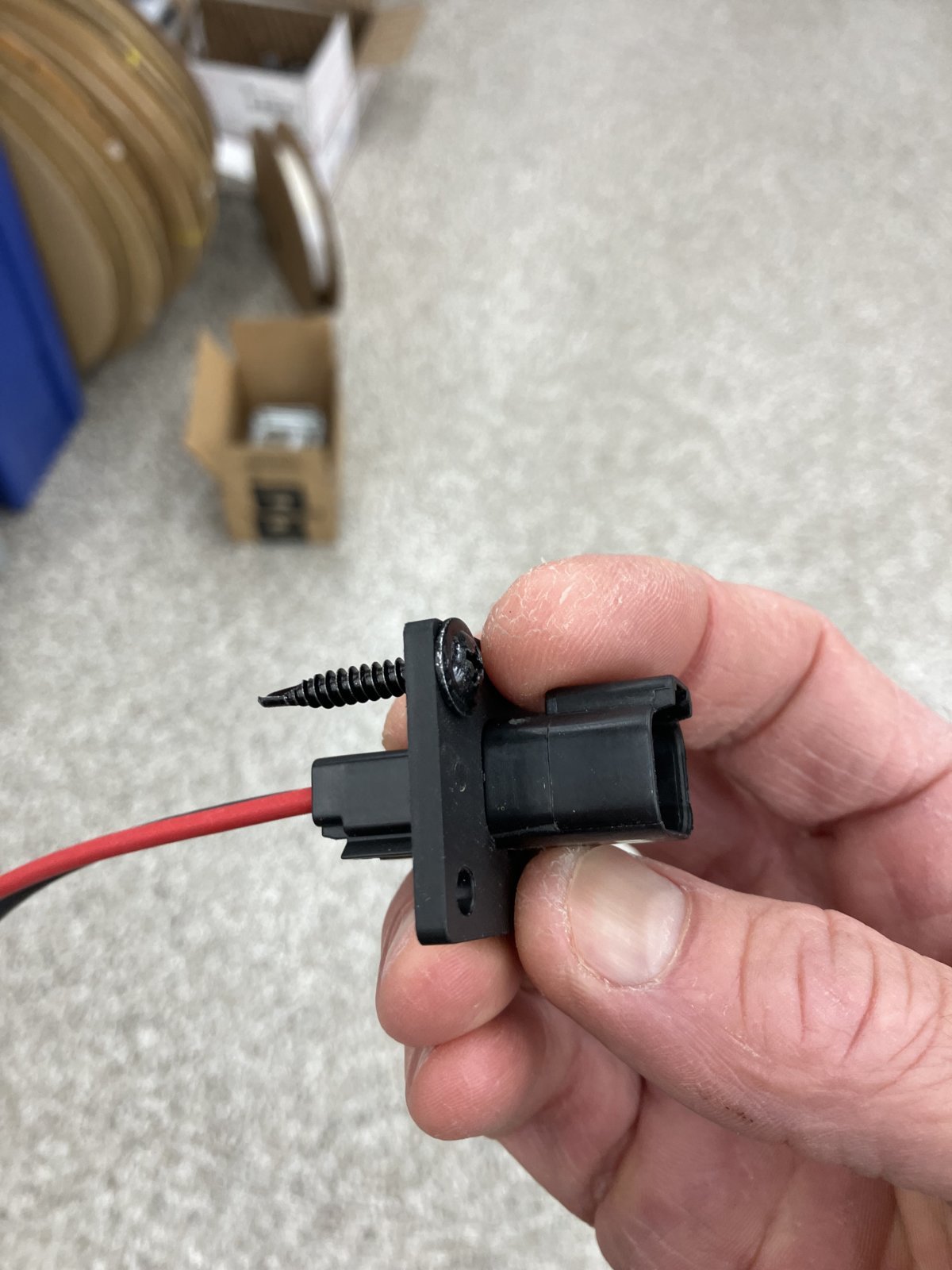

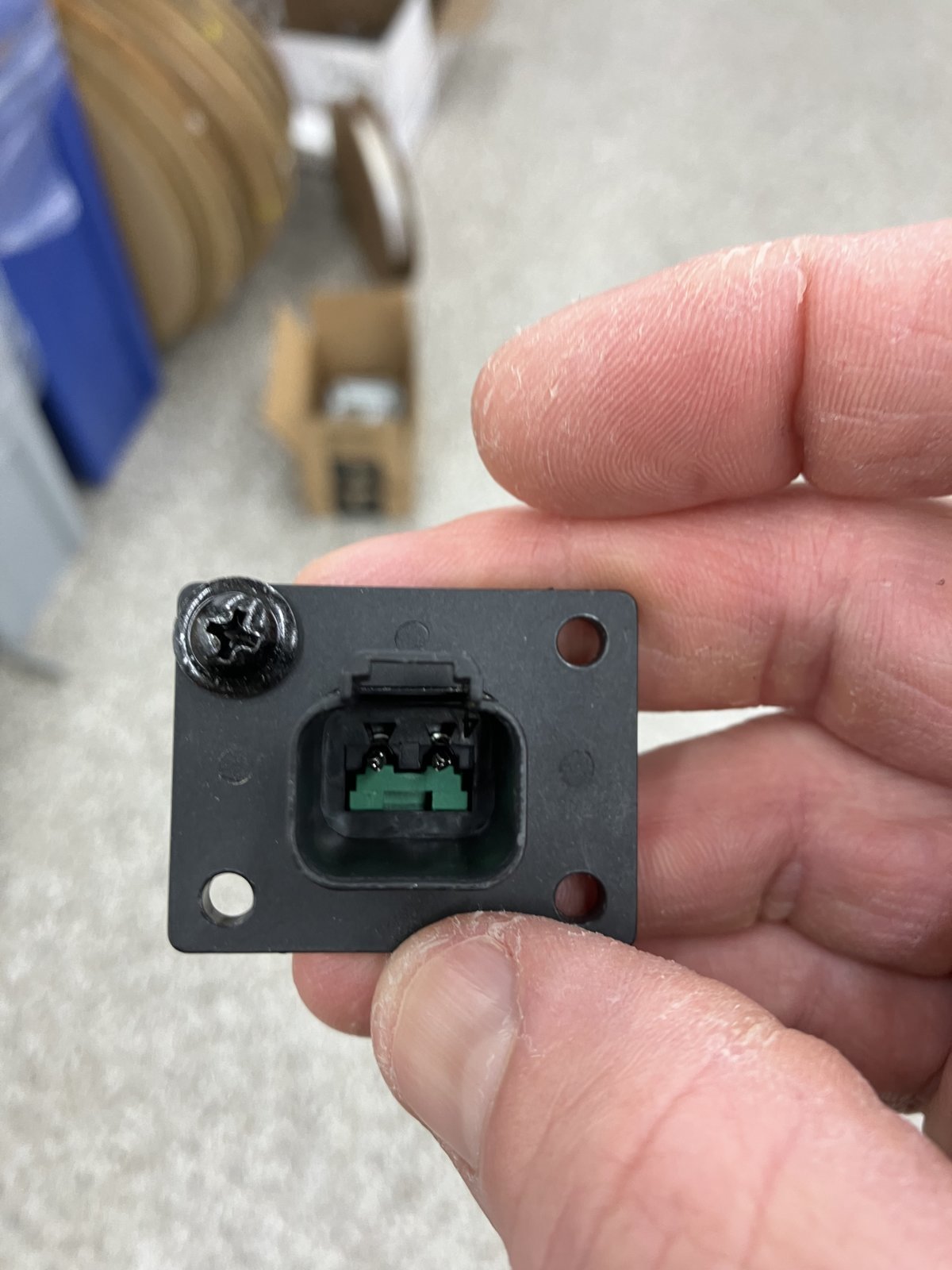

    Got some black stainless screws for these after a few people requested that extra bit. Anyone with thoughts? Maybe a bit too Big Head Todd? Tiny overlap at the edges.
