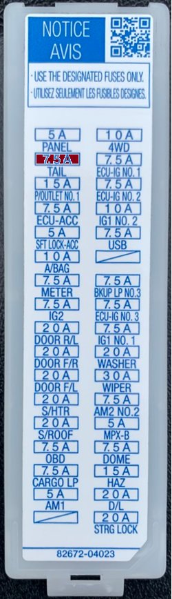

    Hey there!
    I was replacing my tag lights with LED bulbs when I tried tightening one led bulb because it was flickering it knocked out my DRL as well as the tag lights. Anyone know fuse location for this???
    Thanks!

    I replaced my LED bulbs on my Honda was using needle nose pliers to pull old bulbs. They touched both sides of connector on the dome light and blew a fuse. Zero lights worked, display, exterior, interior... Found the fuse and fixed it all. Car had a spare in the fuse box.
    Good luck! Hope its this simple.

    Cab, Driver's side, place your head on the carpet and look up...:D
