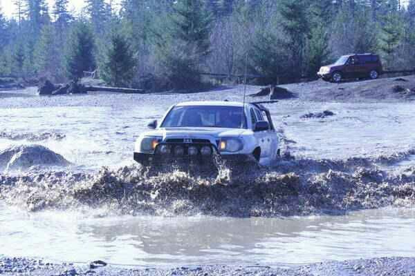

    How did it happen? I've been through the hole many times and never suffered any damage. I have to find the video's of us going through with mud over the hood. Never a hydro or water intrusion in the interior.

    whole front end dropped in and I am sure water flooded the air intake almost immediately. pretty sure that the wheel well where the intake tube starts at had all air access sealed off by water. put the vacuum of the motor drawing in air onto that and it pulled the water into the intake faster than Ben could reach for the keys to turn the truck off.

    I have been through it on our first trip (vid HERE) and didn't have any issues.
    Not sure what happened on this one, but I purposefully avoided through the deep parts, I just didn't feel the need to do it again. So, I was skirting around the edge, and weaving through the stumps, drove the shallow pit on the far side and wrapped-around. I stopped before the small/narrow pond area (right HERE) and thought I would just drive through to the other side, as soon I was all the way in, it got DEEP and maybe it was the perfect combination of turbulence, throttle, and intake velocity, but my aFe gulped a ton of water and the engine died right in the middle. I called Tallon on the CB to get a tug, and after sitting for about a minute in the water, it started seeping in though the doors, probably about 5"-6" total.
    We pulled it out, and pulled the spark plugs and intake to clean them out. After all the plugs were out, I cranked it over to eject all the water from the cylinders, and that shit shot out like a cannon, but after a couple turn overs, it seized again. I crawled under and turned the crank by hand and it rotated freely before stopping. Reversed the wrench, and it did the same thing. No bueno!
    Tallon towed me out to the staging area, but we had to stop to re-rig the strap...that's when we noticed oil dripping out of the skid plate. :facepalm:
