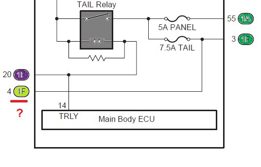

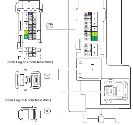

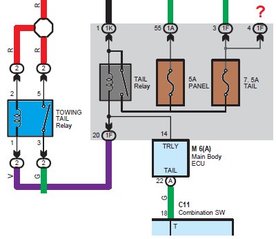

    Anyone with a Limited Model that could verify if there is a green wire on Main Body ECU connector 1F, slot #4?
    Plain Jane SR has none.

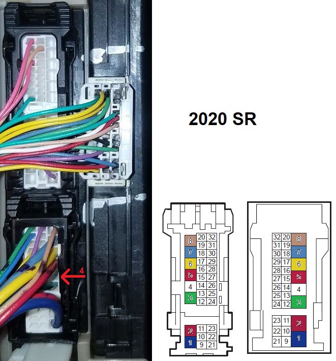

    05 PreRunner TRD Offroad AutoTrans
    Hood Struts, My version Fogs always ON, Map & Overhead Light Mod,
    Location #4
