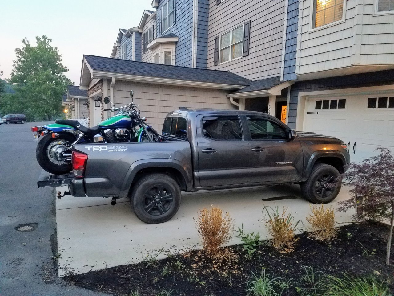

    How far of a trip are you planning?
    I hauled my motorcycle ~250 highway miles with the rear tire resting on the tailgate and had no problems at all.
    If you wanted to distribute the weight you could get a 2×8, cut it to length and rest both tires on it. That would eliminate the "pressure point" of the tire on the tailgate.

    Thank you, that is very useful. I have the option of trading this vehicle for the 6 foot bed, but I really don’t want that if I can carry the bike with about half its weight on the tailgate of the 5 foot bed model. I get it, no off-road work. Just transporting motorcycles on paved roads.

    That picture is good. Is that the 60 inch or the 72 inch bed? My biggest bike, an old Road King, will have even more of the weight on the tailgate than yours. I carried it in my 2001 F150 easily, gate down, but this bed is shorter. I would rather avoid getting the longer bed version if I can.

    5ft bed. It's a 750 shadow for reference

    The picture gives me an idea. Does anyone know if there is a device made specifically for the Tacoma that attaches to the trailer hitch and fits vertically as some sort of bracket to hold and reinforce the tailgate? Given how strong the tail hitches are made, some sort of vertical brace that cradled and supported the tailgate in the down position would be excellent. Anyone ever seen such a thing? (...Or do I call my welder?)

    The plank(or a strip of 3/4” ply) with guides idea ftw. One pot hole could ruin your day and your tail gate since it’s a dynamic load rather than static(the difference between jumping and standing). Ribs or bed mat under the bottom to keep it from sliding. One look inside and you’ll see just how flimsy they are. The composites won’t fail but the tin can only flex so much before it kinks.

    Something like that is made for carrying loads out the back but it doesn’t support the tailgate, rather it takes the load instead of the tailgate. Supporting it from underneath isn’t a good idea since the sheet metal on the outer face will just crumple. There’s no real rigid skeleton inside, just a series of tabs that support the skin with NVH adhesive foam the same as the stuff that fails in the hood.

    One number won’t cover both a point load and a load spread over the width of the tailgate. The bed has a cross rail at the back so it would be much better to cantilever over that. I stand on mine to tie down roof loads but I avoid anything more than that.
