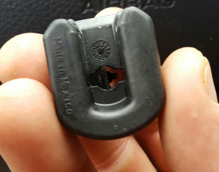

    depending on when you got your truck, parts have changed. i had a plastic bushing go bad and they ordered the part twice only to find out the male part on the passenger side has been altered since original making the part they ordered not fit for me. i could take pictures to explain better but hopefully no one else has this problem.

    what do you want to know?

    This is the new bushing. It is part of the passenger side assembly. When my old one broke they ordered the part and said when they tried to install it wouldn't fit. They thought maybe they ordered the wrong part. Order another , that doesn't fit either. After calling and some investigation apparently Toyota changed the size of the male part it slides over. It's connected to the truck not the tailgate. Just a peg basically. So they had to order the updated male part. Finally just got it all put on. Although when they put it all back together, they didn't line up the right side bumper gap with the left. Kinda got a shrug when I pointed it out haha. I can get some more pictures if needed, hope I explained that we'll enough.
