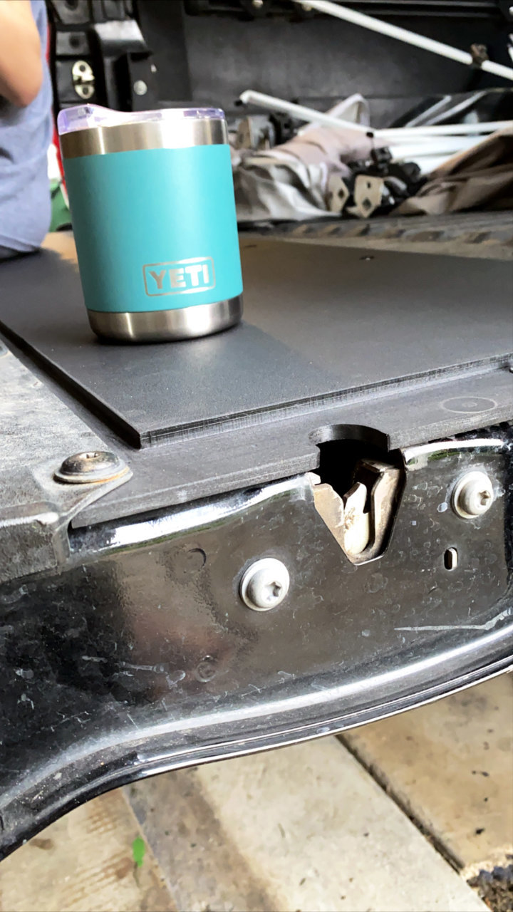

    I made me tailgate panel with some extra 1/2” king starboard (marine grade) I had lying around from my rear seat delete.
    I simply used the extg plastic panel as a template then used a router to take the edges down to a 1/4”. Was pretty simple, starboard can be cut with regular wood working tools.

    That’s probably the cleanest diy I’ve seen

    It was fun little project, as long as you have a router, saw, some clamps and patience you can get it done :thumbsup:
