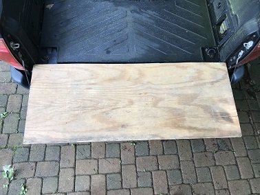

    3/4" exterior plywood 54 1/2" X 22". The edge overlaps the tailgate 2 1/4", so you can clamp whatever you're working on. Fits against the back bed posts, and slides in between the tailgate support cables. Lower the tailgate, slide it in place. It won't move. No fasteners needed. The tailgate cables, the fit at the corner posts and the weight of the wood, keep it in place. Distributes weight evenly over the entire tailgate, I can stand on it, use it for loading heavy chit, perfect height for a field workbench, shooting bench, ramps to load up an ATV, mower, etc. I had 6 full jerry cans on it today plus me standing on it, around 400lbs. If you do this, watch the cables and their connection points, you could overstress them. Mine are still fine, after much use for years. Common sense should prevail.
    I slide it under the bed mat for storage, both sides stay dry, doesn't move around, doesn't make the mat flap in the wind. I forget it's there, until I need it, and it was basically free. :thumbsup:

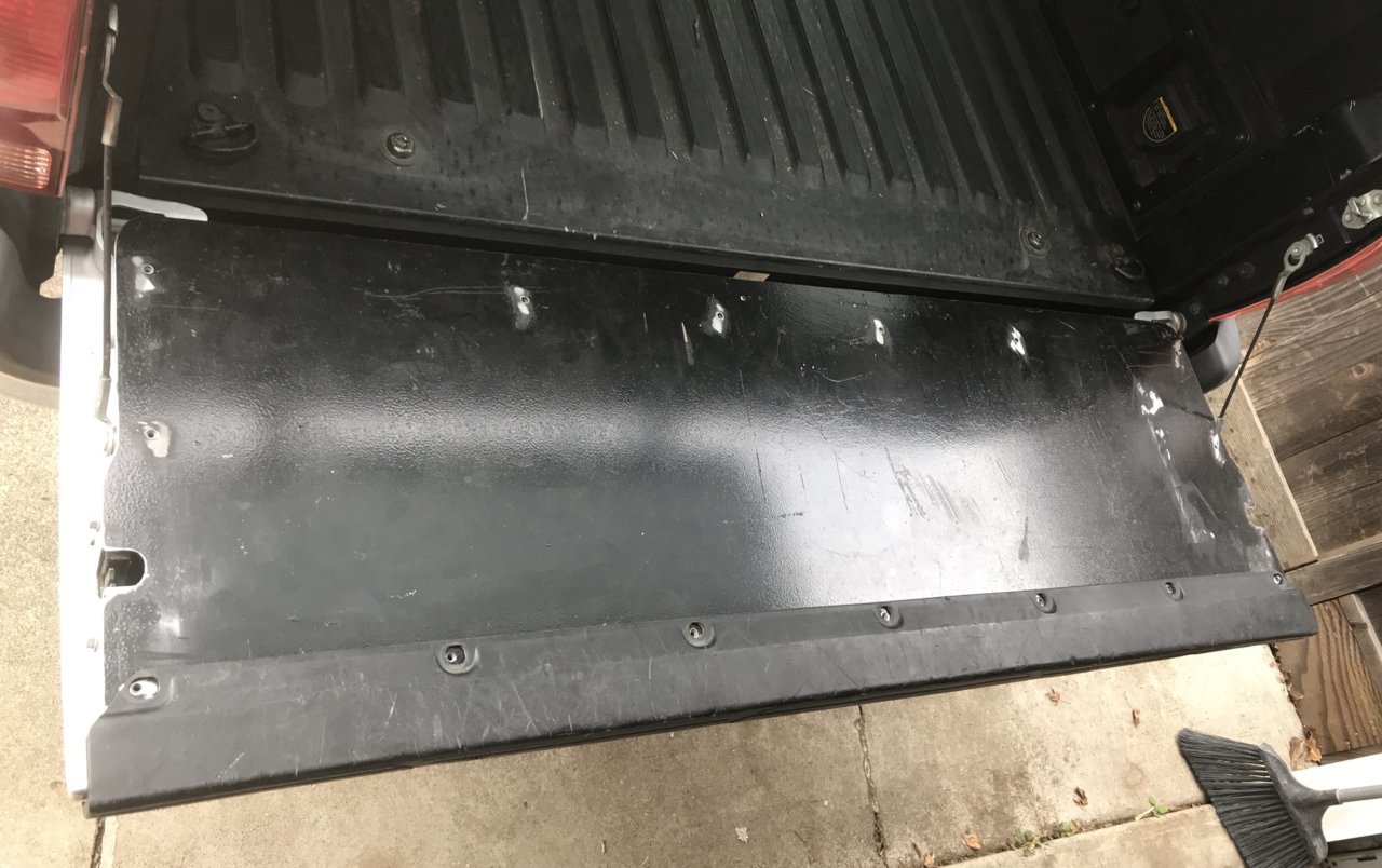

    Made my own from a $20 20ga steel cabinet door bought at the scrap yard. Installed the stock cover over it. I forget it is there until I have to lift up the gate.
