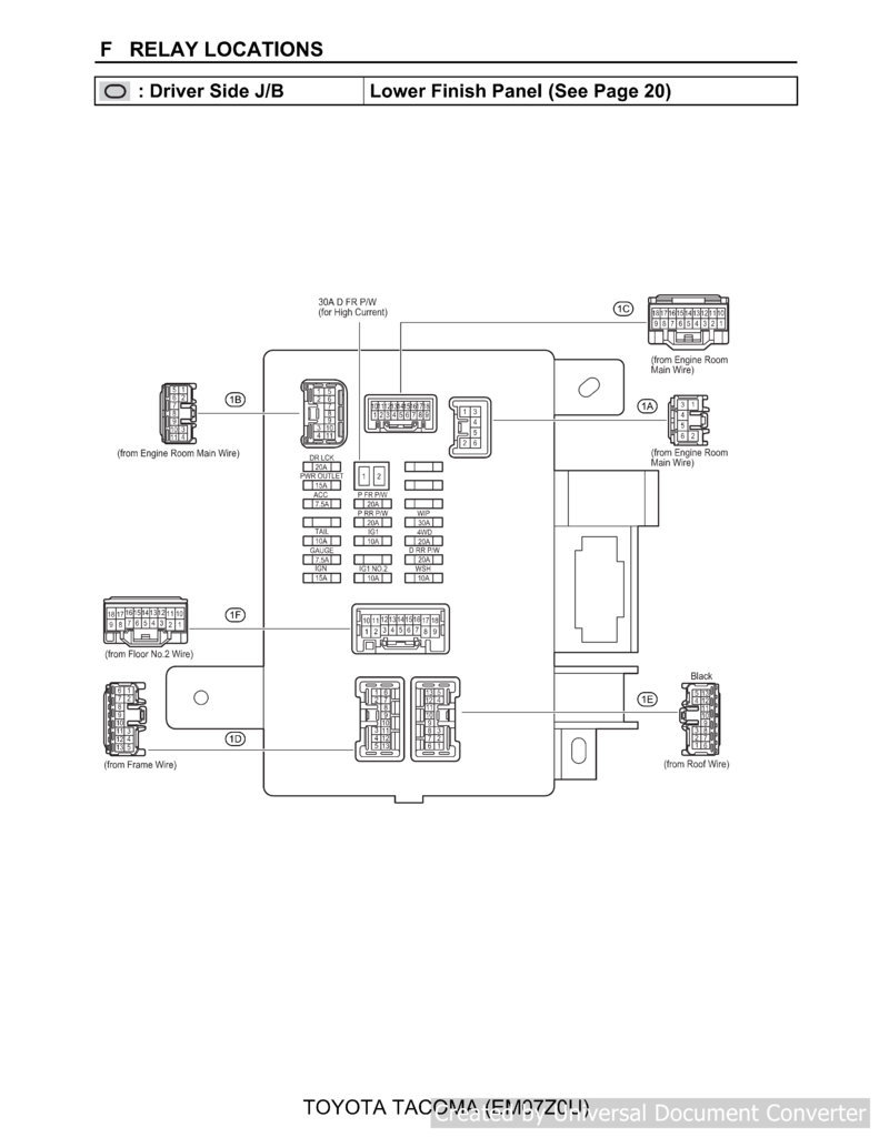

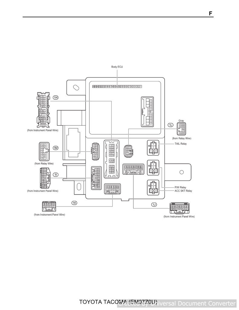

    The TAIL Fuse (10A) is powered by the TAIL Relay which is controlled by the Body ECU and powered by the J/B Fuse (50A).

    So it would seem either the TAIL Relay failed or the Body ECU isn't turning it on for some reason, have to go there to test further or try swapping the relay first.
    The TAIL Relay is located on the back of the Driver's Side Fuse/Junction Box/Body ECU
    The relay has Power at all times on Pins 1 & 3, the Body ECU Grounds Pin 2 to turn the relay on. Pin 5 is Power out to the TAIL Fuse (10A).
