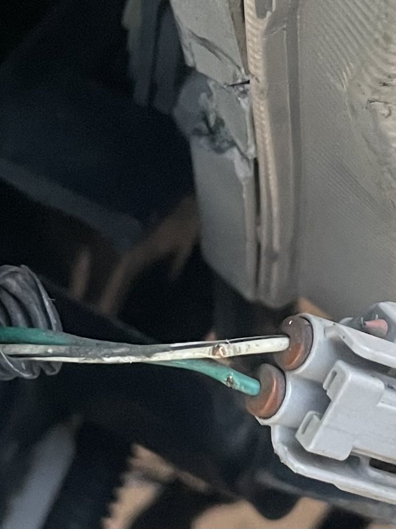

    Fond the culprit! I got in a little fender bender a while back and the aftermarket running light I put in there jostled loose and rubbed a hole in the wire. All good now, thanks for the guidance guys!

    Thanks for posting the resolution and the photo. The photo is great and will give future searchers a visual of what to look out for!

    That is a very bad habit of poking holes through wire insulation !!
    Then it might have been done before you bought the truck
