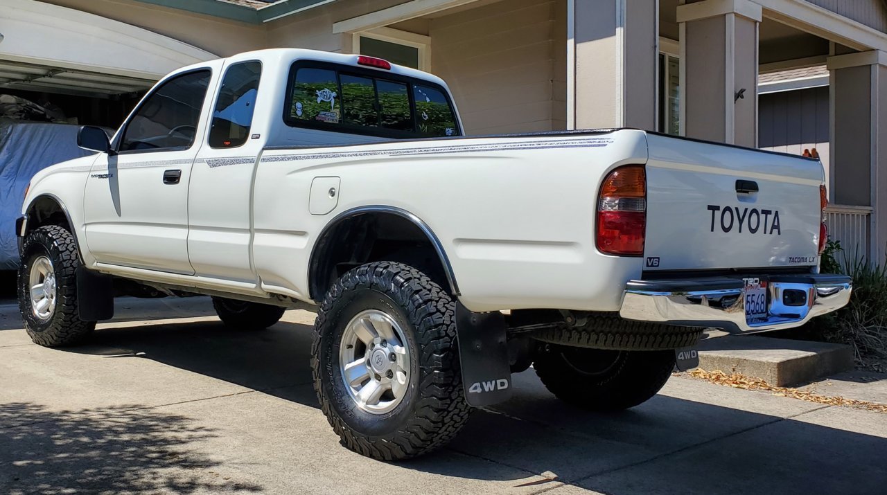

    20210724_113826 (2).jpg I have a '96 and put the '01 to '04 lenses on the stock housings. I had to change the outer screws since the newer lenses were thicker, someone correct me if I am wrong.
