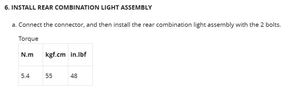

    BTW, if you take the bottom one out.
    I bet the light will come out like normal.
    Then you might have enough bolt sticking out to grab with vice grips. :thumbsup:

  5. Feb 26, 2025 at 5:45 AM
    Peter603Taco
    Peter603Taco Well-Known Member
    Sep 13, 2022
    #405709
    310
    Peter
    New Hampshire
    2013 TRD Sport DCLB
    jr49[OP] likes this.
