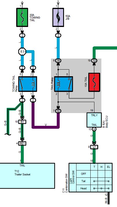

    I see no mention of headlights or fog lights. The switch operates relays located in the main fuse box behind the battery. The short could be in the engine bay between the headlights and fuse box or try swapping in a new relay.

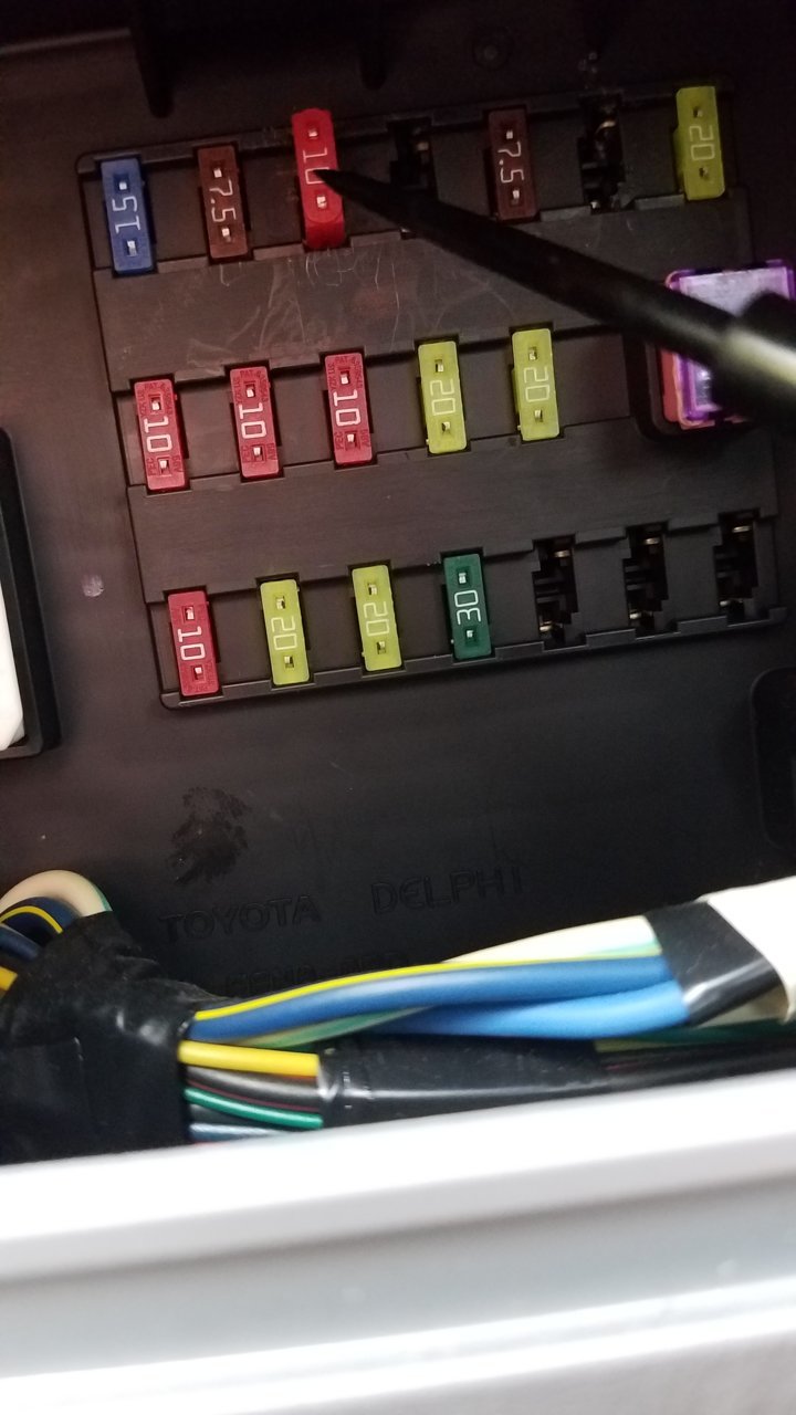

    The 10 amp fuse (#3) in the under dash fuse box.

    It is the taillights and license plate lights that are out. I only knew because I got pulled over for it. The break lights still work.
    I wrongly assumed the trailer plug would likewise be out, but never tested or used. All wiring is original, as I've been the only owner.
    The attached photo shows the fuse that blows as soon as the lights are turned on, even with tail light assembly and license plate bulbs disconnected.

    Going to be tuff to find. Unplug the front corner park lights and inspect the wiring at the trailer brake controller plug near the left kick panel.

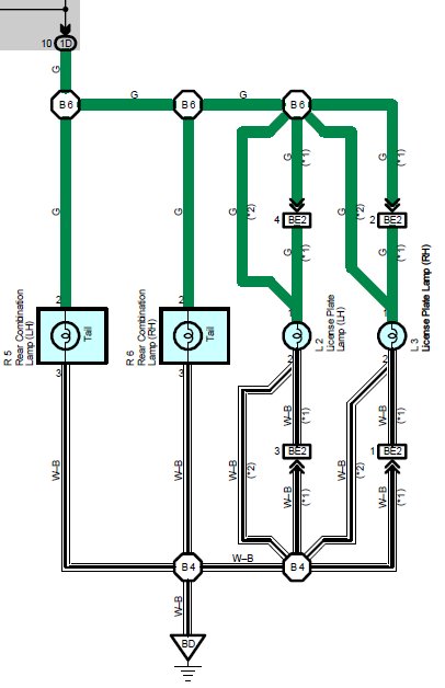

    10@1D harness is my guesstimate

    Do you know how to de-pin the connector? Disconnect 1D, de-pin #10 green wire. Reconnect 1D without the green wire, place new fuse, switch n verify.

    Depinned the 1D #10 (green) wire, installed a new fuse (TAIL 10 amp), and it still blew upon turning light on.

    Good job. Now you know the problems not in the rear lights. Now try depinning the other wires in post #13 above.

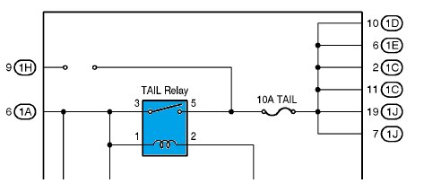

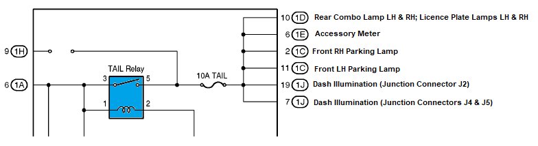

    Without replacing green wire on 1D; De-pin on 1C

    Acknowledged. Assume one at a time, repinning the ones tested when the fuse blows, and when it doesn't, that'll be my problem wire (circuit). Thanks.
