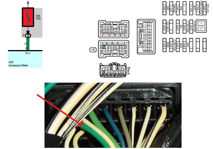

    2013 Tacoma 4WD
    Without replacing green wire on 1D; De-pin on 1C, resulted in same fuse blowing when lights turned on.

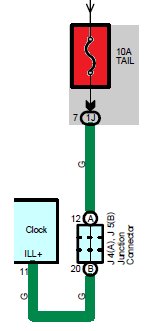

    Bummer, thought that exterior circuits were the culprit. The remaining internal ones are difficult to de-pin.

    Next:
    Still keeping removed pins out...

    Hood Struts, My version Fogs always ON, Map & Overhead Light Mod,
    This 7 & 19 pins in connector 1J provide juice to dash switches, radio, a/c, etc.(illumination circuit)

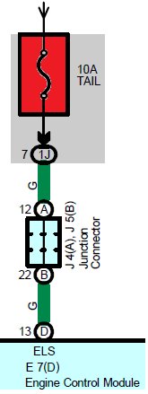

    All the usual diesel truck mods- fuel system upgrade, programmer, CAI, intake manifold, 60MM stealth turbo
    This is headed in the direction I was thinking it might be. The ac module is fairly easy to pull out and might be worth unplugging the connector to see if that eliminates the problem. Looks like your doing a tremendous job following caribe makaira’s Directions. He’s posted advise on here before and is very knowledgeable. Definitely a great resource. Good luck!
