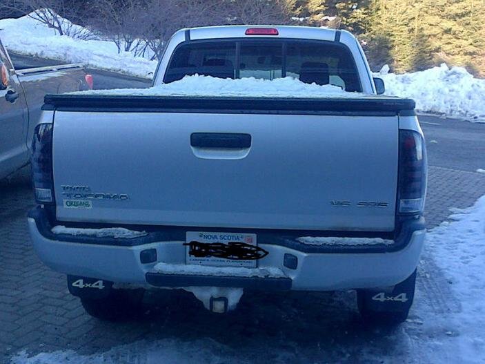

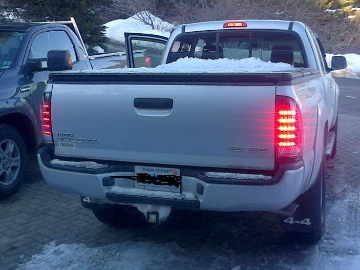

    Just bought a set of IPCW black tails and after putting them in, my tail lights aren't on in the dark when I turned my lights on, like my old lights were. Everything else works fine except that part.
    Any ideas?

    I always had light from my tails driving in the dark, put these in and now I don't.

    You are right, that 10A fuse was blown. Replaced it and it blew again. Should I replace it with a bigger amp fuse? Would the new LED tails cause the 10amp to short out and need a 15 or 20?

    Took out my headlight fuses and replaces tail light fuse with a 15 amp. Tails works for 10 seconds then started to flicker and dim then blew the fuse. Where should I go from here?
