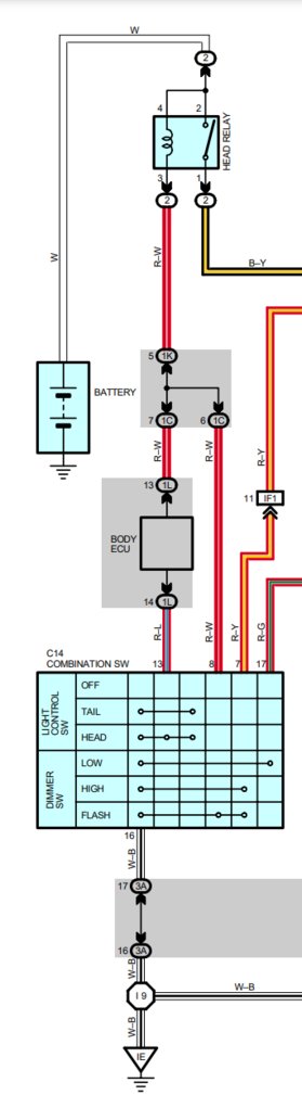

    I will preface that I know there are lots of other threads about stuff like this out there and I promise I have been reading through old threads to try not to double up...but electrical stuff is just SO much fun and I'm hoping maybe someone out there has some guidance that will save me some hours of searching.
    So a few days ago I left work in the dark, hopped in the truck, start it, flip the headlights on, drive home. Getting home I'm backing up to a wall and noticed my tail lights are off, but brake lights are working...signals are working too. Huh maybe the bulbs died. I shut the car off and flip the lights switch to turn my headlights off...headlights don't turn off. Now I'm scratching my head like wtf is going on. So here is my best break down haha:
    Truck off - all lights off
    Turn truck on - all lights still off, signals, break, reverse lights work
    Flip light switch - head lights turn on, all normal dash lights come on, tail lights do not
    Flip light switch again (off) - main head lights stay on, corner head lights + dash lights turn off
    Brights turn on/off/flash like normal
    Turn car off + light switch off - headlights stay on, all others turn off
    Disconnect battery to get headlights to turn off - back to square one
    NOTE: I do have projector headlights (TRS - installed 2+ years ago and have been fine since)
    I've pulled/checked + plugged back in all related fuses, pulled + plugged back in all headlight/tail light wiring connectors, seems like the light switch itself is still working...? (bc the dash lights turn on and off)...What can I check next? Where should I test with a multimeter? Anyone have something like this happen before and have a possible fix?

    Did you try pulling any relays. If the headlight have one and it could be sticking closed. Might check those. Could also check the outputs on the headlight switch with a multi meter.
    Being that head lights are staying on and tail lights aren't coming on I'd say there's an issue with the switch

    The ECM supplies a ground to the Head Relay.
    You either have something back feeding the headlights.
    Or the ECM isn't cutting the ground signal.
    Or you have a something providing a ground to the relay other than the ECM.
    I'd be looking for a ground on the R/W wire or pin 3 of the Head Relay.
