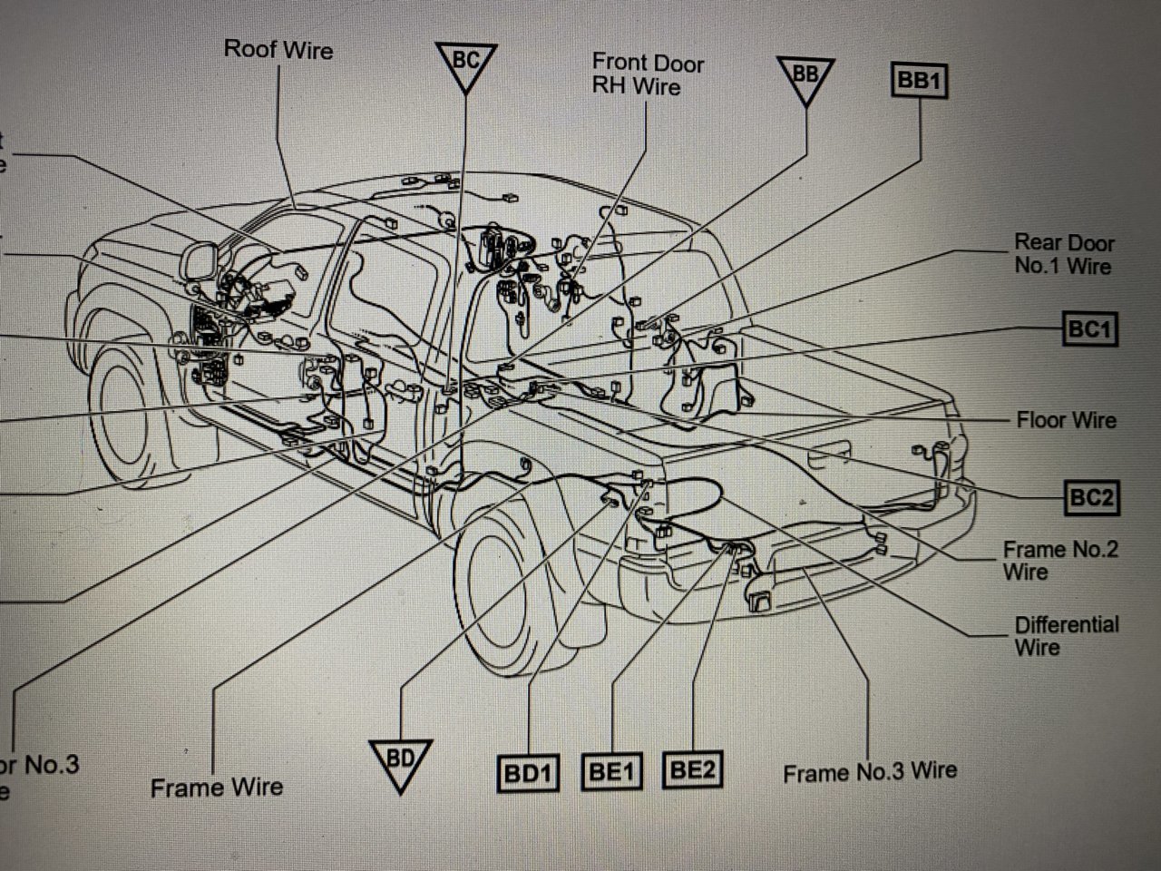

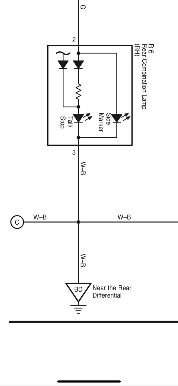

    The tail lights not working as well as the brake lights not working on both sides, indicate an issue with a ground which is common to both lamp circuits in the taillight as well as from passenger and driver side.
    check to see if your license plate lamps are also affected, as that shares ground at connector BD by the rear differential. Chances are, if you did something with the electrical system and now there’s an issue, it was something you did and as @Jimmyh suggested, go undo that. There are very few coincidences when it comes to these issues.
