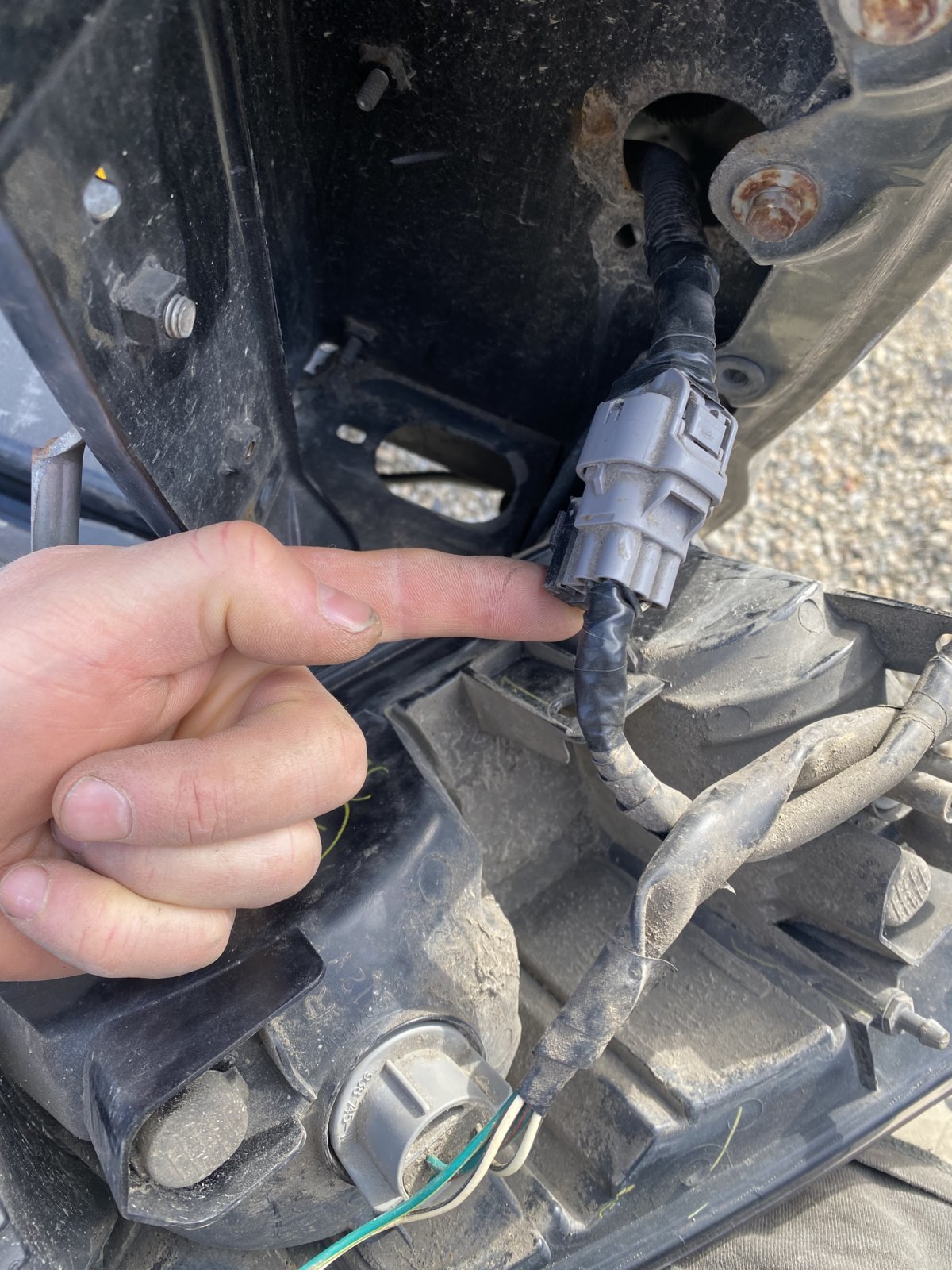

    Just got it sorted!
    OG symptoms were:
    -no running tail lights
    -no license plate lights
    - brake lights still worked
    Fix:
    -Changed fuse in cabin (was burnt)
    - now rear left running light worked, right still not working
    -pulled right light assembly
    -found broken wire
    -repaired wire , all working.

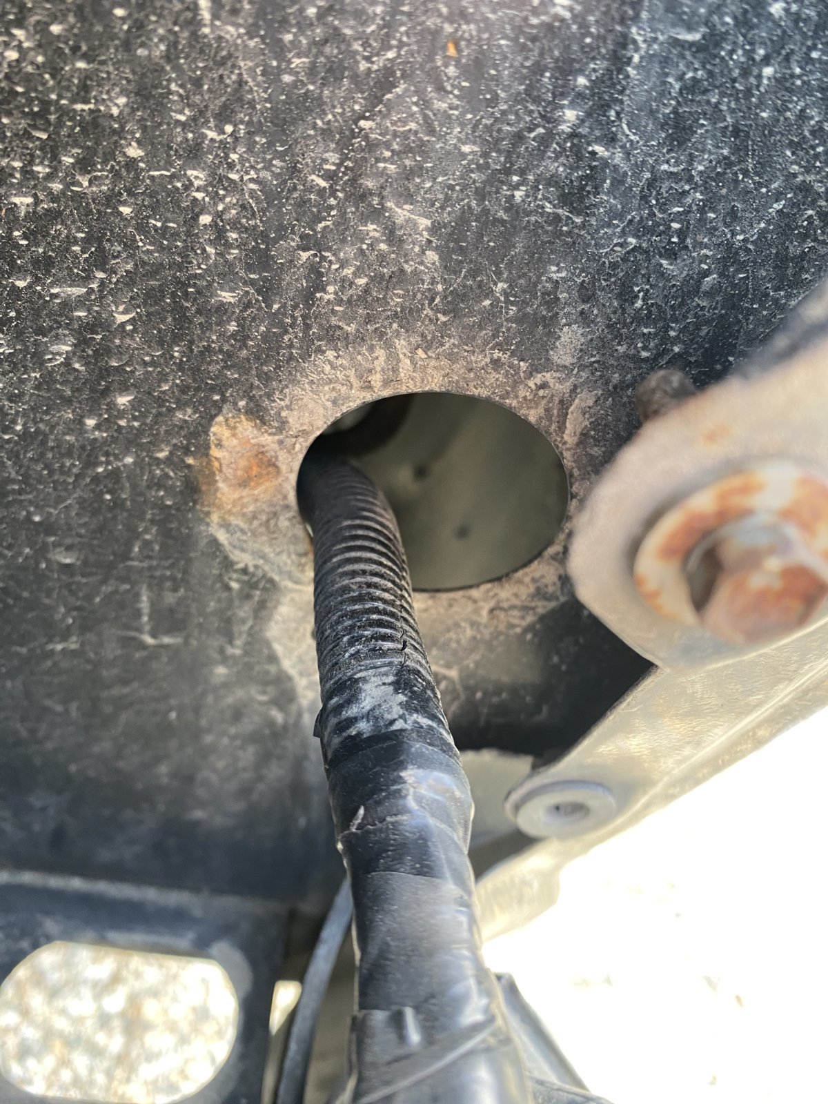

    *** Key note for others***
    The area where the wire broke was from rubbing on the frame where the wiring harness threads through a small hole in the frame and into the area where the taillight installs. (See attached photo) The harness is designed in such a way that I could see this being a weak link for others that wheel their truck and see lots of vibration.
    Hope this helps someone.
    Thanks TW
