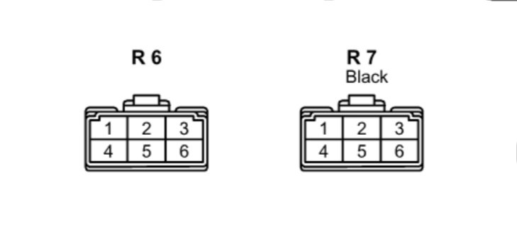

    The left side taillight feeds power to the right side taillight.
    See if you have power to to pin #2 (Green wire) on the right side (passenger) taillight.
    If not, it’s a bad LEFT side taillight, a bad wire from the left side taillight to the right side, or a poor connection at the left side taillight.

    Not necessarily, it could be the drives side taillight. Power goes in the drivers side taillight at pin #2 and out of pin# 6 to the the right side taillight.
    Does the passenger side license plate light work?
    It also gets power from the left taillight.

    You could unplug the the left (drivers) taillight and jump pins 2 & 6. (Green wires)
    If the right side works, it’s the left side taillight that is bad.

    It sounds like a bad RIGHT side light.
    You could remove the drives side light and jump the 2 pins (green wires).
    Then plug the drivers side light in to the passenger side. If the light works, then it’s a bad passenger side light.
