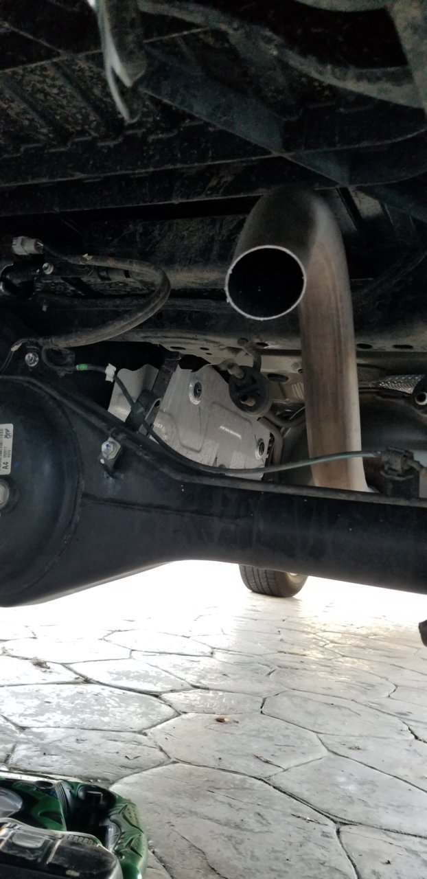

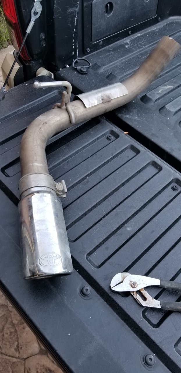

    Just did mine :headbang:20180526_184917.jpg 20180526_190131.jpg 20180526_184910.jpg

    I just want to throw this out there...
    I did a bunch of research before adding exhaust to my tundra and I read several posts of guys who actually got rid of some cab drone by chopping the tailpipe right behind the axle. Also said it made the exhaust note louder outside the truck(sound bouncing off ground I would guess)...
    I will be chopping mine when I get around to it...

    Cut tailpipe about 1-2” behind muffler and angled tailpipe with a 45 degree downward cut. So put noise directly below rear right seat. I sound deadened under back seat and drone is gone

    Just cut it and run a new tube out the side, no drone and good to go, I can do custom exhaust stuff like that, pretty much however you want it OP.
