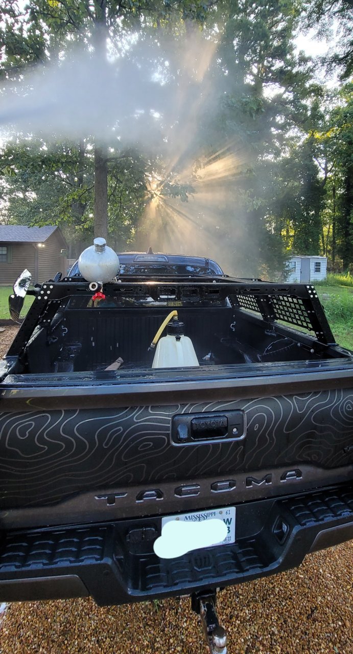

    A bunch of junk
    I saw some stuff I liked, bought it and stuck it on their. Amazon mostly

    is that.. a fog machine?

    I wish... just a pressure washer at sunrise

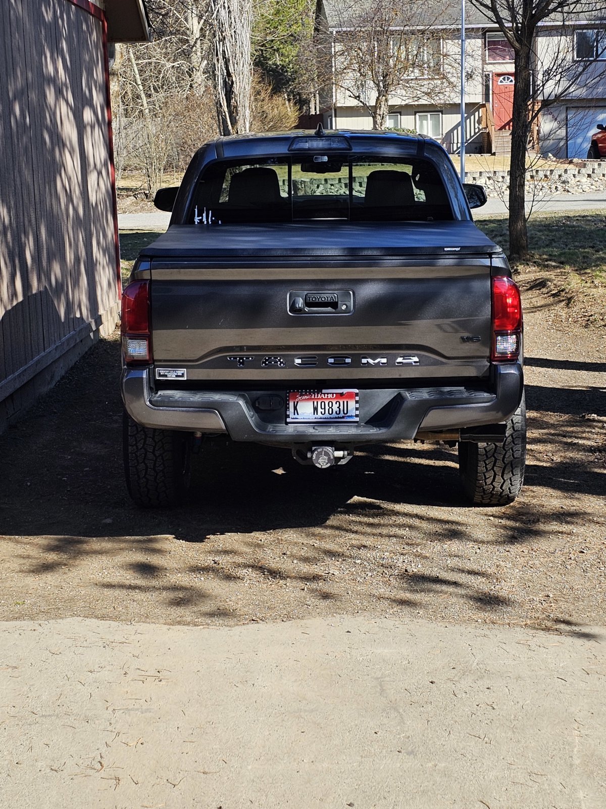

    I bought the ebay special. No issues with them.
    This biggest factor is prepping the surface.
    The key to making them stay on is as follows.
    1.) hand wash the inset area on the tailgate thoroughly with soap and water and a sponge.
    2.) rinse with cold water.
    3.) hand dry with multiple microfiber towels until completely dry. Let it air dry about ten minutes after hand drying.
    4.) Take a microfiber towel and wipe down the inset areas with rubbing alcohol or isopropyl alcohol.
    5.) let it air dry. Heat up the inset letters on the tailgate with a hair dryer or heat gun. Nothing crazy just make the surface warm.
    6.) remove backing off a letter. Take a cotton ball and submerse in paint thinner. Let it drip till it stops. Gently dab the sticky on the back of a letter with the cotton ball (this activates the sticky residue and makes the bond stronger between the sticky and the surface). Let it air dry a few seconds. Then apply the sticker to the corresponding inset letter. Firmly press it in and hold it for 45 seconds to a minute. Repeat until all letters are done.
    7.) holding the heat gun about 6-8" away from the surface, gently go over the letters and warm them up. No need to get them hot. Just warm. This ensures the sticky will bond to the surface.
    They won't come off or fall off.
    In the event you need to take them off, use a heat gun and fishing line. Take your time so as not to pull the paint off. Once you're done removing them, heat up any residue and remove with your finger (don't use your fingernails), then clean with rubbing alcohol, wash with warm soapy water and a sponge, dry with microfiber towels and buff and polish as needed.

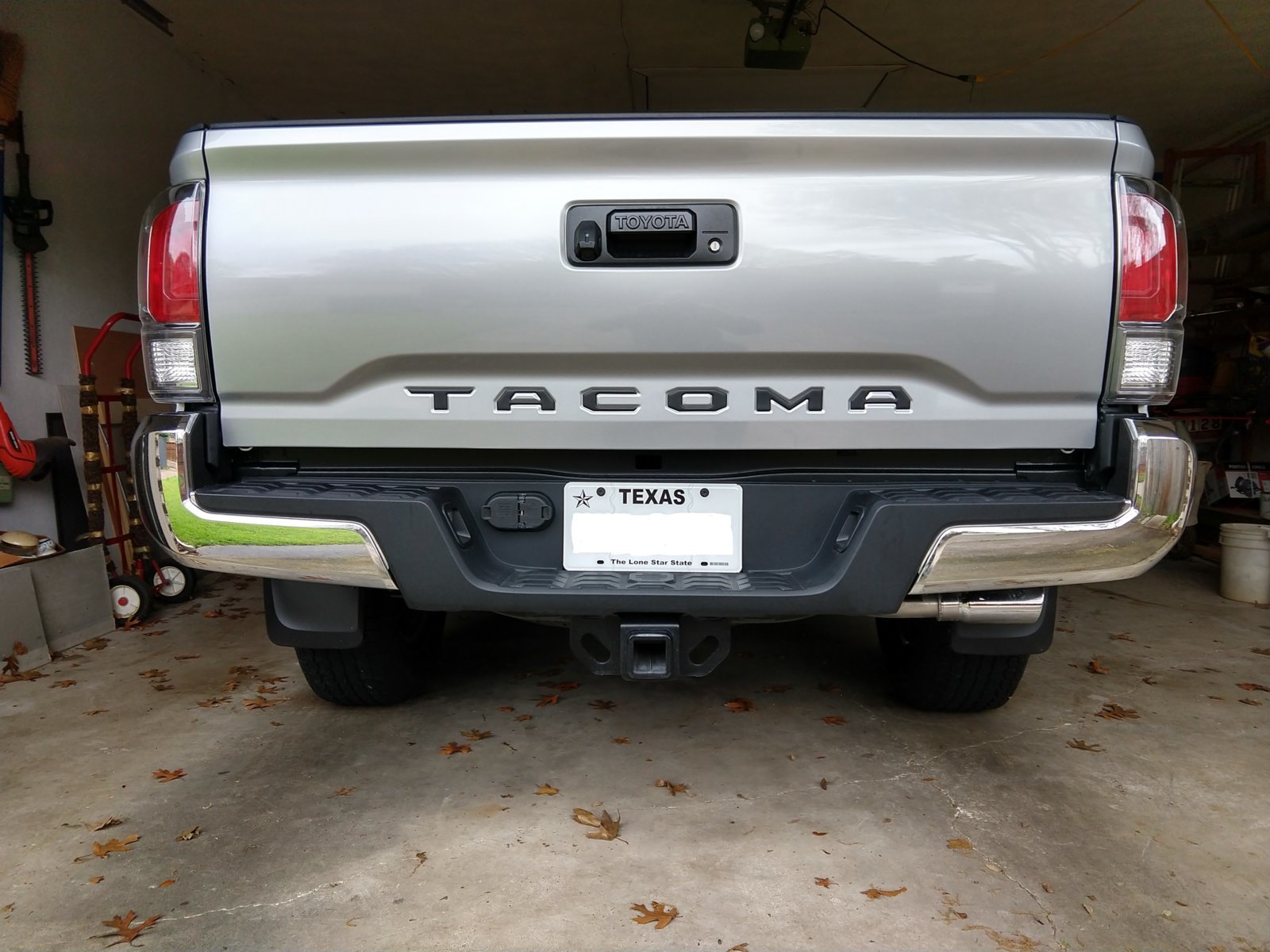

    OEM - I'm happy with them.

    Same, bought OEM, look great after 2 years in GA sun.

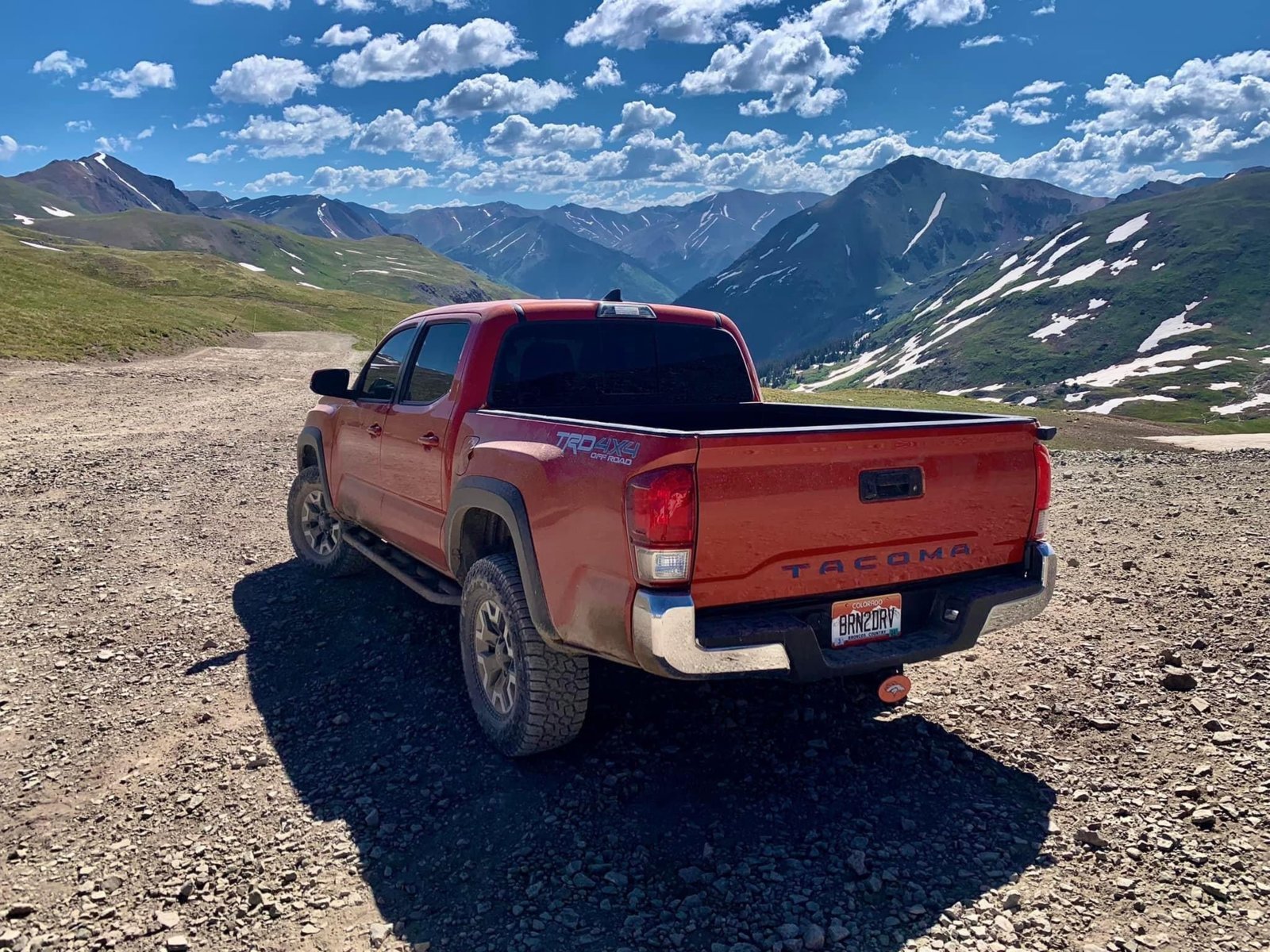

    Where's the truck??? All I see is mountains :drool::drool::drool:
