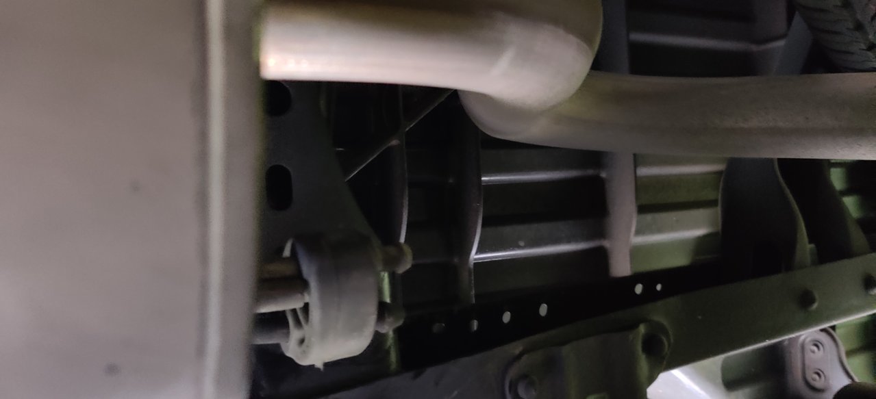

    I need to get mine done before sun down and in not sure where the cable is to be tied to. The video I found says follow the body harness back but I can't see any wires on the passenger side under the truck to follow. Do I zip tie to the frame?

    This video shows how to run along at 8 min 10 sec. https://youtu.be/Ejq_Y6OjakE

    I see it in the video but i don't have any wire harness on that side i been looking for it.

    I would follow along the frame as shown and zip tie it where you can in that location.

    It’s odd I think it’s the power outlet that runs in that location from the rear.

    Lots of zip ties. I didn’t use them all, but used enough and made sure the wires were secure.
    Just get the wires secured where they are above the frame and protected from branches, tall grass, etc etc. my harness was on the passenger side, but if it wasn’t I still would have ran the wires in the same spot.

    Sr5 does not have the power outlet so that there explains why I didn't have the wire harness videos said was there. Those people all had TRD.
    At any rate I got it up there and out of the way of anything moving or where it can catch on anything. I mostly kept it in the upper edge of the frame till i was past the rear wheel and muffler, then over top the tire carrier frame to where it meets the other harness. I'm not pleased with how a few of the metal straps aren't on to hold it down firm. I was having a lot of trouble working with them by hand because my truck was all fluid filmed last fall. Greasy hands and those don't mix so much.
    I'm going to let it be for now maybe try to by some of them metal straps at the auto parts store. Redo and add a few. Taking the spare down I think will provide more room to work.
    The lock works good I'm happy now that my tailgate or stuff in the bed is more secure.

    Meh, you don’t need all those metal ties. That wiring isn’t going to go anywhere. You could probably use four plastic zip ties the entire run and it would be fine for the life of the truck or actuator. As long as it’s out of the way it will be fine. I love it. I rarely lock my topper, but it’s nice having it halfway locked all the time. A thief would be in a pretty compromising position crawling into the bed of my truck to check the bag and locked/secured gear trunk in the bed behind the cab lol. I don’t think many would want to climb-in to even look.

    @Tacoma091919 I have one of those metal straps left. Maybe I will try to get it in there good later. I really don't think it's going anywhere. And I will cut the one i cant get tight so it's not rattling around.
