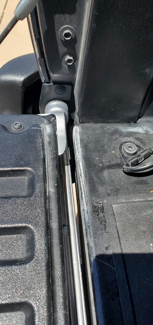

    Any updates on this? Mine seems to be getting worse and now it's present on passenger side as well. I'm worried it'll continue to self clearance until there is a hole in the edge of the bed liner

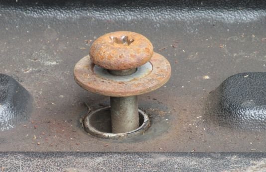

    Edit: I've been researching options to adjust the composite bed forward, it looks like there's plenty of adjustment around the bolts based on this photo I found.
    I wonder if over time our beds are simply sliding backwards and bottoming out on the edge of these sleeves or if they weren't alinged from the factory. One solution would be to replace the sleeve with one that has a smaller ID, preventing less bed travel. I'm going to pop a few of my bolts out and check them.
