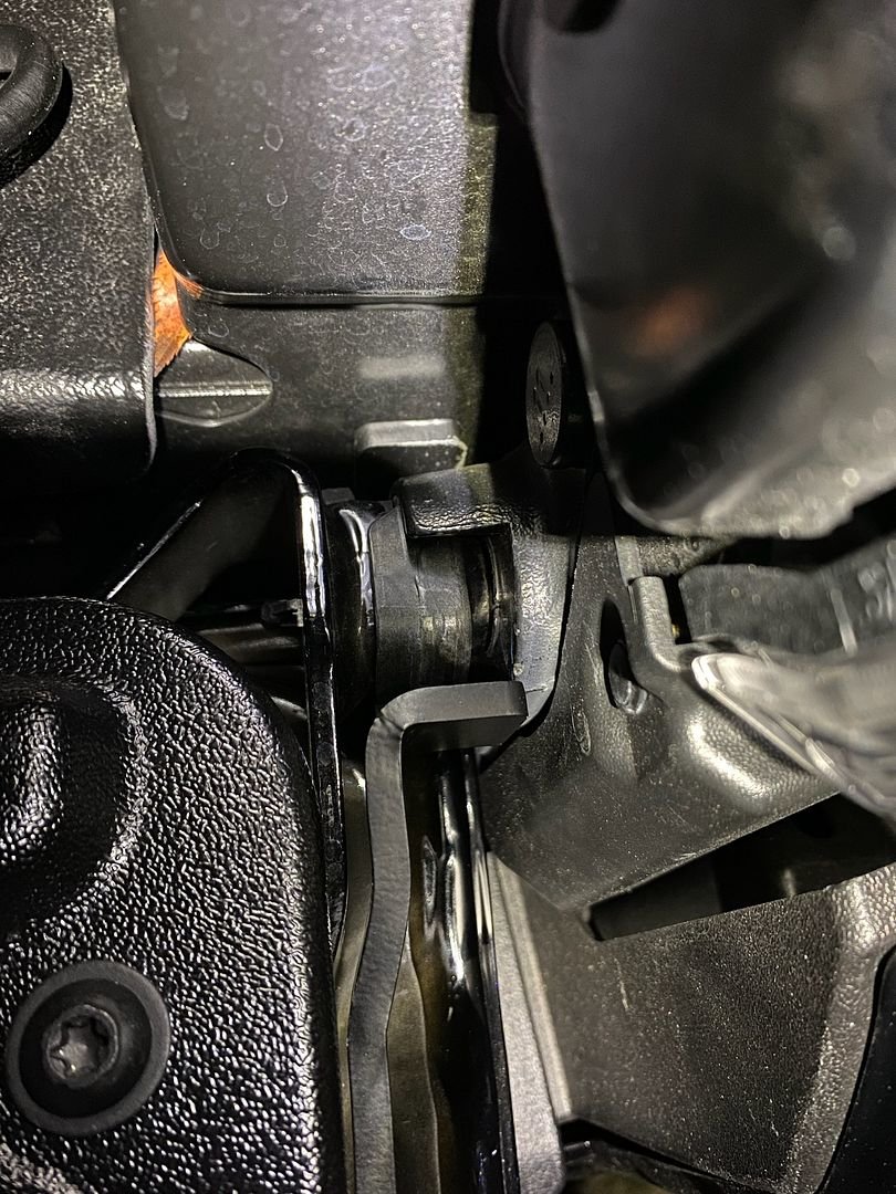

    Just got mine installed. Should be a good deterrent. Thanks Chris!

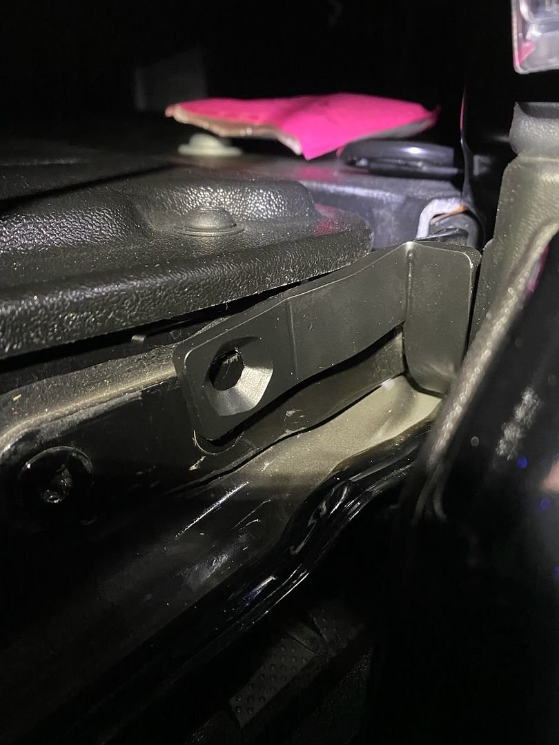

    Got mine last week! Install coming up! Thank you for the quick shipment!

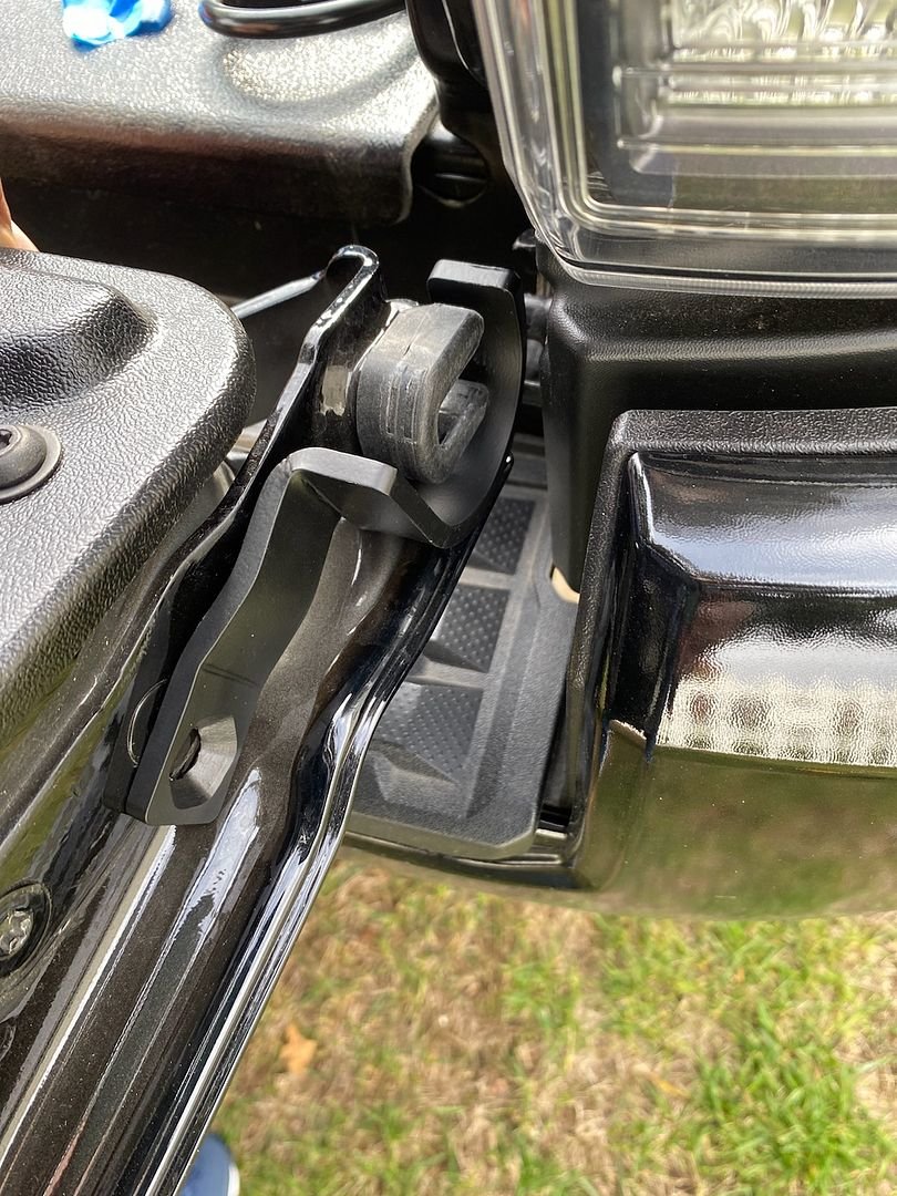

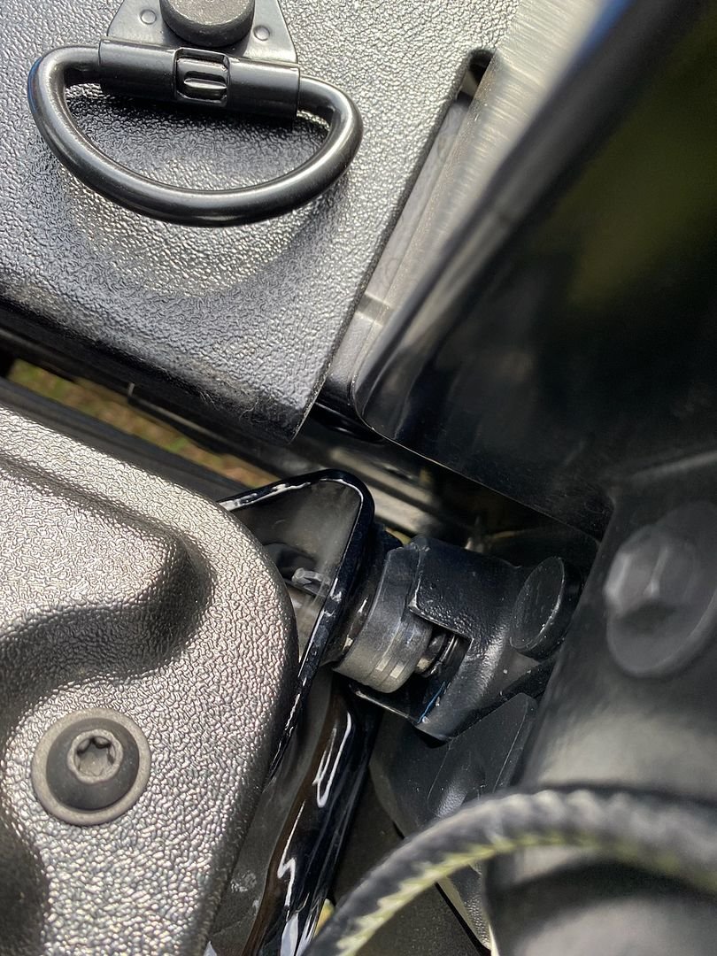

    How did you get yours on?
    Do you have a 2021 TRD OR?
    Here are some pics of mine without removing the bolt to attach the clamp. Just by looking at it, how did you finagle the clamp in there?
    Looking at this, I would say bolting it on and then trying to install it with that "U" opening on the tailgate...did not work for me.
    Top view showing the entrance being blocked.

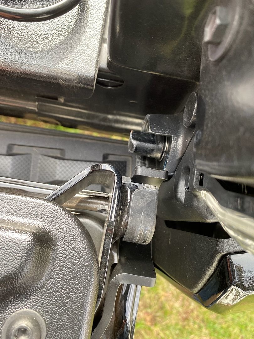

    As it sits with gate down.

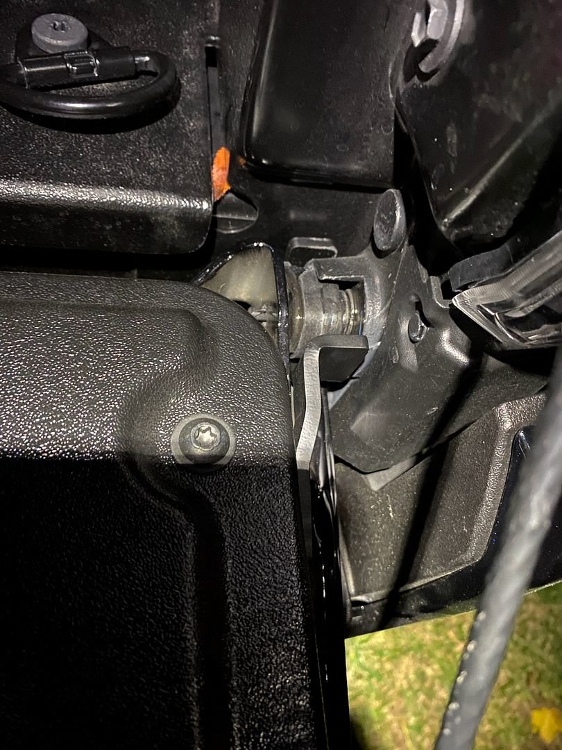

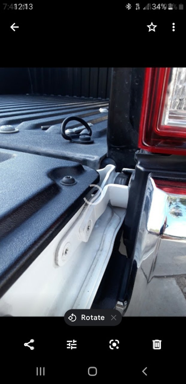

    Now, I saw this photo from post# 594 on this thread but wondered how did it get installed that way?
    It's like the clamp was put under the post then bolted on afterwards. That seems awkward.

    It goes on after you put your tailgate back on, then slip device on,
    PM me and I'll give you my number and walk you through it, I must say that it's a first, installed that way, lol. It's really not that hard.

    I'll try again tomorrow. It seemed awkward because I don't wanna drop the tailgate simply because I don't know the process.
    The clamp goes on first under the post... then then the gate goes on. Then the bolt can be tightened after the clamp is in place.
    But the original bolt needs to be removed prior to so the new bolt can be screwed in.

    Step 1. Take your tailgate off and loosen the lower. T40 screw.
    Step 2. Put your tailgate on, and in the down position.
    Step 3. Slip the Anti theft device on
    Step 4. Remove the lower T40 screw
    Step 5. Align the ATD hole and put the tamper proof screw or OEM screw back in and tighten
