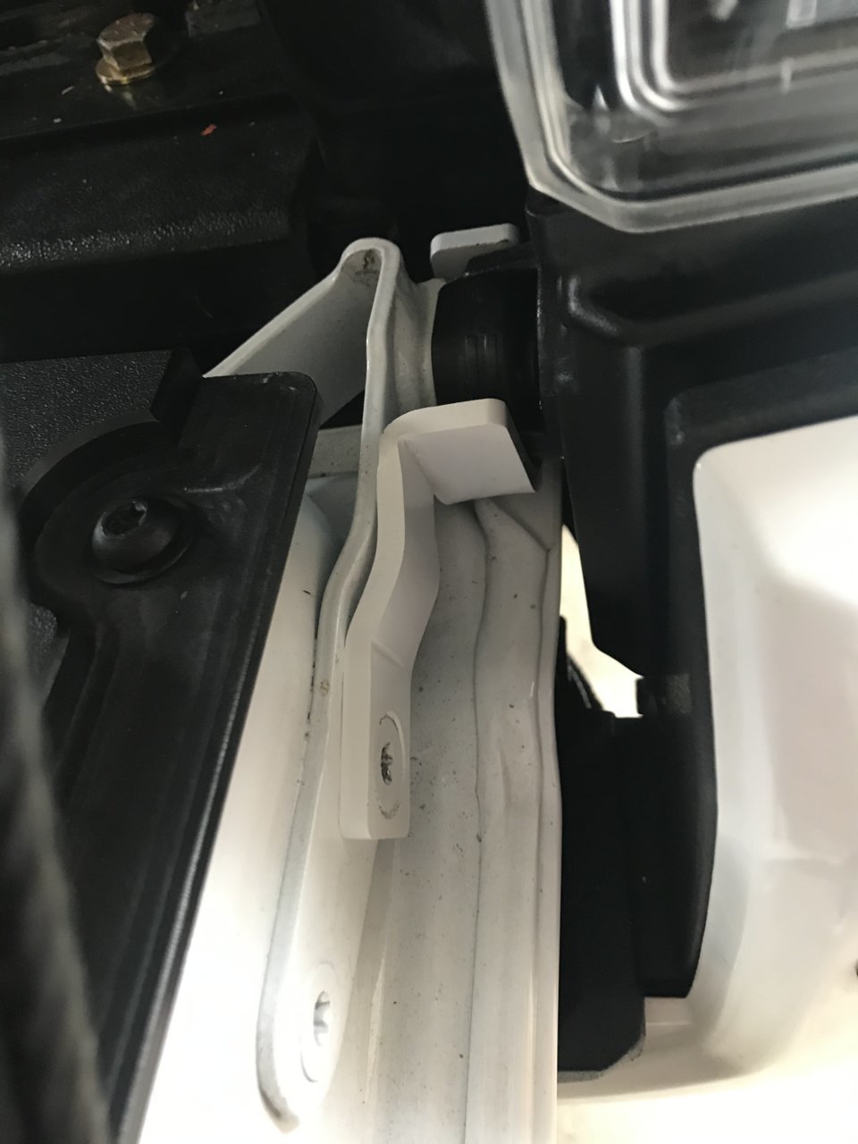

    My tailgate is safe now!! The slow turn with breaker bar after a few hits with a punch seemed to make it break free.
    I zip tied the TG to my bed stiffeners and it was a perfect height to get to the T40.
    It was my Christmas Miracle install after reading all the difficulty with the screw removal.
